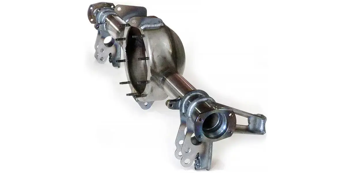

9 inch rear end housings are produced to bolt into multiple cars by many different manufacturers which would modernize his truck and make life simpler to work and repair.. I do not believe I have seen any companies doing this with 8.8 housings? My suggestion was not for his mustang or for a high HP rating..
Check out Currie, Quick Performance, Speedway, and Dutchman.....

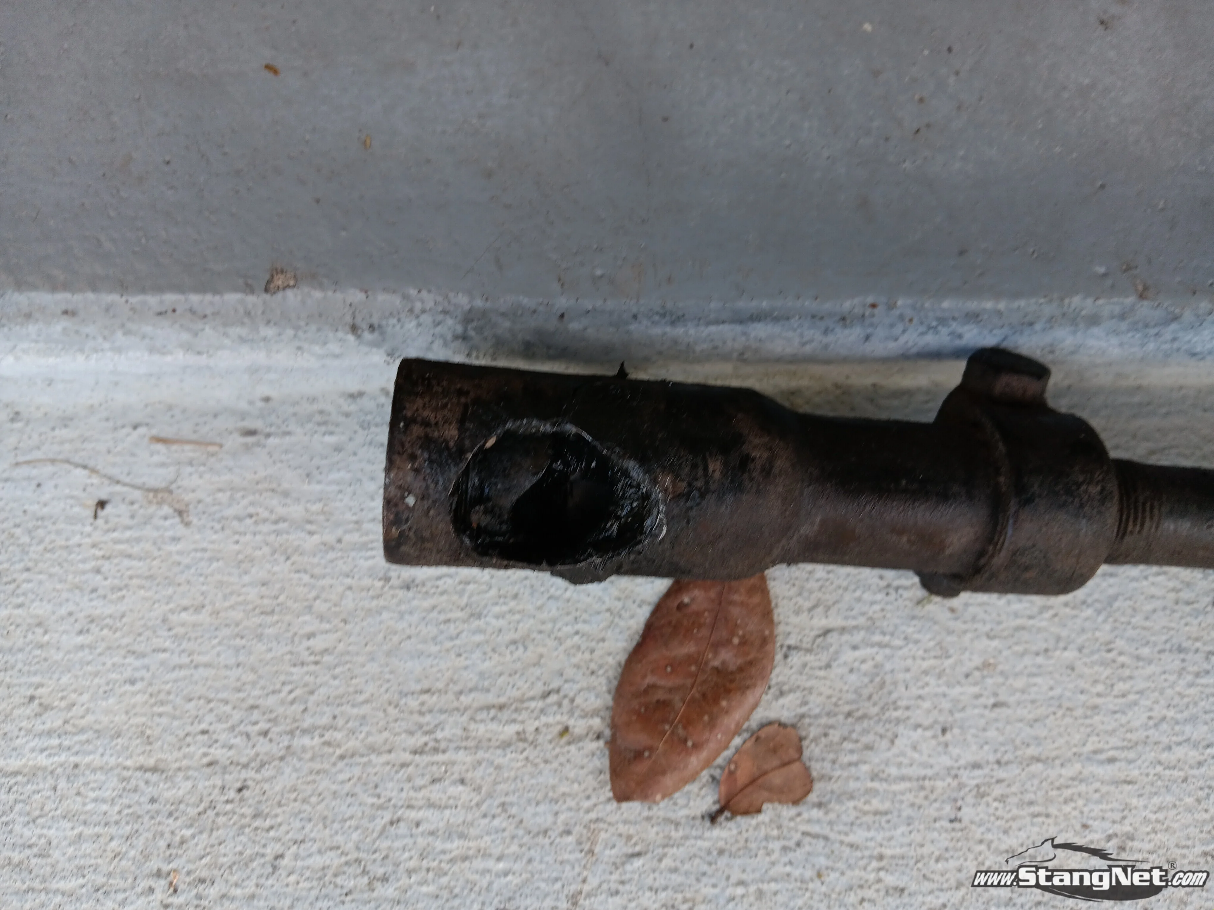

I went ahead and ordered tie rod and ends to replace an obviously bent tie rod, it's not really a direct bolt on, the ends are the newer style because parts for the old style are not available, I say parts because there is 5 pieces to the old style,
To make the swap to have to remove the ball stud from the arm that bolts to the spindle, a quick trip to the machine shop and that's done, cleaned and bolted back on.
A few measurements and first attempt to screw on an end and not happening :( I was careful to match the right and left threads, I even tried to spread one open a little, soooo, a call to LMC customer service and after explaining in detail the issue to two different reps the nice lady said they would pull the parts and check, assemble the parts and send me the stuff put together. Ok.
Not OK, two days later she called say'n one end is on back order so they will revisit this in about 3 weeks. What?? Well what could I do.
Reactions: RaggedGT
After thinking about it for the day I call them back, can you have your people pull the two parts you do have and see if the end will screw on then I can make a decision on what to do? She said 'sure, I'll call you back'.
A couple days later she called say'n the part screws on just fine, you just have to spread open the part and it screws on fine.
The threads inside the tie rod end are flat, not peaked like the thread on a nut or bolt so it's gonna take a lot of force to turn the rod for adjustment. I had asked her about the threads and was told the manufacturer told them that's the way they are made. RIGHT! Now I know where my headache came from. FALLING OFF THAT FUK'N TURNUP TRUCK!
This is Polk county. They make things work here so off to the machine shop I go. First stop no joy, didn't have a tap big enough but they pointed me to another not far away. I pull up and I've been here before, guy my age with a yard full of machinery older than he is. He didn't have a tap that size, it's a bastard size, he could order one but it's pricey and likely never to be used again. CRAP!!
He says 'sit down, let me try something'. I told him to go ahead if it don't work I'll just chuck this crap in your scrap pile and I'll start over. He put the tie rod in a lathe that was made in WWll and
20 minutes or so later he had it working as intended. :banana:
