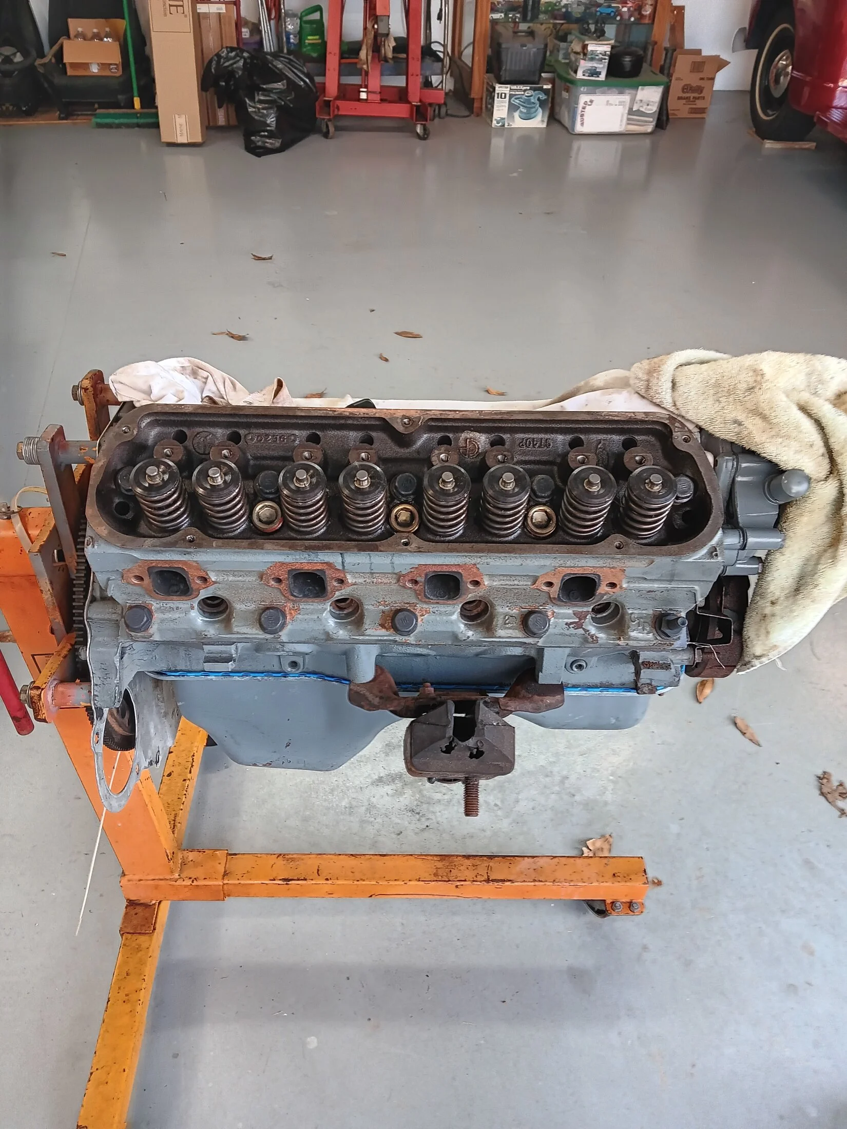

Got the short block cleaned up a little, paint still good on it, did some touch up on the hot lube container along the bolt holes, then jizzed up the corners and stuck the gasket on, laid the container in place and got about half the bolts started when I realized I failed to use the rail that goes along the bolt holes in the pan :doh: after that snafu I torqued the bolts the required lb/ft called for, I did apply some lock tight to the threads, don't want any falling out.
Now for pics
Now it's leak free (?) and ready for heads :nice:
Yes, since it's out and on the spinning engine holder on wheels, it would be wrong not to.
Let's get an update, got one head mounted and discovered my 'clicker ' torque wrench wasn't clicking every time so jumped on the google horse and found a Craftsman 1\2" drive ' clicker' at Lowe's for a paltry $65 that locks the adjusting wheelie handle, a a must have, only to realize that ALL of them are that way now, man got spoiled having an entire mechanic shop full of every tool needed, drove down there only to find the Craftsman was over $200 :mad: so I bought a Kobalt for $96. Maybe I didn't read the listing correctly, temporary dyslexia ? Is there such a thing? I needed one and it was inexpensive, now to check those head bolts, I used Mahle bolts and just happened to pickup a piece of paper that gave info for installing them, I already used my magic book to confirm torque numbers (65-72lbft) and sequence, done enough to know but smart enough to confirm, well the paper instructions said 85-95 lbft :doh: the old 'clicker' was waaayyyy off, they are all set now at at least 90 lbft. I feel much better now.

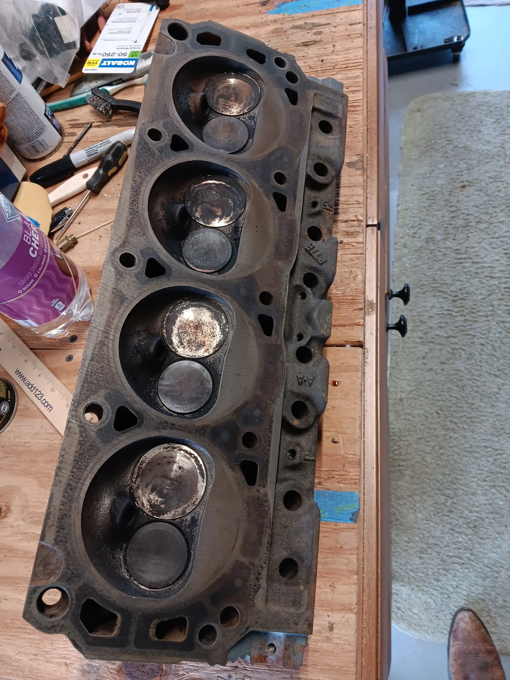

on to cleaning up the other head, not that it is filthy or carboned up, a little background on these GT40Ps, bought new in early 2000, installed on a rebuilt 5.0 block, stuck what was supposed to be an E cam, which turned out to be a B, stuck it in the 'Junk Pyle' and it ran great from 3500 rpms and up, under that it was like driving hell, idled good, down right sexy in fact, but had this buzzing sewing machine that I knew was not right, all this before my :SN:days, in frustration I yanked that engine out and stuck this one in, so these heads have just a few miles, maybe a hundred or so. I eventually pulled the heads and found that I had a block/pistons from a crown vic, the valves were just touching the top of the pistons, no damage luckily, just a witness mark on every piston.
Keeping the stock HO cam this time, lesson learned.

Some pics for........ well because none of ya'll have ever seen what a GT40p head before.

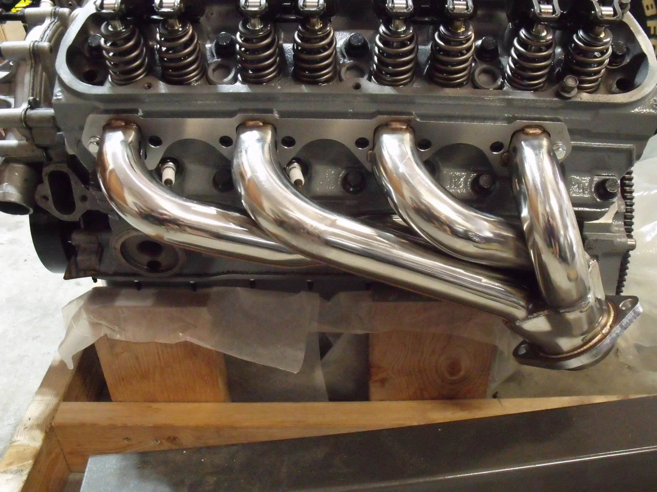

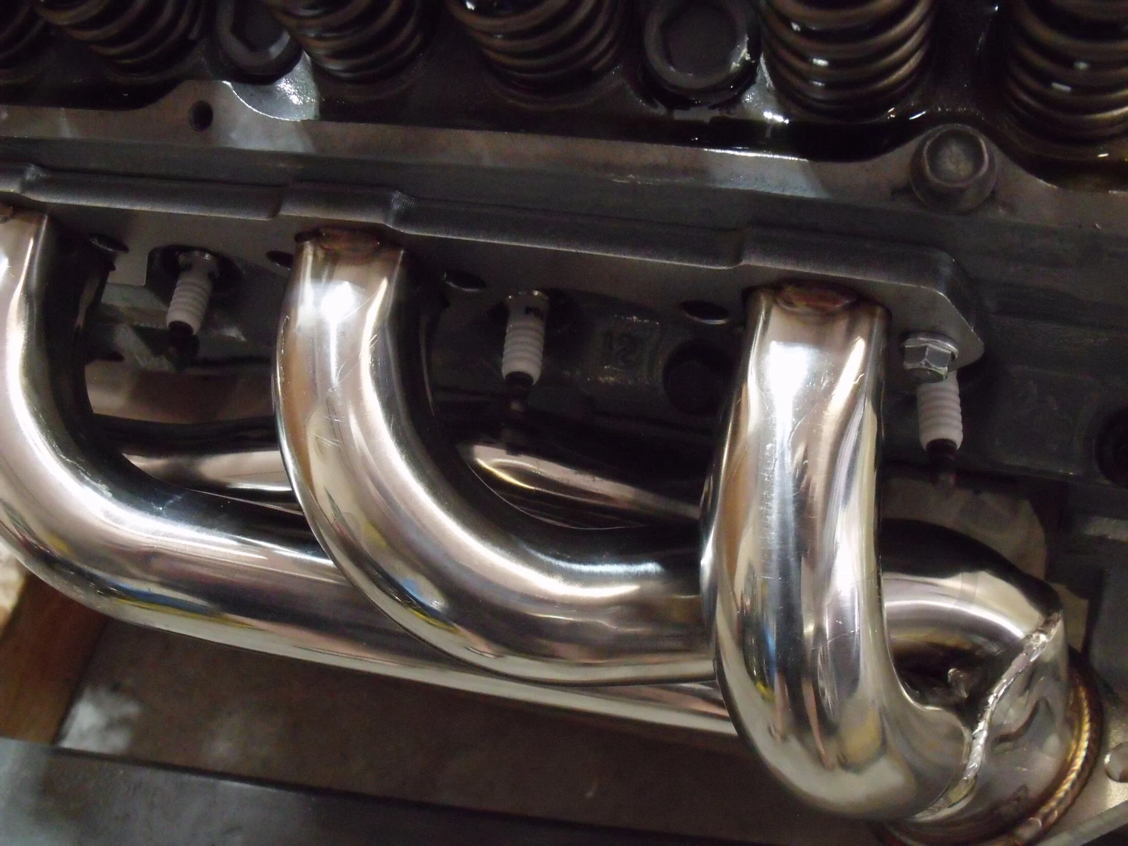

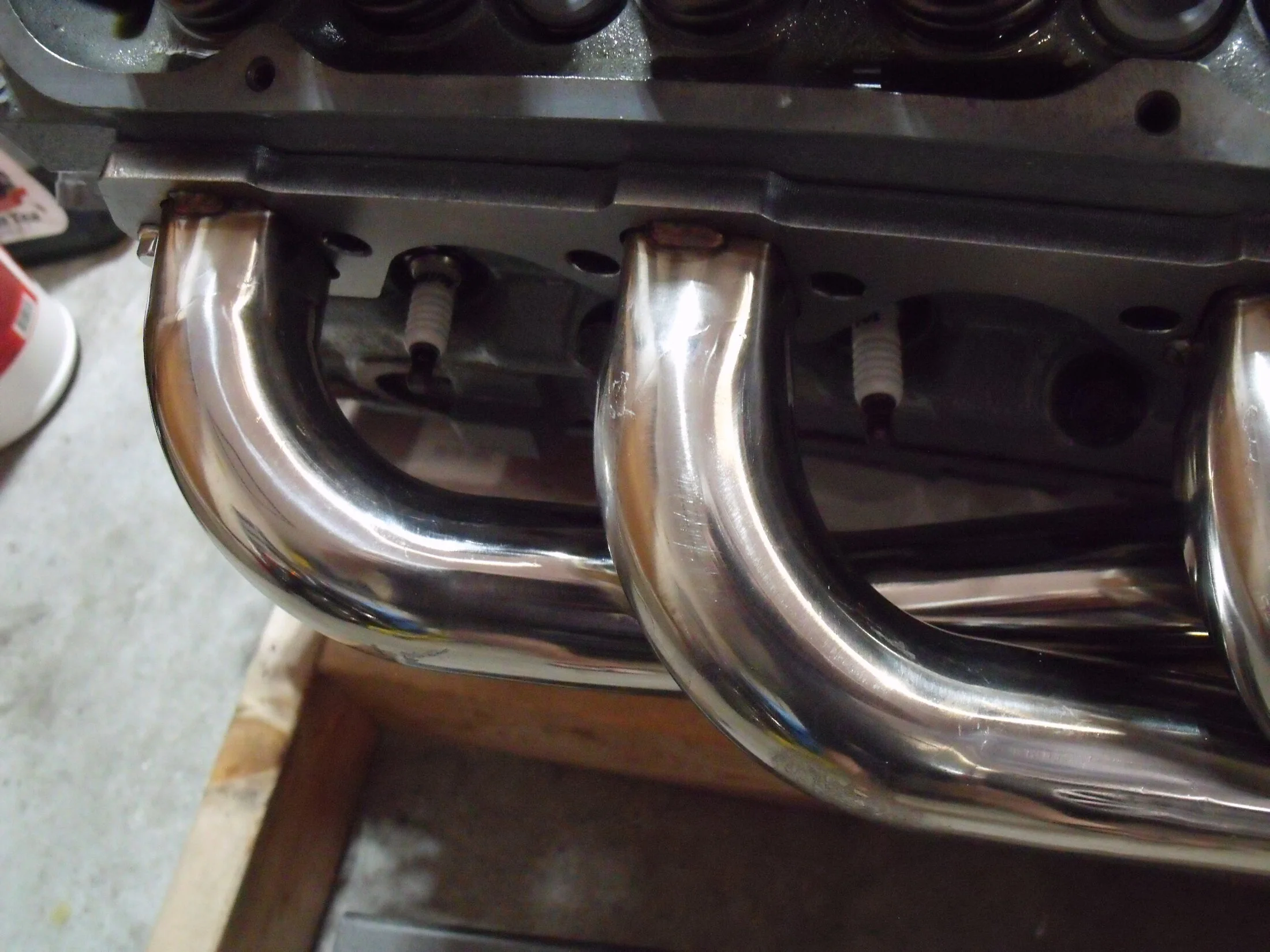

I will say that while I've got it out Iam gonna address the burnt plug wire issues I, and others have encountered. It may involve the bashing of header tubes so beware :eek:
Nice, what valves are you running in those heads? I got a stock 1990 h.o. block that i intend to do a tfs stage 1 cam and gt40p's in as well. Got any pics of the header mounted up?
No pics yet, near as I can tell no issues with the passenger side header but will check again. I'll post pics when I test mount them with the engine on the whirly gig on wheels.
