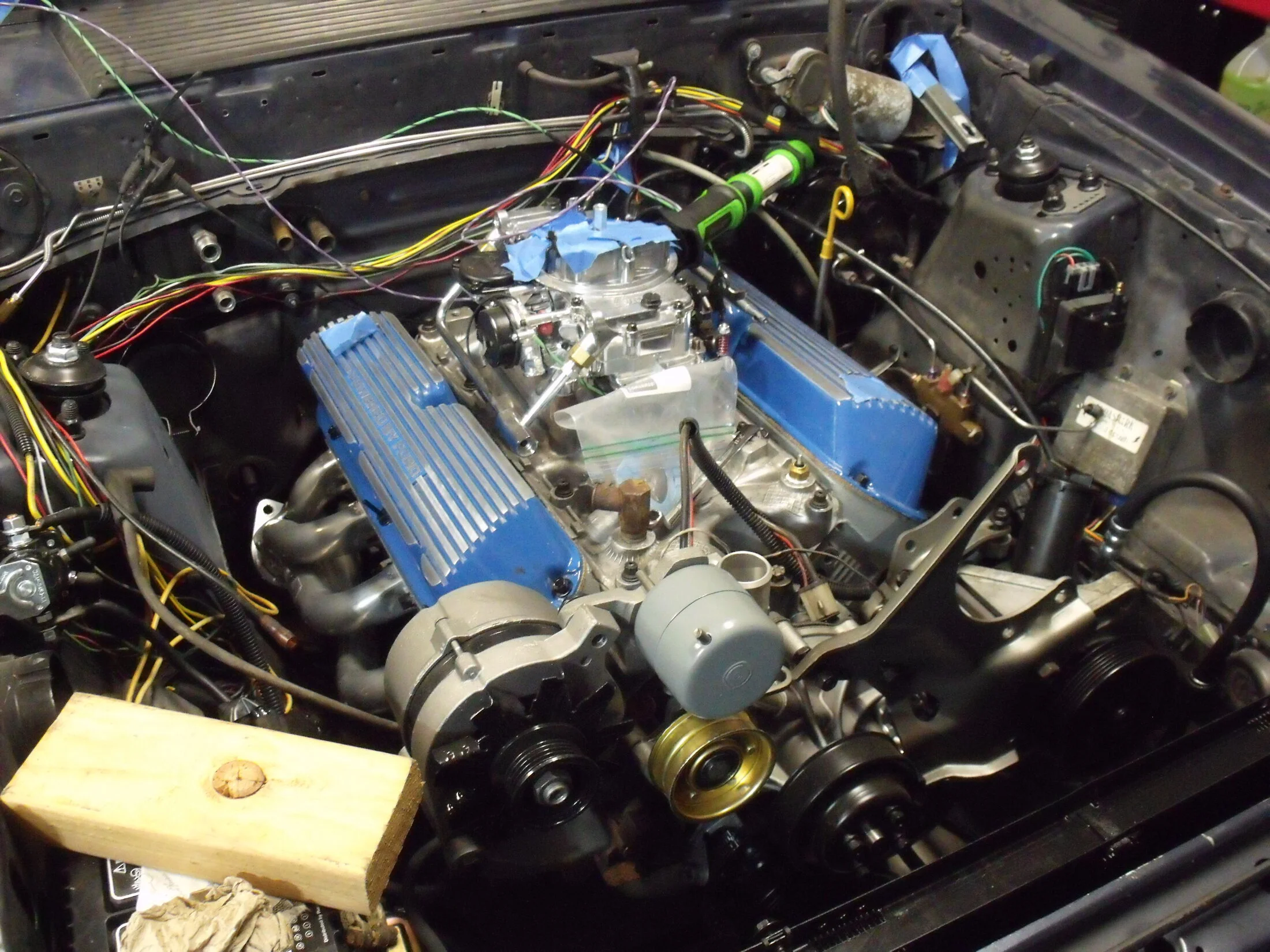

A few things done, I have a Roadkill approved list I'll post with the pics that may or may not interest the two or three that may still be following.

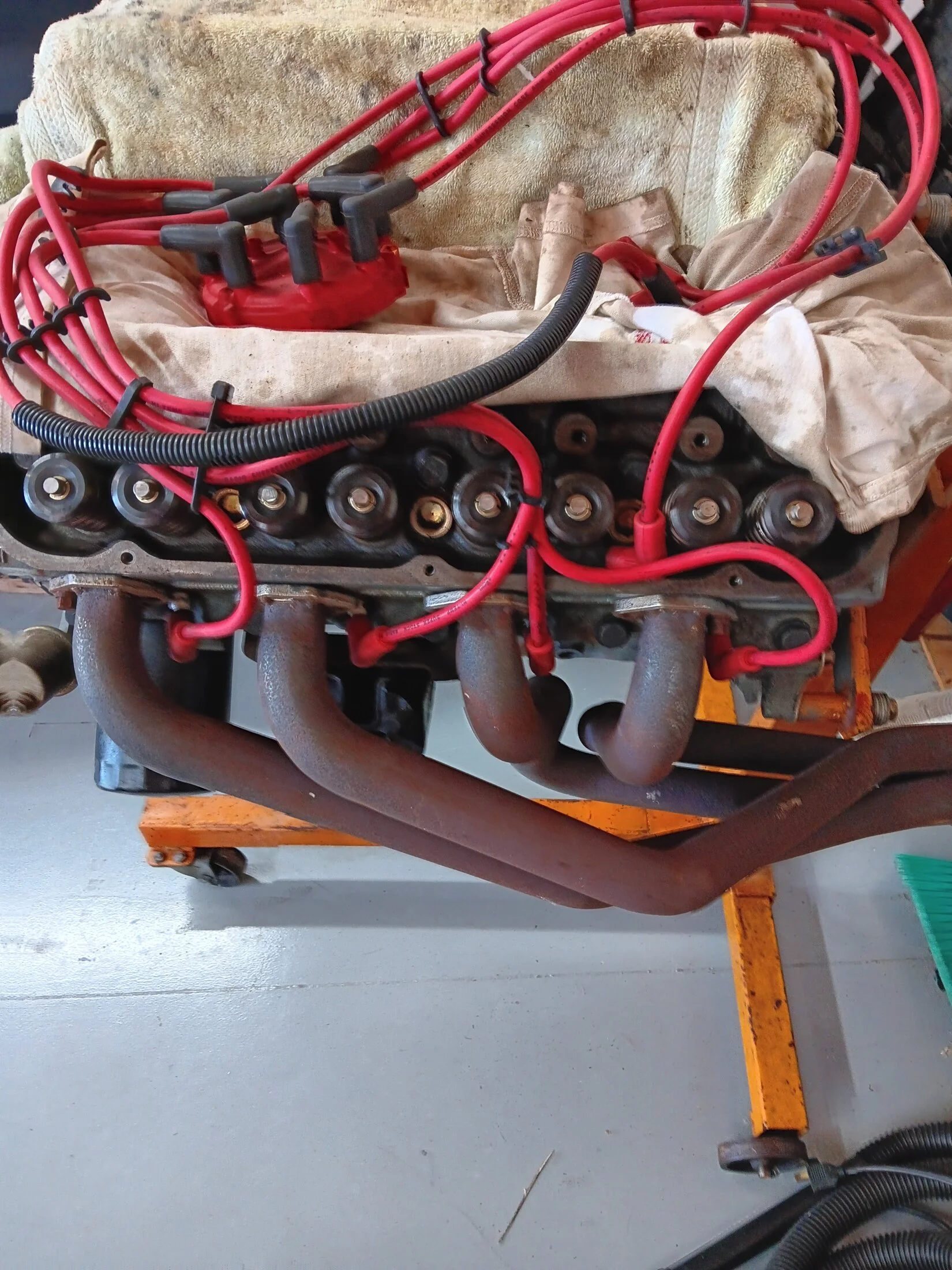

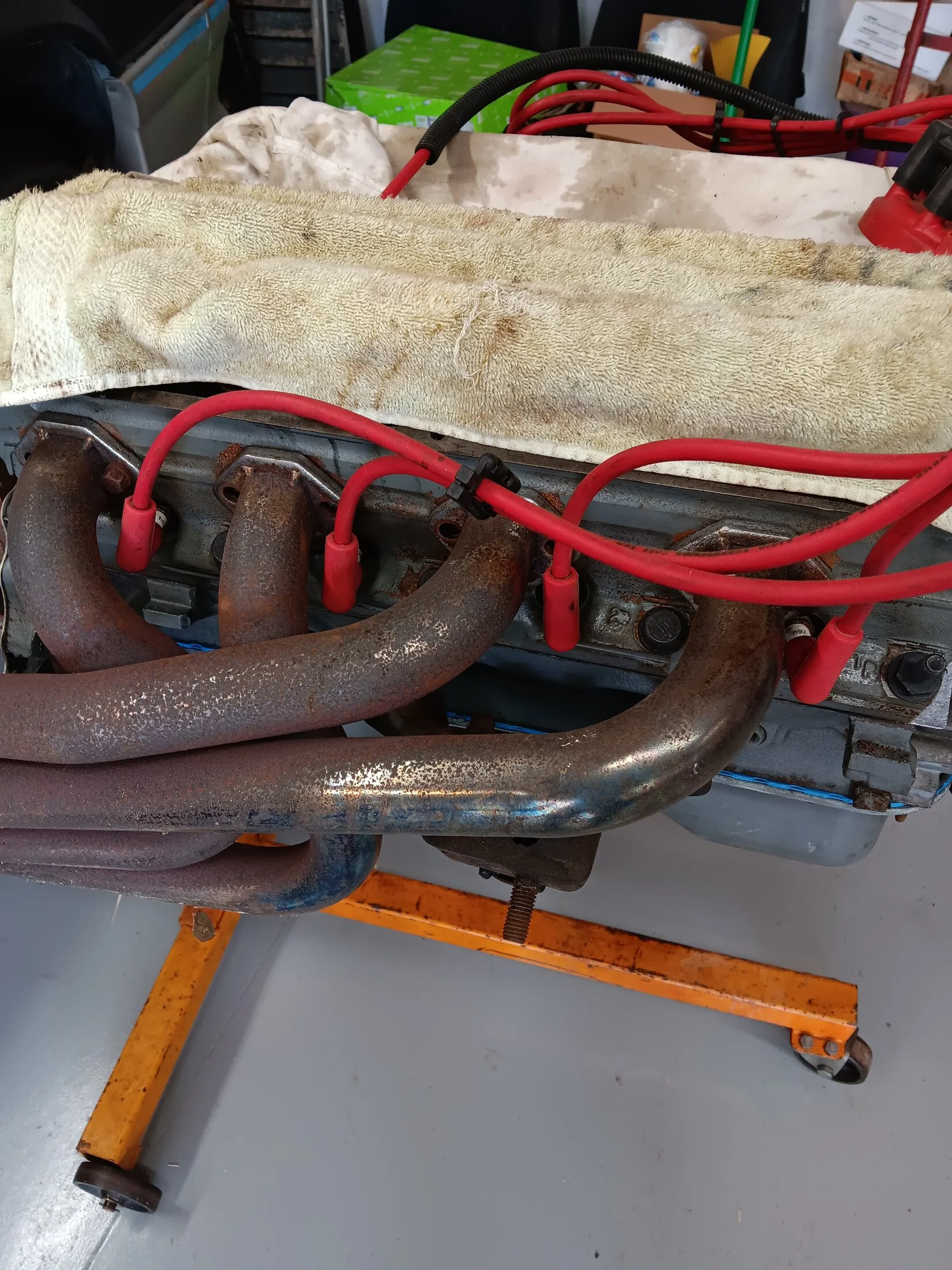

Heads on, oil pan gasket, checked the header to plug/plug wire clearance, I think, as you'll see in the pics, with the angled boots there should be room, I will add plug boot condoms for added piece of mind, and the look 'race car' cool.
Got a bit of a surprise when I dug the cap and wires from the pile of parts I removed, Accel plug wires???? :O_o: I know they used to be about the only thing you could get 'back in the day' and actually were good products, I've bashed their coils for years, oh well, time will tell how long they stay, they are red, I would prefer black, I will stick to 8mm wires although they are not needed cept for some extra heat protection.

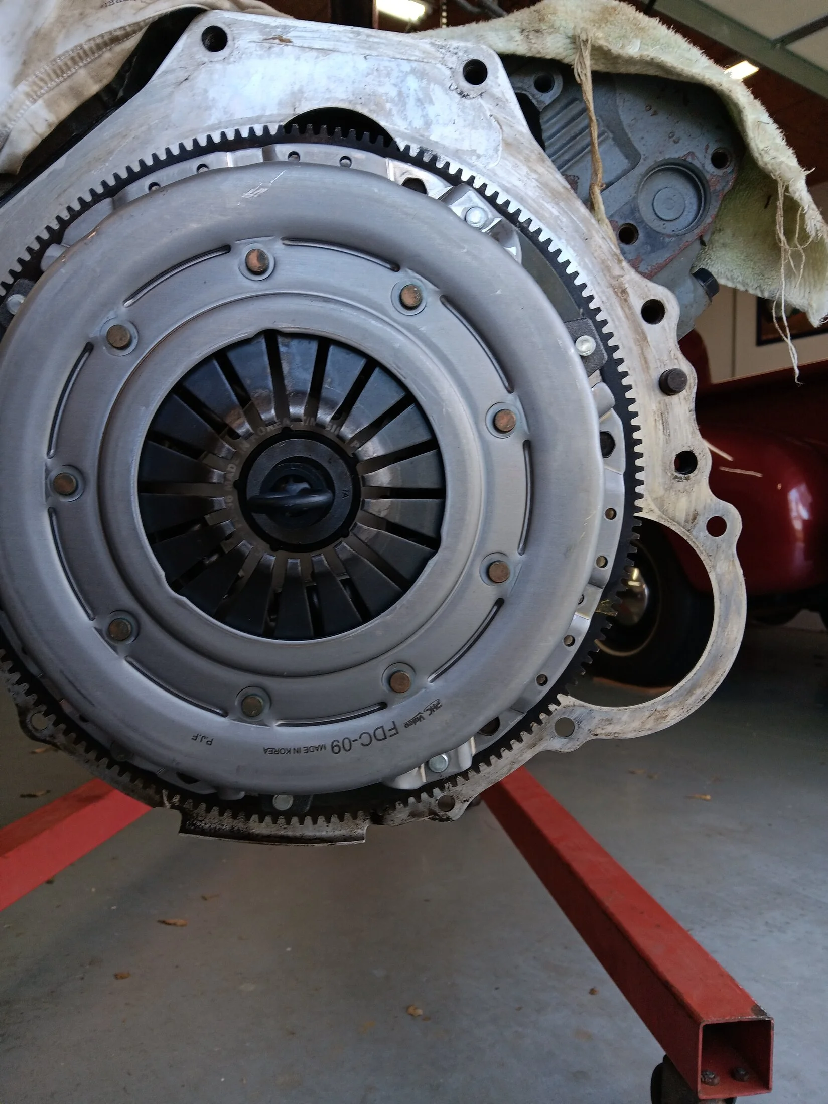

Well, not a real good day today, first got everything cleaned up ready for assembly and only 5 pressure plate bolts :eek: looked for that bolt everywhere 'cept where it's hiding at, you'd think with the containers of mustang related 'stuff' I would have ONE! Nope! A couple were close but nope. Nothing local so I found some Ford Racing clutch bolts on Amazon, go figure, be here Sunday, 22 bucks, so I put everything away and ventured into the home office to load the pics into the big screen, a-n-d the computer and the fone no talkie to each other, plugged directly in....... charging ........... Tried different plug, nope :mad:..... charging........ that's it.

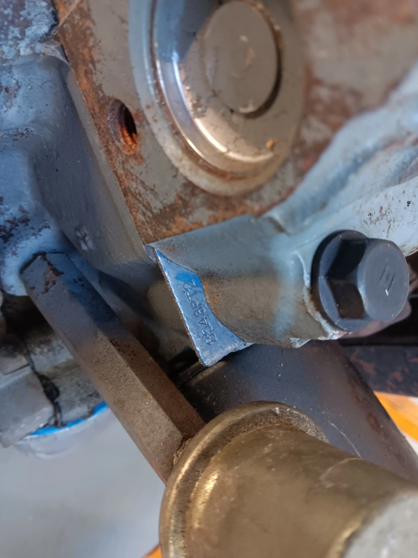

first lets show a something I discovered installing head gaskets and head, this is an observation now, look behind the sending unit, see that part of the gasket sticking out? that is on both sides, so if there is any question like 'are my head gaskets on right?' all ya gotta do is look for the gasket sticking out at the front. I feel like a pioneer! never heard of anyone observing this, OK, now I know somebody else knew about this and, with a scrunched up face, are say'n 'he didn't know about this?

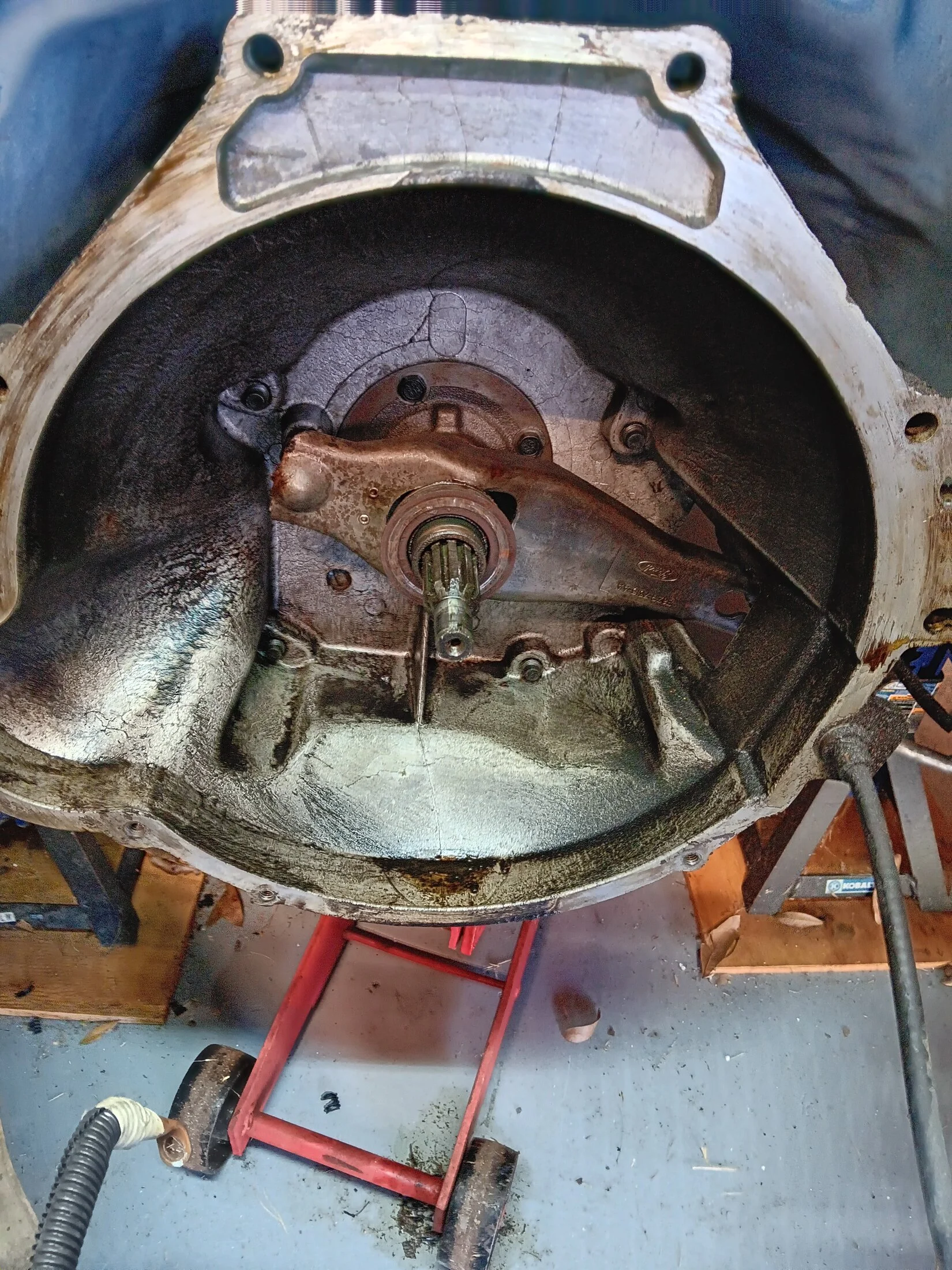

Looks worse in person, gotta clean that up a little and swap that TOB.

some plug boot condoms and this will be OK. Kinda crusty look'n I know.

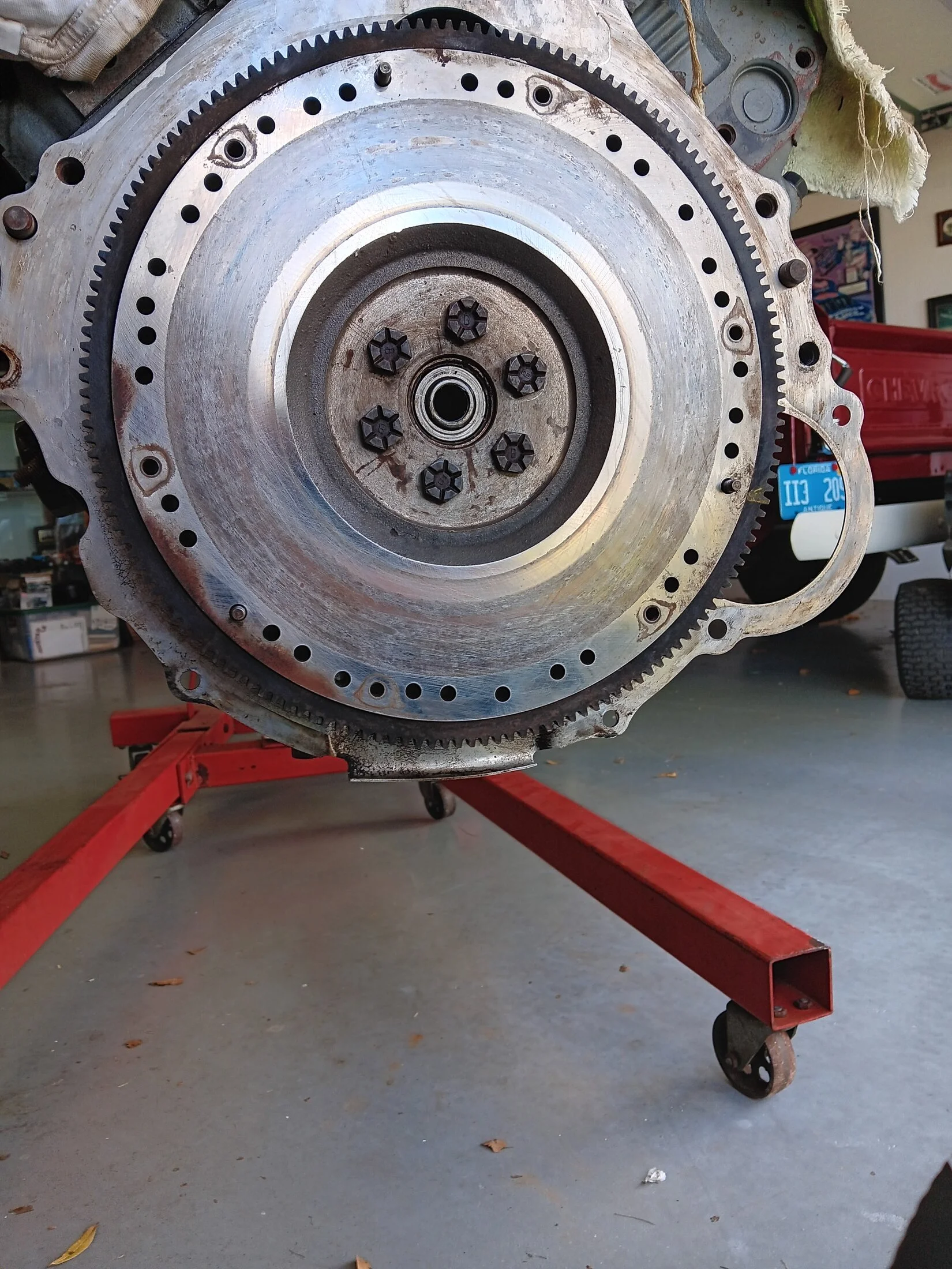

I cleaned up the flywheel and added a smidge of grease to the pilot bearing, got the bolts cleaned up and some 'locktite' on them, wait only five bolts? Now the hunt was on! I know there were six, I put them all in the same tray but i now have an escapee! looked every where it was not, searched for a suitable replacement, a couple close calls but no joy. :doh: found some Ford Racing bolts on Amazon (of all places) so this is where I wait, be here today (Sunday).
clean and a scuff, good to go.
soon as the bolts get here I'll be ready to torque this down and attempt to install the engine back in it's home, never did it this way before, always pulled engine/trans together, should not be hard, right? we'll see.

Is that flywheel good to go? Surface looks a little suspect but I’m that guy that will surface one just about every time.
Build is going good and if you are not misplacing or loosing bolts then you aren’t gonna have any fun.
i know it should be resurfaced, never chattered with about 30-40k, I'm not hard on clutches.
and I'm a cheap, back yard hack :O_o: have'n fun. That's what I tell people anyway.  
