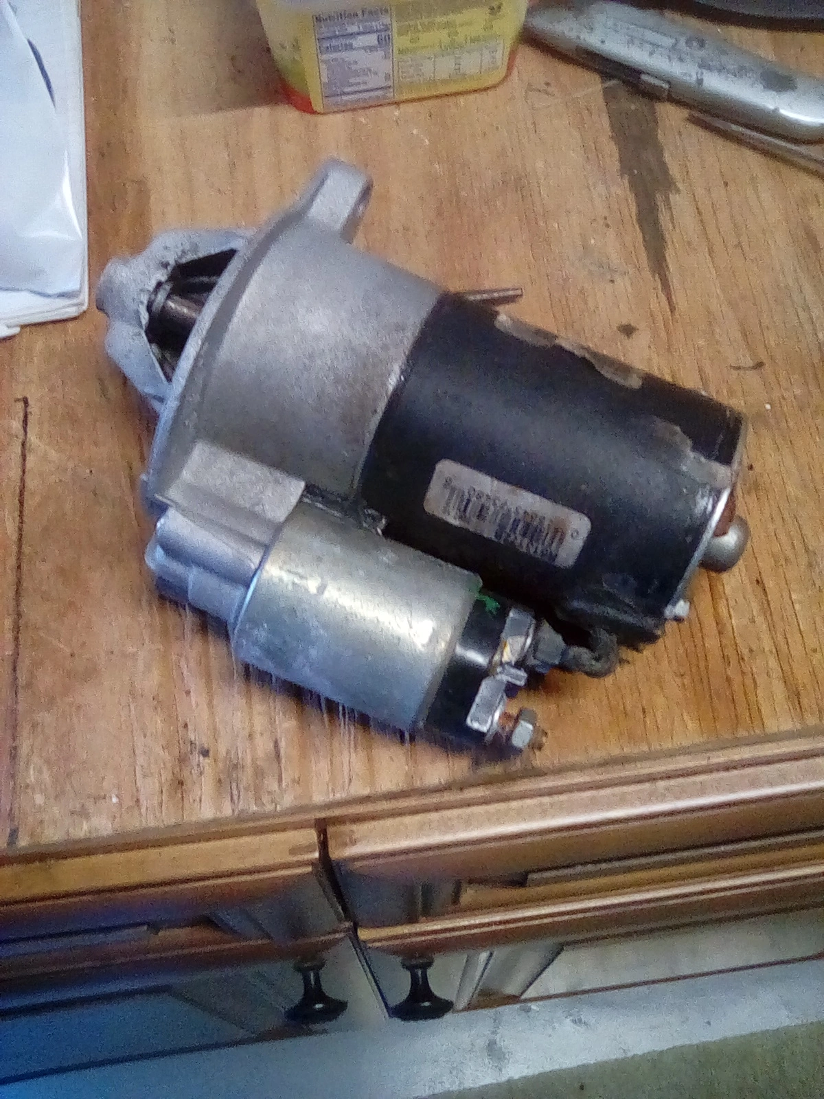

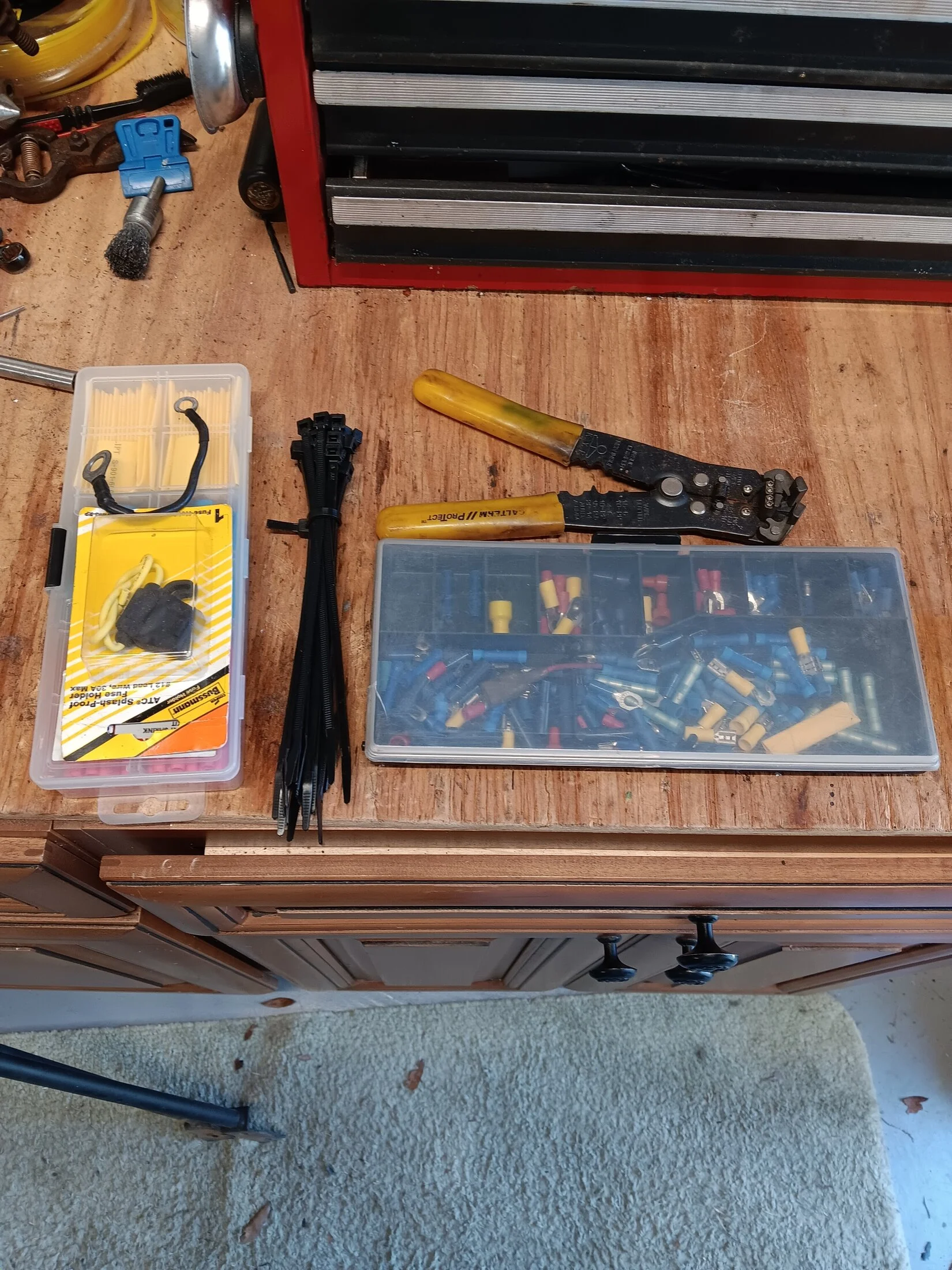

Alrighty now (in my best Jim Cary voice)! let us look at the wiring mod I feel is necessary,
Here is the wire from the solenoid to the starter:
I'm adding a wire in place of the jumper, it may or may not be the issue that really is not an issue because the 'run on' is short and does not impact the flywheel, it's just a little annoying.

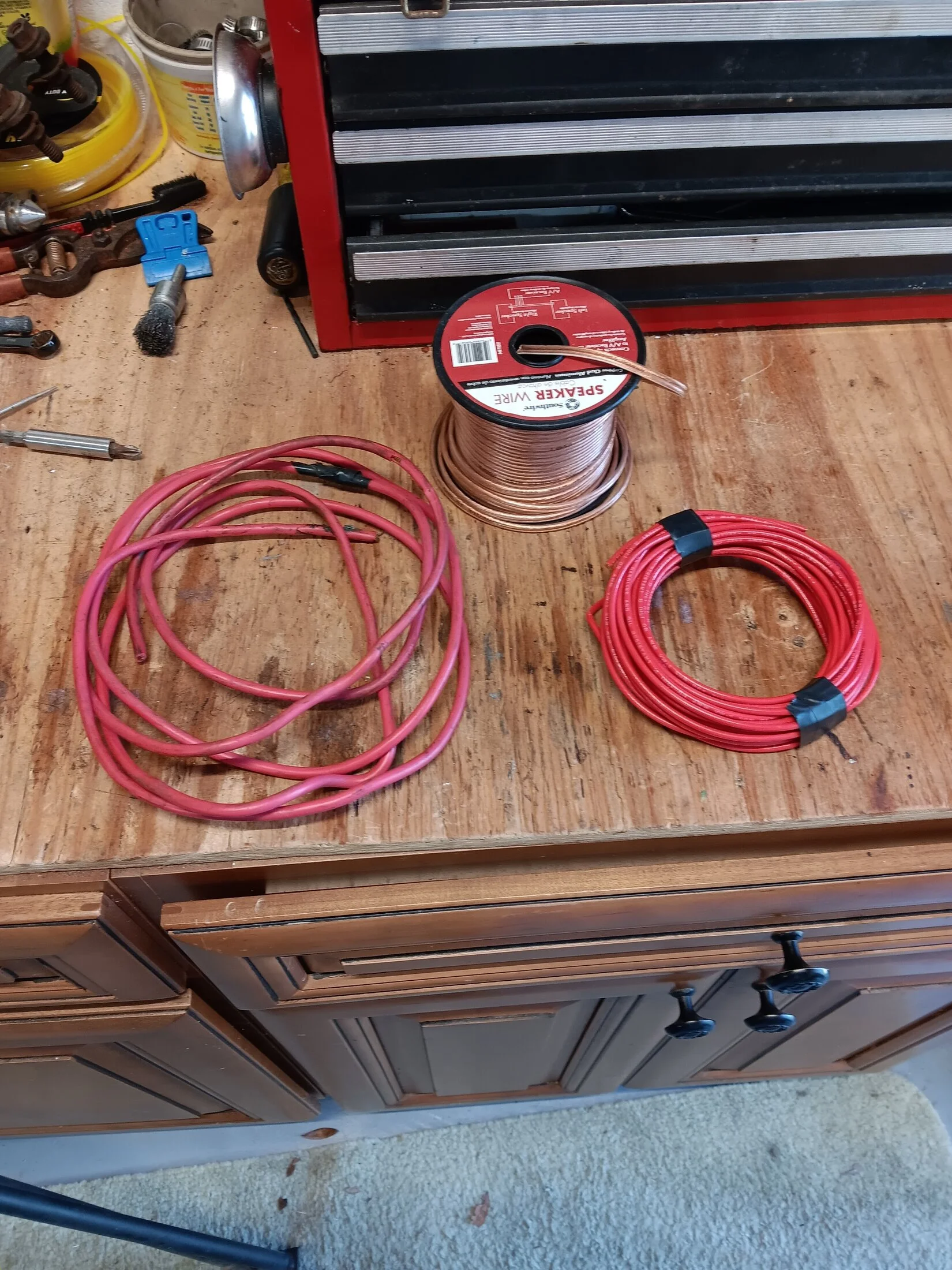

Here's what I have on hand:
the red wire on the left is likely 10 ga (or bigger)' I used to have a wire size guide but couldn't find it. The wire on the right is 12 ga automotive wire, the center is a roll of speaker wire , I like the idea of the 'duel' speaker wire that way when one burns out, and it WILL!! you have a backup wire already installed, so if the fire from the first wire didn't burn down the car the second can give it another chance
the question is 12ga the right size?

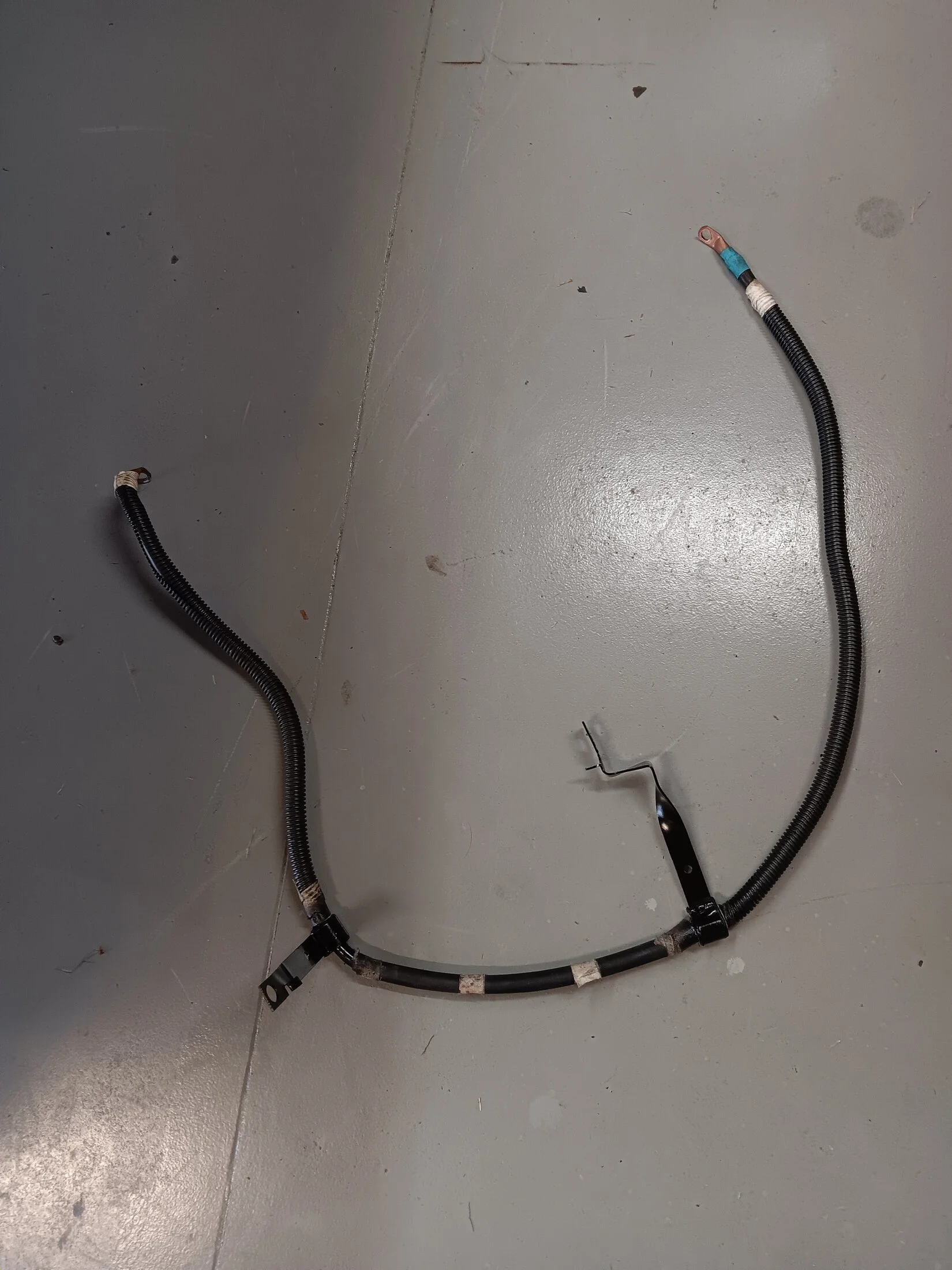

That red wire on the left has a couple sketchy spots so I can get more, oh, and other 'stuff:
I also have that 'special' tape in black so no more white 'special' tape.

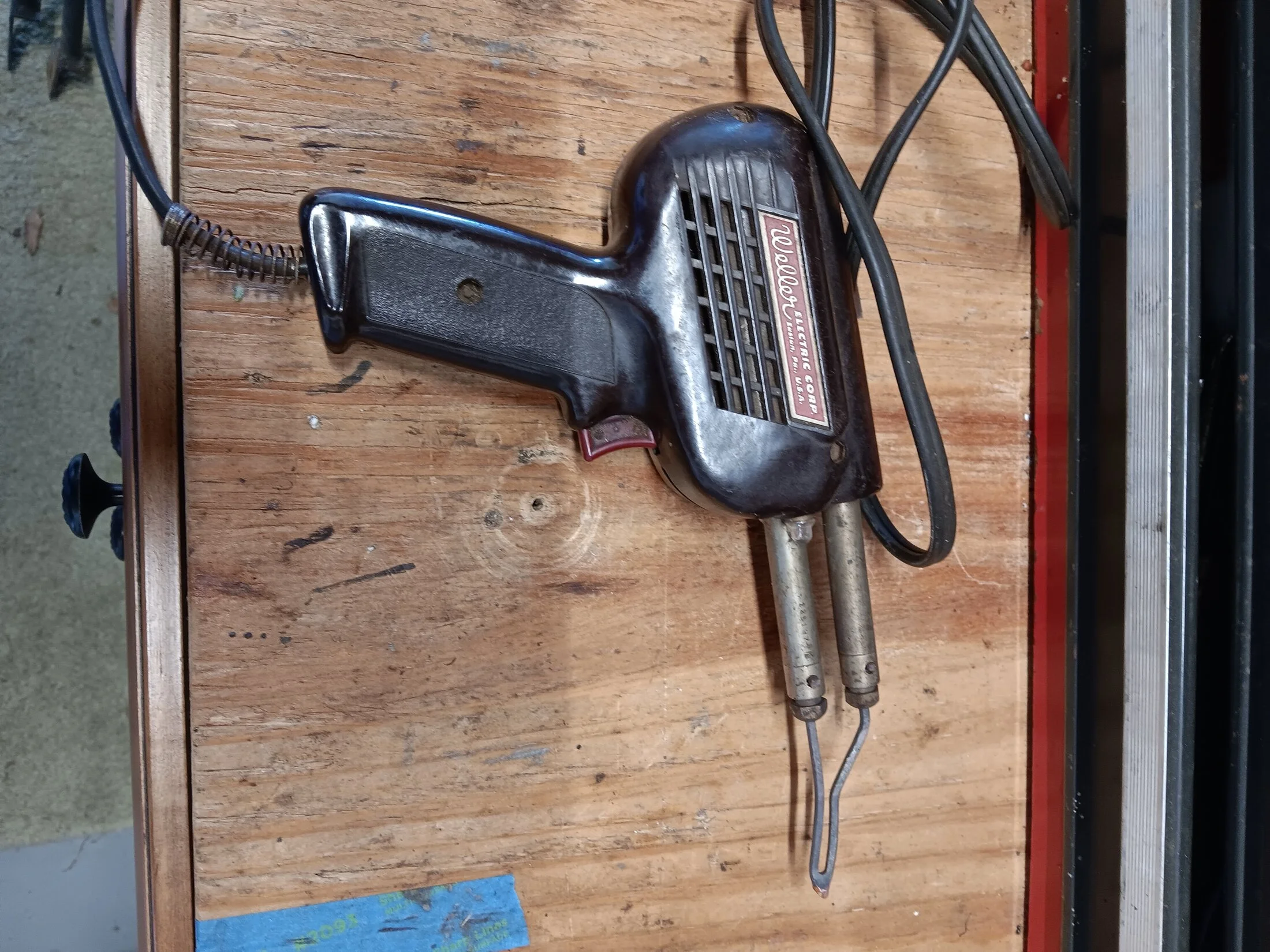

Oh, and this antique:
Actually works quite good. An old friend gave it to me after he died, I know you're scratchen your head, "after he died"? how's that?
well he loaned it to me a few years back then died so now it's mine so remember that when one of you guy's loan me things, don't die till you get it back.
So let me know what ya'll recommend for wire size, anybody know what size the factory wire is and do I need a fuse or fuse able link on that wire? I'm patiently waiting

So where is this jumper wire again and which starter do you have (old boat anchor style or the mini)?
Mini-starter, like 92 5.0, I think it would be the 'trigger' wire, from fender panel solenoid to starter solenoid, like a 92 5.0 would be.

This one.

Put the large 4 ha back on the starter solenoid but on the battery side and the other end goes to the large lug on the solenoid on the starter. Use the 12 ha wire and put it on the hot when cranking side of the solenoid and the other end goes to the make spade tab on the solenoid on the starter. That is all that is required.

Check. I just needed to confirm 12ga wire is good to use or should I jump up one size.
I take it the speaker wire is a no-go
Reactions: Monkeybutt2000

No go on the speaker wire. The wire only needs to carry enough amperage to make the coil in the solenoid work. Most use 10 ga but I wired one with 14 ga and it’s still working in my buddies car years later.
Reactions: General karthief
I'll be out working on mine on a bit. But I'm pretty sure 12ga will be plenty.

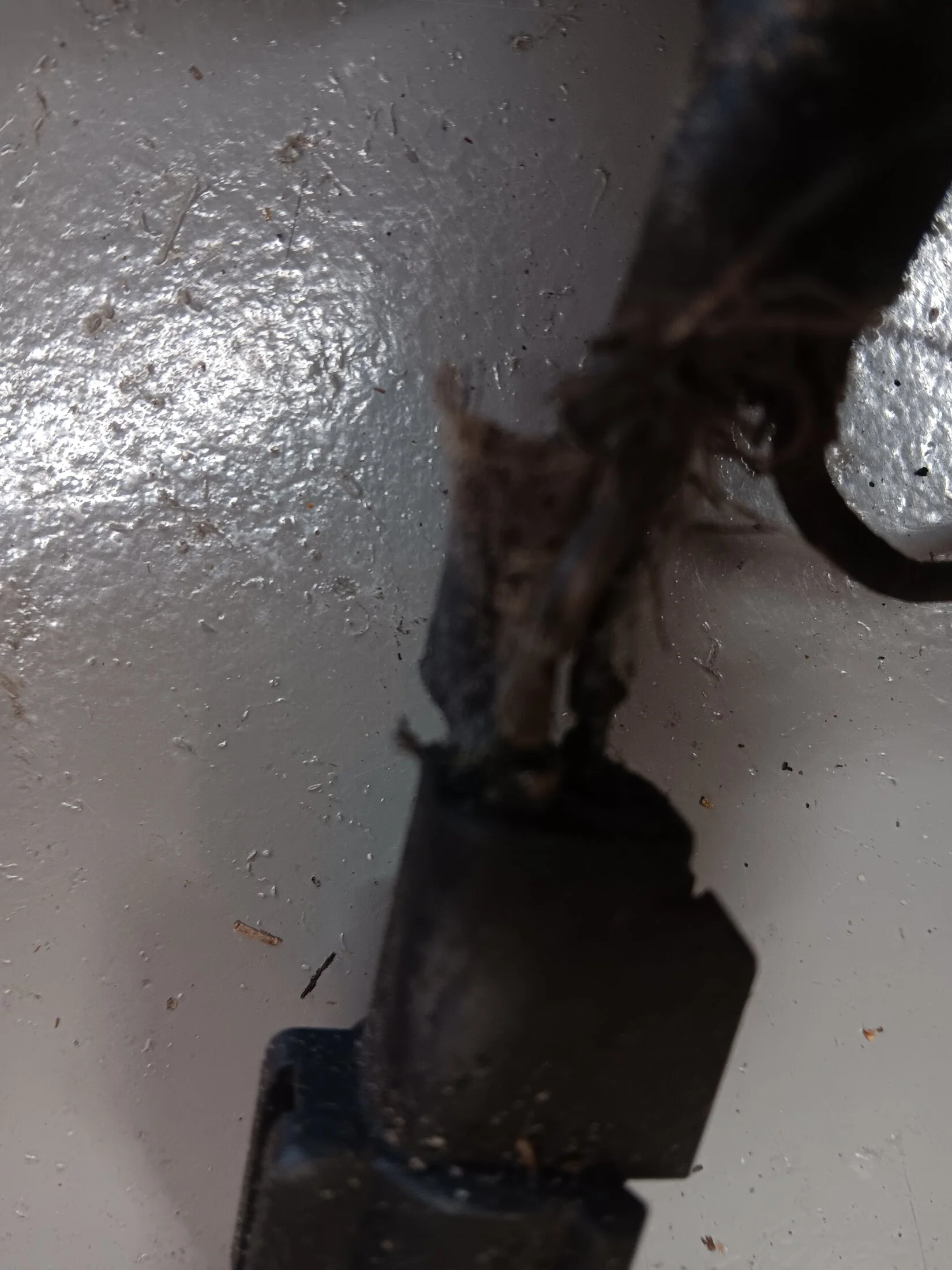

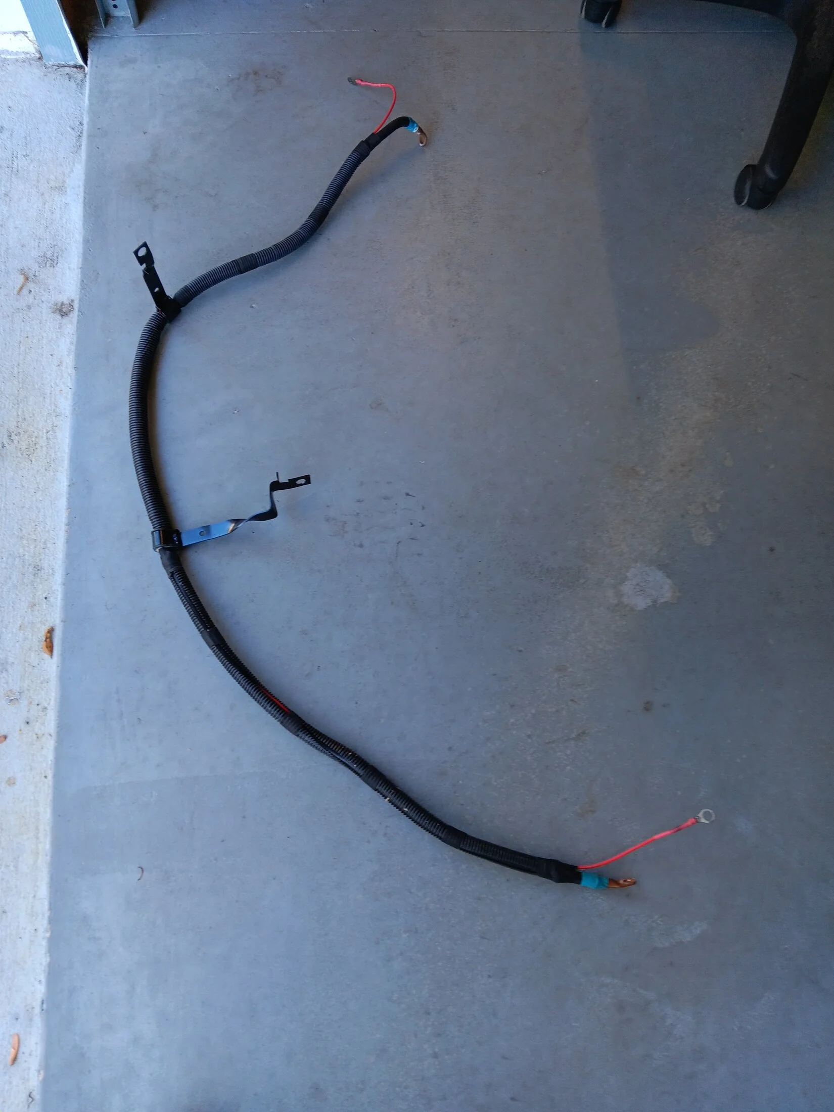

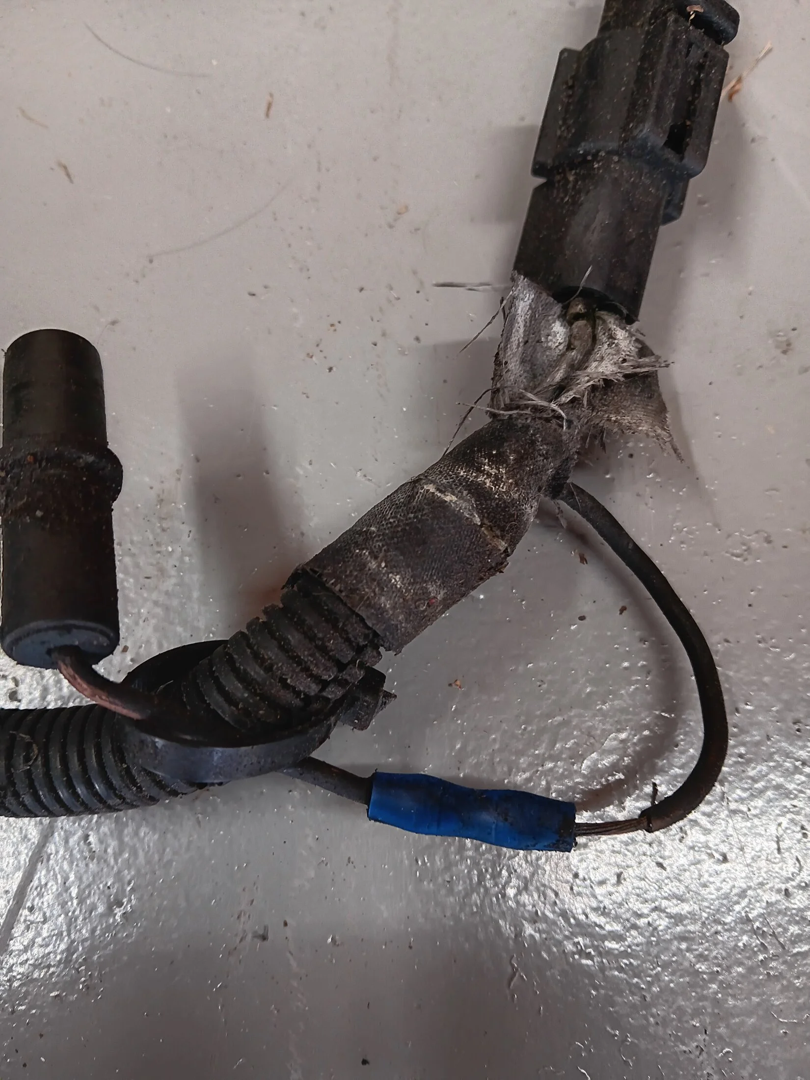

update:
yup, I think this will do nicely. hung it on the engine loosely where it belongs and on to the O2 harness. buggered 'low oil' warning wire and one O2 plug on the same side has buggered wires. Right at the plug, place bets on if I have replacement pins that will work?
focus dammit! Ain't got that 'closeup' thing mastered yet. Anyway picture chapped, exposed wires right at the plug, causes intermittent codes or no codes when there should be. We be fix'n.
Reactions: AeroCoupe

Sometimes I just need a quick slap on the back of the head! Reading through a recent post on another thread I realized that, for the most part, some parts have replacements now, instead of finding, cutting, welding old 30+ yr old plastic sensor connector, I can order, wait a few days, cut, weld a few wires together on new stuff , with good clips and sht! Man I miss not hang'n at the shop, so I'll clean up and paint the rust spots on my K member brace, already knocked off the rust and paint chips, Ospho treatment now wipe down and rattle can paint. I have pics around here someplace, I actually have two of them. You know, in case someone needs one .

Looks real nice, and looks fun
That one wire round plug is your main processor ground on those older ones.
Disconnect that and it will not run.
I'd like to see you have that one soldered and sealed up real good.
Right, you can get almost every part of that harness (even) from Ford last I heard.

That single wire plug looks kinda like the computer ground but it's the wire for the low oil sender and I solder every time. I detest butt connectors.
I've gotten pretty good at soldering, Brand X had a few of those twist wire connectors WTF were they thinking?
