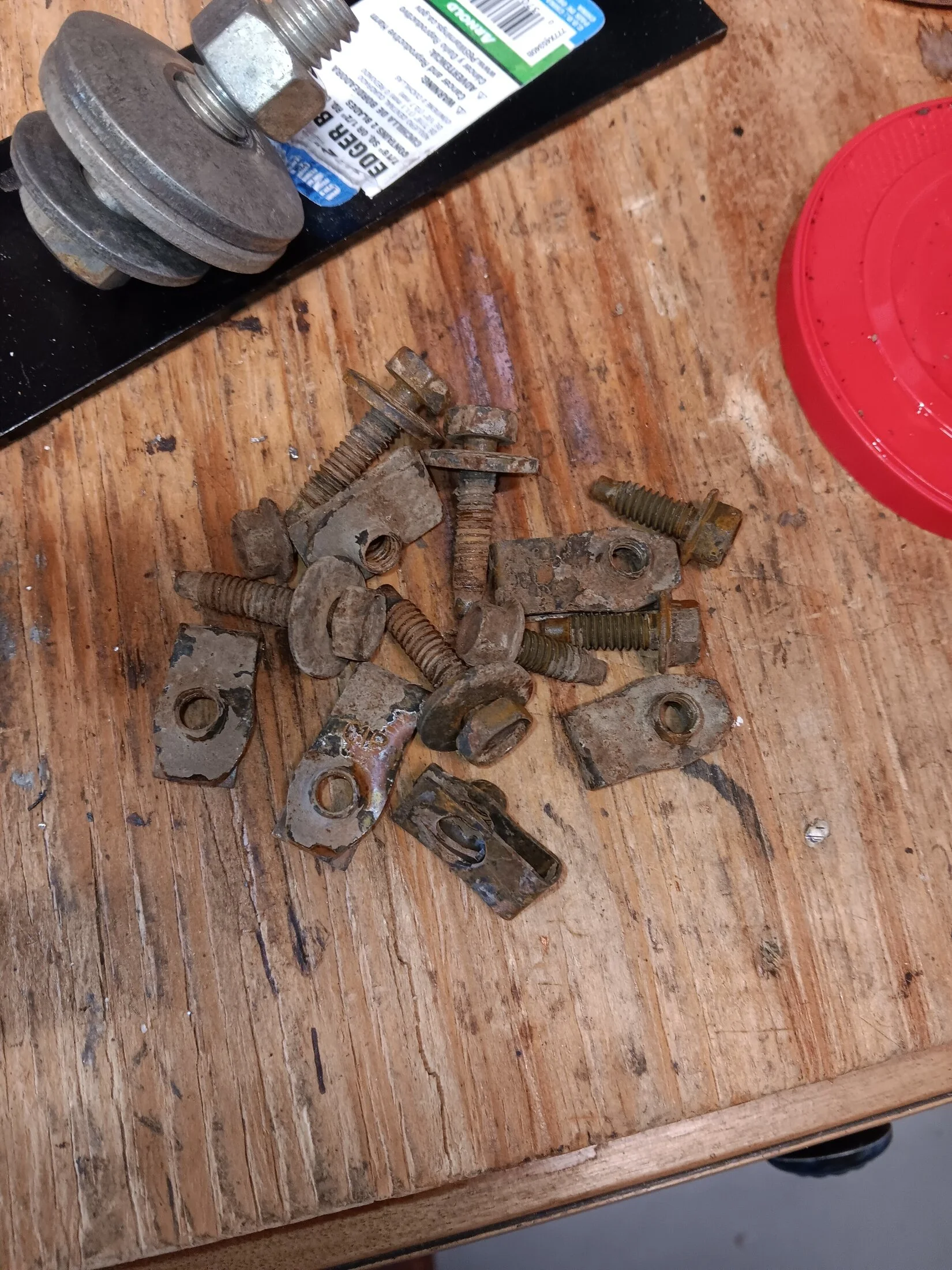

Anybody ever used vinegar to clean rust from nuts, bolts and small brackets?
I'm trying it out now on some on the stuff for the air dam and condenser brackets, I'll show results good or bad. :O_o:
Yes, I have…..
let the bolts soak for a very long time but in my case they still didn’t come as clean as I wanted but it did work to some extent.
After a period of time, Take them out and hit with the wire brush then back to soaking if you prefer.
It works but I wss Expecting them to come looking brand new which didn’t happen. Lol

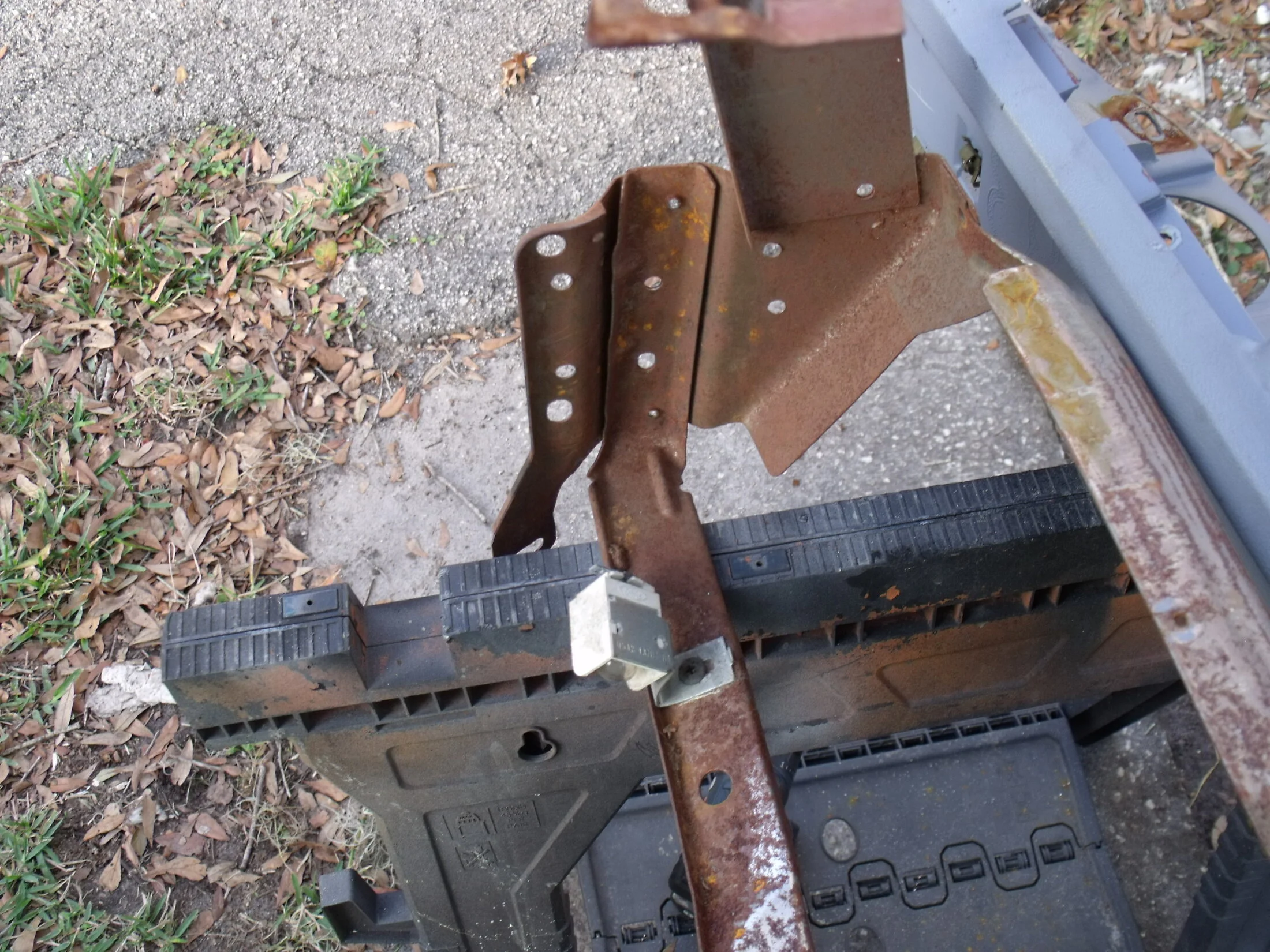

I had some under dash pieces, and hard to wire wheel parts that I soaked in this... 15 minutes for some, 30 for others...
Hosed them with water to neutralize the acid, wiped em with Paint thinner or lacquer thinner, let em dry and gave em a coat of primer... A Very light sanding to give the paint some bite..
2 gallons at Home Depot were around $10? or so... Purchased a plastic storage tub from the same place ( all sorts of different sizes available) to soak things in..
This will not take off paint, it only works on rust...
Worked out very well for me....

I spray'd em down with lube, I'm only using two pairs so :shrug: and you'll never see them.
As good as that is gonna get,
Had to ditch the flat metal I worked so hard on cleaning, painting and drilling holes after about 20 measurements taken. The bolts were just a tad short and I was NOT going back to Lowesdepo, already been there this morning for landscape wood and mulch,

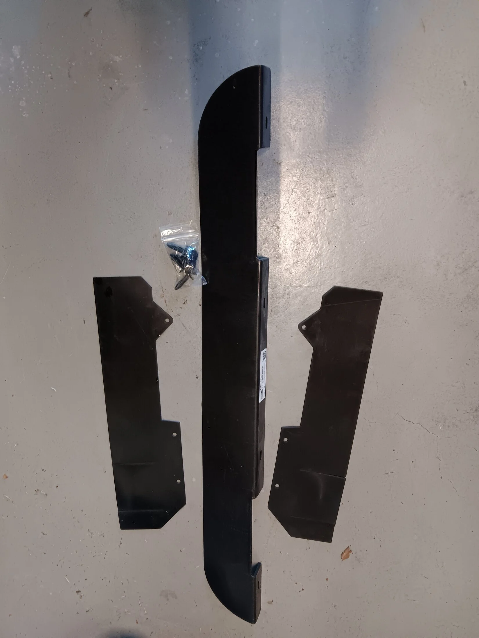

I hate it when someone let's say, tells you a half(?) truth. I was told the air dam was new, it was not only new, it was still in the original package PLUS new, in package radiator to core support fillers AND push pins still in the package :banana:
Now where did I leave that check :thinking:

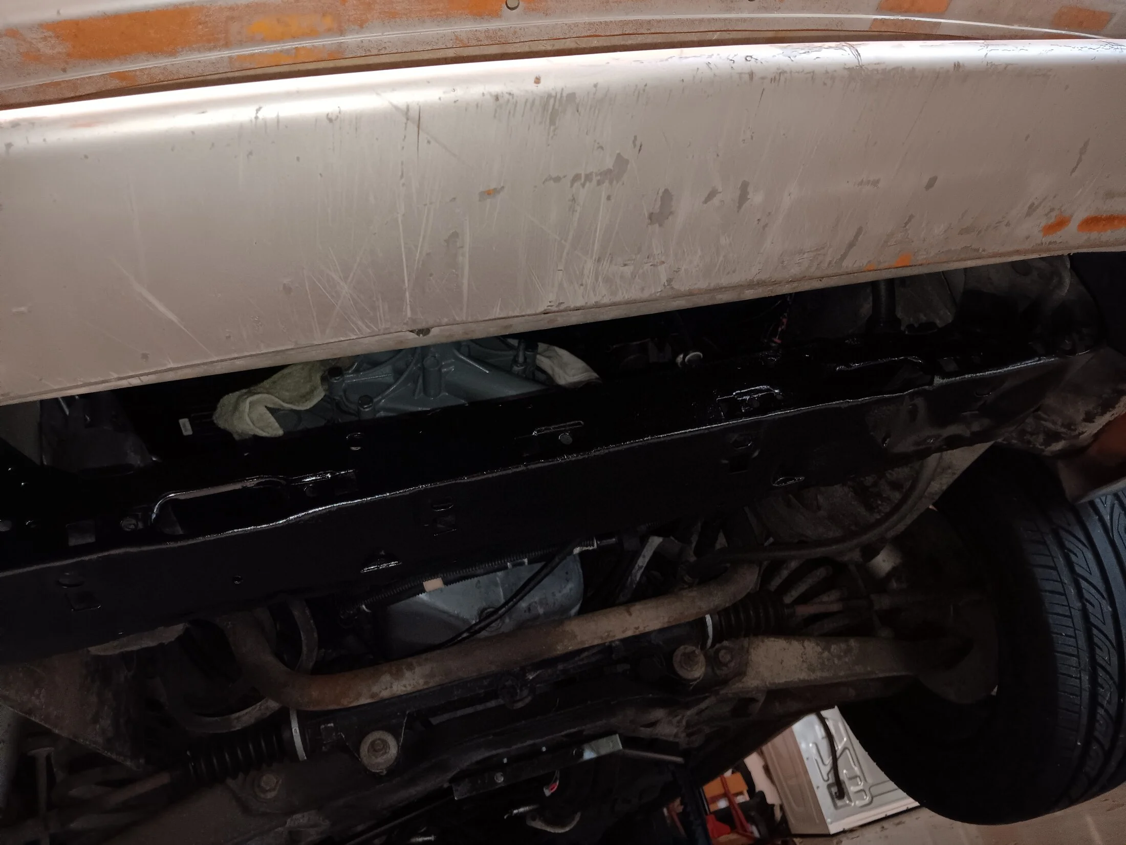

Lower brace and NEW air dam installed, torqued down, wires hung by the brace and a bolt on the bell housing, Ready to move on to starter and hang,n those wires. It may not run when I'm done but it WILL be nice and orderly.

That fail was do to impatience, soaked a couple small brackets and they were remarkable, just a soap bath and some paint so I stuck the bolts and stuff again, three days and good to go, I'll see if I got pics, need to do a camera dump.
So that failure turned into a lesson, don't be impatient!!

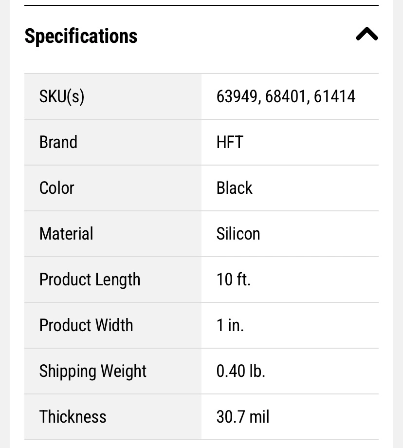

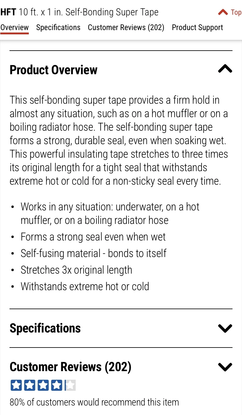

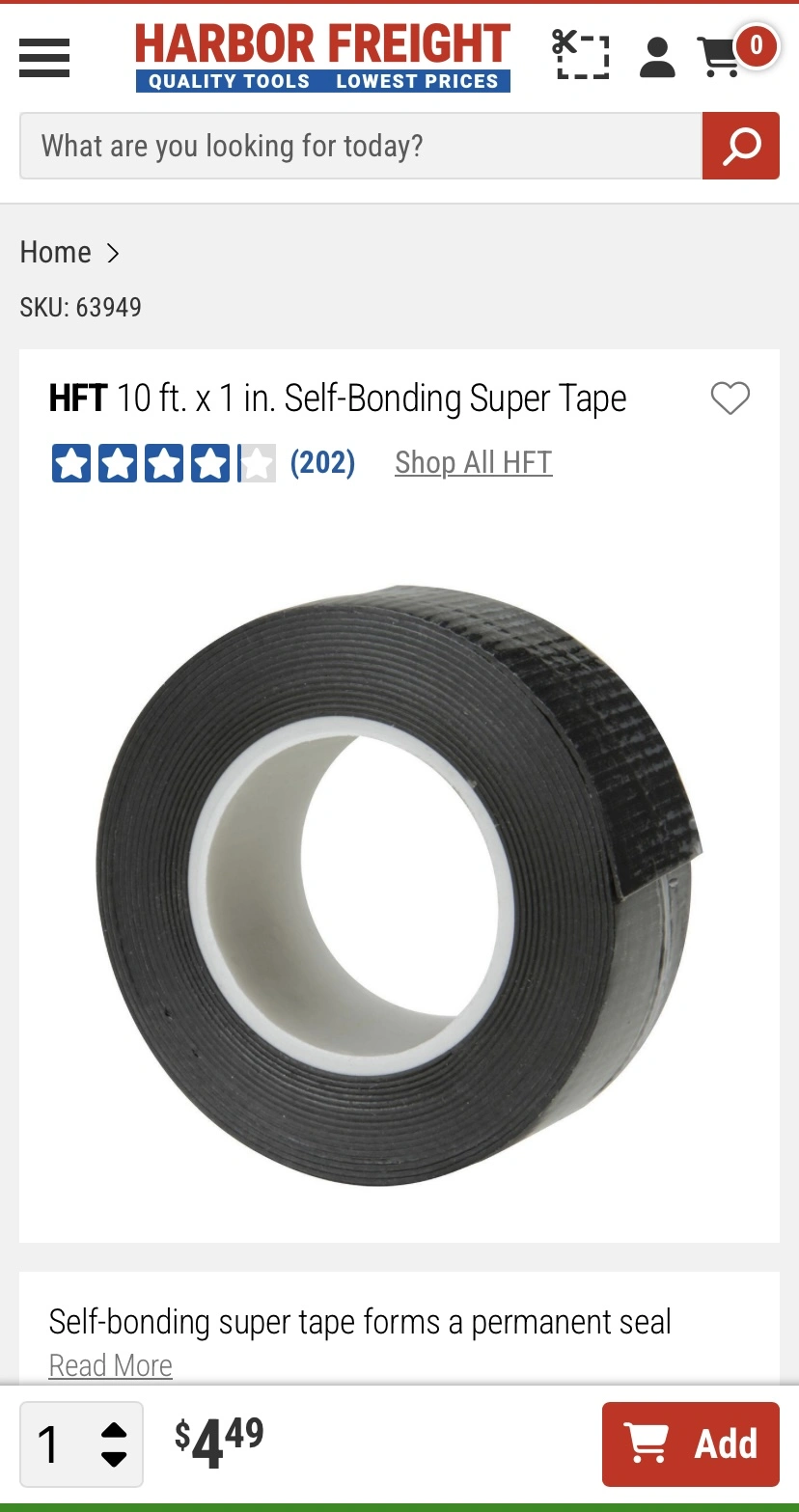

I need to deal with the other failure, the pricey tape I used on my wiring harnesses, yes it's coming undone already, what type of tape do y'all suggest?
Yes, it can be a pain to remove. It’s not as permanent as they advertise but it definitely takes some careful effort to remove when it’s used on wiring as not to cut the wire insulation with the razor as you split the tape for removal.
The effort needed to remove it also depends on how many times you wrap it around the same area. Once around your fine but twice
or more and your creating a job to remove it.
The stuff works well but you’re right about thinking of future access for repairs. That will have you cussing. lol
