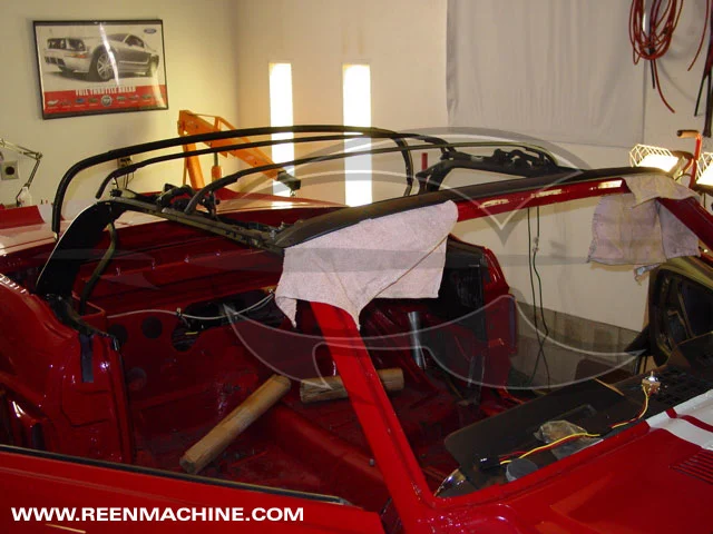

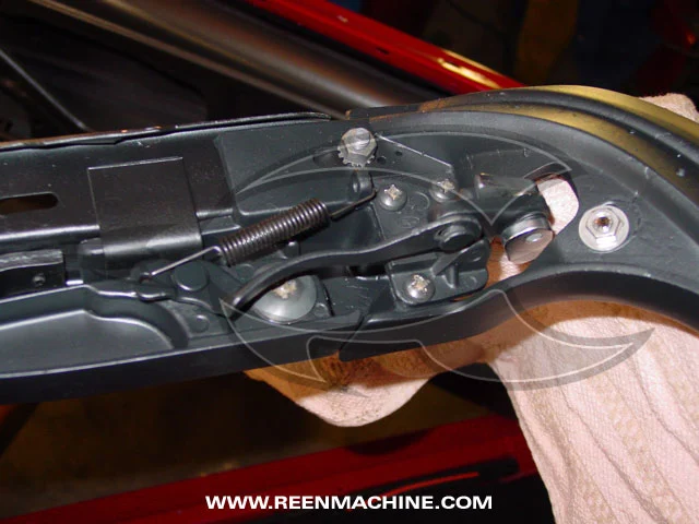

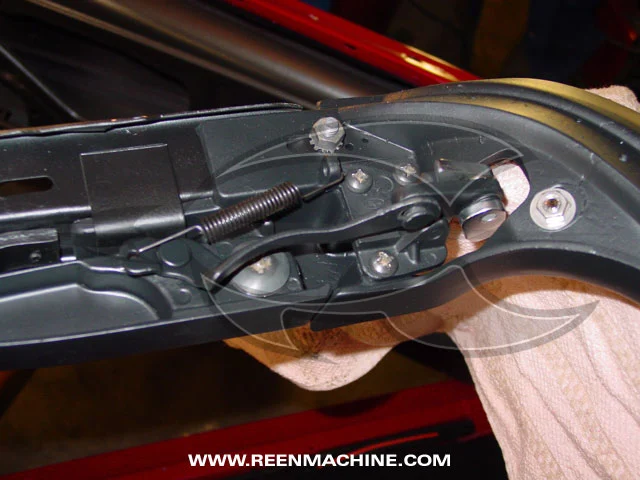

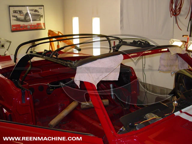

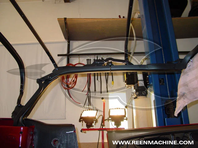

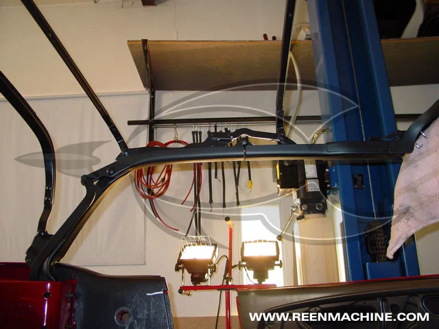

I ended up making quite a project out of the convertible top frame. We always used to scuff & spray the parts that would show when the top was on, grease the pivots, and go.
That just wouldn't fit with the rest of the car, so I went overboard :rolleyes:. I'm trying to stick to the theme of having the parts that will never be seen again once the car is assembled be every bit as nice as the ones that will. I end up burning a ton of time this way... :p :p

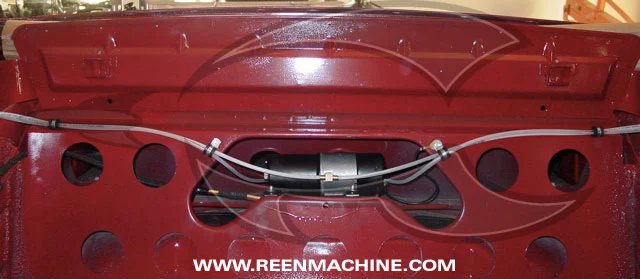

I disassembled the top frame, bead blasted everything to bare metal, and sprayed it all with DP90 epoxy primer/sealer. All of the pivots received attention and I rebuilt the latches to work like new with no slop. The car originally had a manual top, so I converted it to power with all new parts.

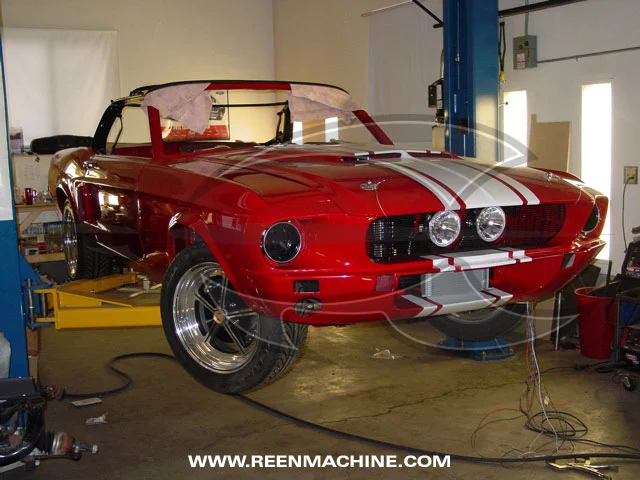

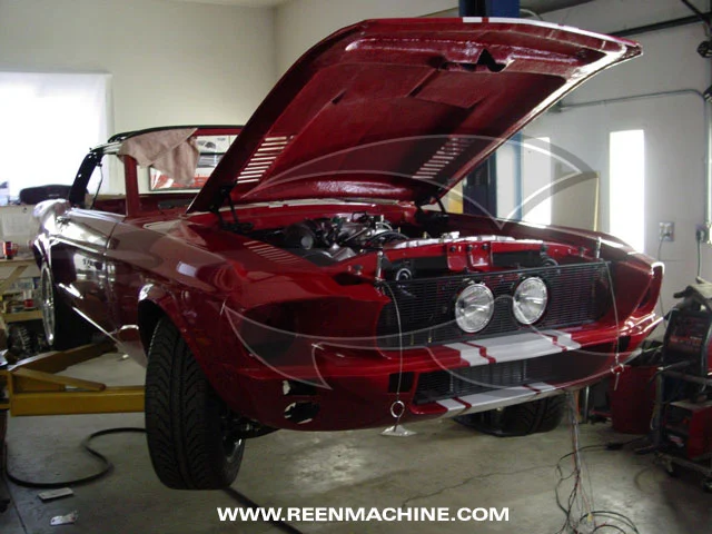

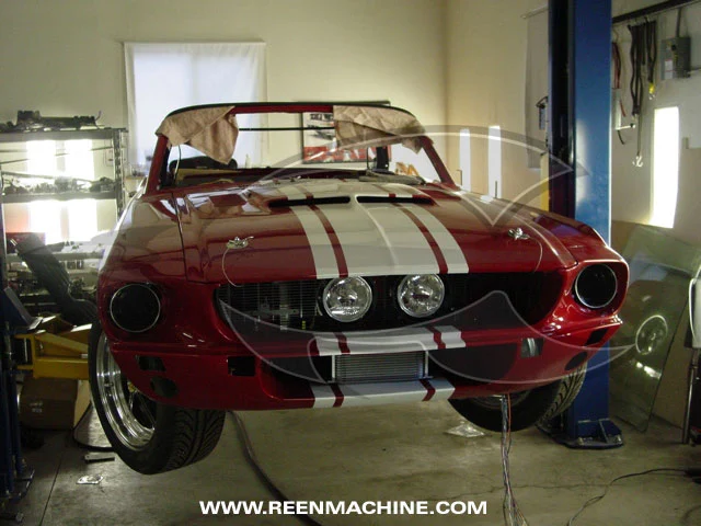

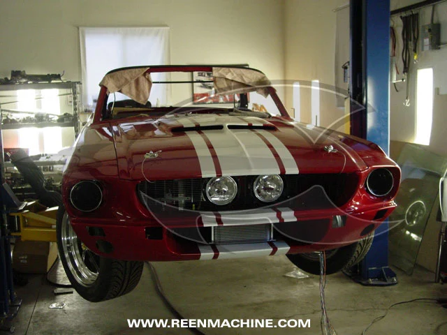

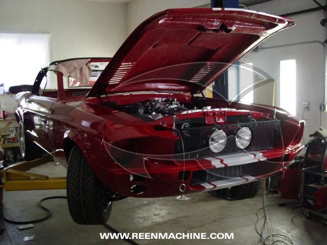

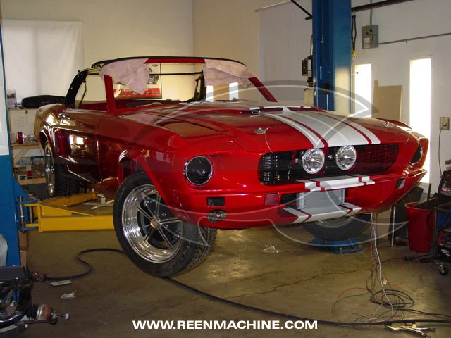

I've got the front bodywork together to fit the lights, grilles, oil cooler, etc.
With the other 2 projects off to paint, I have more time to devote to it, so the updates should be coming more frequently now.
It's motivating to see the front end together!
65mistress said:
Question: Are you going to put a grill in the valance or leave it open with the cooler?
The top pic has the grill in place. I'll probably use it, but the cooler looks sweet down there, and won't be so obvious when the bumper is in place and the car is on the ground. It would probably be best to put the grill in front of it though for safety reasons.

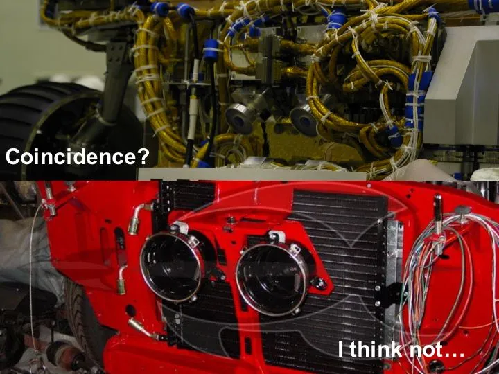

First Mustang on Mars
The similarity in the wiring is obvious! Aren't you glad the Mustang doesn't have to operate in the Martian environment?
My dad worked on the landing radars for Surveyor, Apollo and Viking. Although he was less hands on and more management as the years passed he was an avid electronics hobbiest. His wiring was meticulous and worthy of an engineer who helped put a man on the moon.
Brad
Reen, I notice your not using the waxed string like they used on the rover.
Working in telecommunications for a while, I had to help swap out some power supplies (24v) in some cell sites. They used waxed string to tie all the wiring together. Thought it was wild they didn't use cable ties, but the guy I was helping was so swift in using the string, I think he could tie it with that faster than I could put a cable tie on it.
Well, here's a tangent, but why not...
The rovers are packed with ultra-sensitive sensors and optics, so a primary concern is outgassing of materials. See, if any material (adhesives, plastics, etc.) on the spacecraft outgasses (loses mass as vapor) in any way, it can contaminate optics and sensors, potentially rendering part of an $800 million project useless. Anything that can outgas immediately will when exposed to the vacuum of space. Thus, the string tying the cabling together isn't waxed string, but special non-outgassing, thermally stable, UV-proof miracle string. Yes, the cable techs can tie that stuff up in their sleep!
Another huge concern with operating a spacecraft on Mars is thermal cycling. The place goes from freezing-ass cold to almost comfortable on a daily basis, and the rovers are over 700 Martian days into the mission. Plastic cable ties would have become embrittled and failed long ago. I think there are spaceflight-qualified cable ties out there, but JPL doesn't use them. First, the string works great, is thin, pliable, etc.; second, it weighs a lot less than cable ties. This may sound funny, but every gram counts on spacecraft and you can tell even from that small pic that there would be a hell of a lot of cable ties on that thing.
