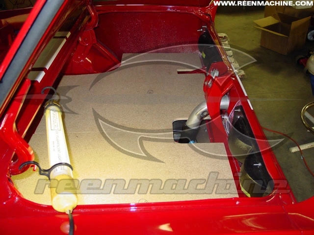

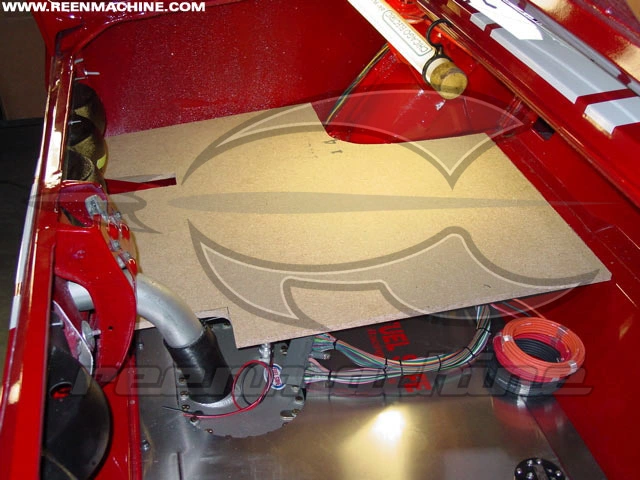

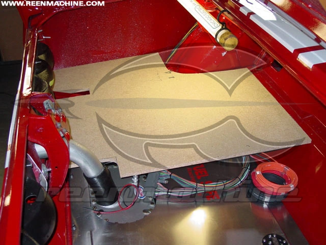

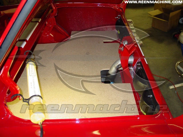

I've been workng on making a floor panel for the trunk. It will cap off the fuel cell, protecting the sending unit and fuel pump wiring that protrudes from the top, and it gives me a nice cubby hole to mount the ECU and related wiring associated with the EFI system. I'm going to carpet the whole thing so it looks clean.

65-347 said:
I know this was do a while ago but did you use a stock filler tube? I'm looking into the same set up for my 65. Thanks (by the way this is a great car)
It's a modified stock filler tube that comes with the fuel cell remote fill kit. Fuel Safe welds in the bung for the cell's vent hose.

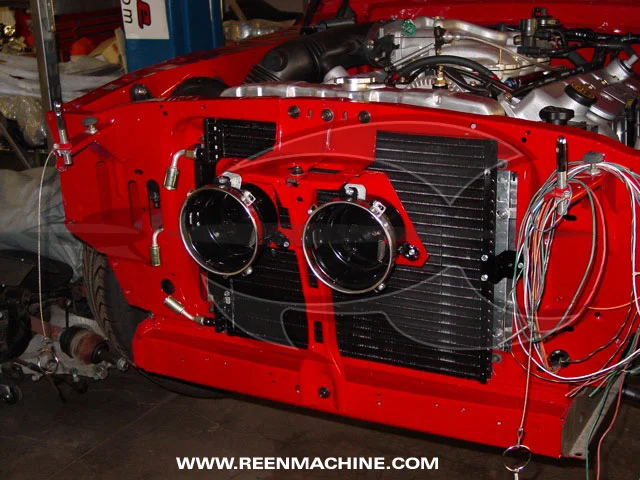

OK -- back to the convertible. I got the headlights on order yesterday. Instead of having low beams on the outboards and high beams on the inboards, I'm converting it to high/low on the outboards and insanely high on the inboards, to be controlled by a switch on the console.
All four housings are Hella 5-3/4" H4 conversion lenses, with 60/55W hi/lo beams outboard and 100W high beams inboard.
I'll get my A/C condenser mounting brackets back from the powdercoater today. Then I can mount the condenser, the hood latch/inboard light support, and the buckets for the inboards. It'll look different for once! The oil cooler is also on the way, so once it's on and plumbed and I finalize the routing of the A/C lines, the fenders and nose can go on and it'll really start to look like something.
Pics later.
Lotsa little stuff going on lately...power top motor/pump mounting, wiring, and plumbing, etc.
I came up with a way to do the windshield washer without the foot pedal pump assembly. There'll be a plastic reservior in the engine compartment with an electric pump, and a small pushbutton by the wiper switch. Pushing the button will run the pump as well as cycle the wipers, and the regular wiper switch operation will be unaffected. It's working on the bench right now, and I'll post a how-to when I put it in the car.

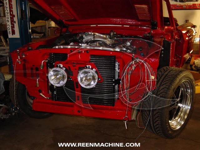

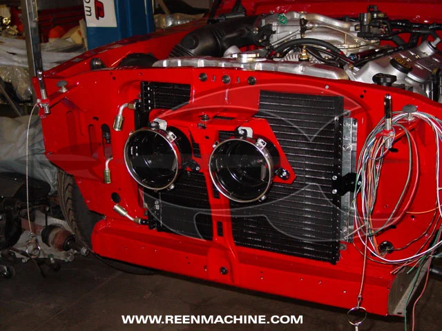

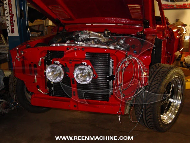

I got the A/C condenser mounted and then the hood latch support with the inboard light buckets. Every little thing with reproduction Shelby parts turns into a project as every single part typically requires rework to fit. The inboards were no exception, but they came out great in the end.
The inboards are 100W Hella halogens which will be controlled by a switch on the console as driving lights, and they have the approximate output of the Death Star.
