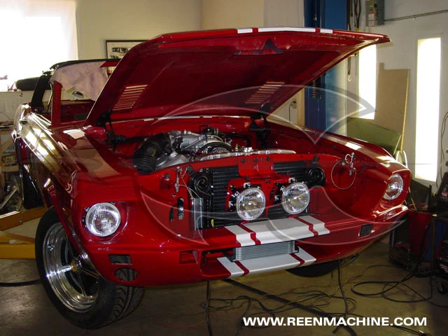

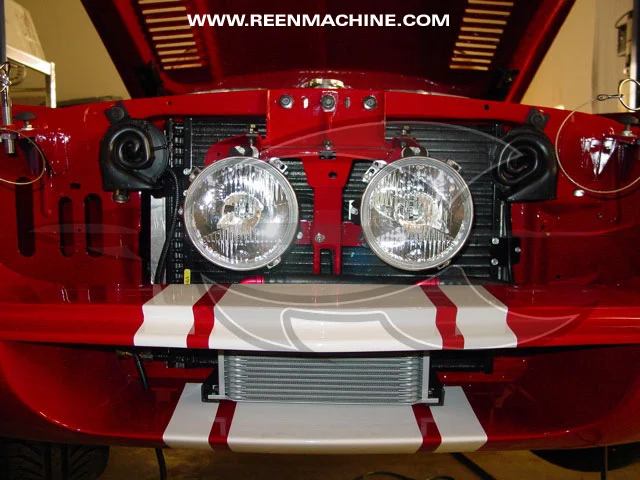

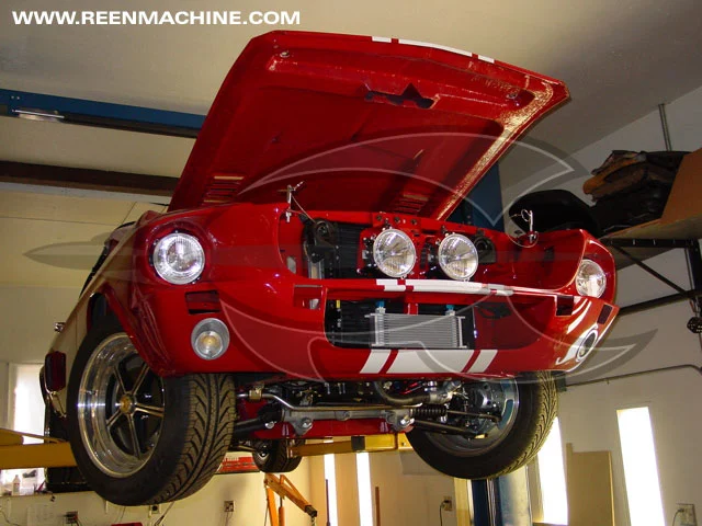

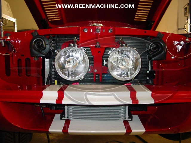

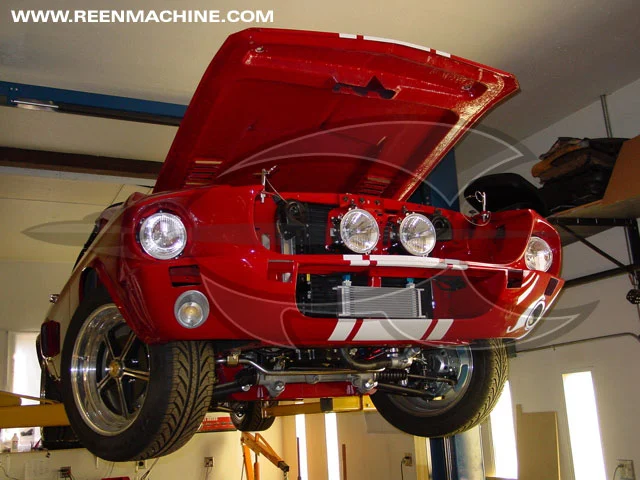

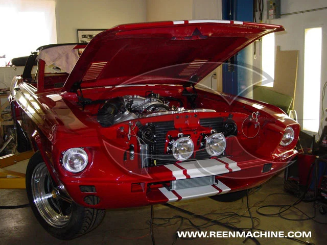

Here's how the oil cooler install turned out. It is mounted in front of the hood latch support on two brackets extending outward from the core support crossmember. The lines extend to the driver's side and are nicely hidden behind the nose support. They go through the core support to the engine and remote oil filter mount.
Just got three solid 12-hour days in on the vert and it shows. All of the wiring from the firewall forward is complete. These lights can draw a lot of current, so I wired everything with high-temp, high-current wiring, and everything runs through relays and circuit breakers.
Yes, I forgot to have the turn signal housings painted body color :bang: . I used them to wire everything up and they'll be painted ASAP. Hey, if that's the worst oversight I come across I'll be psyched!

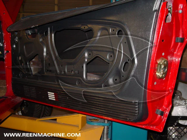

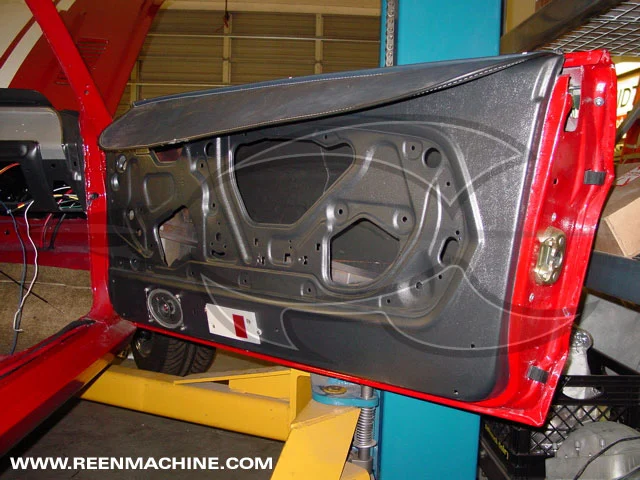

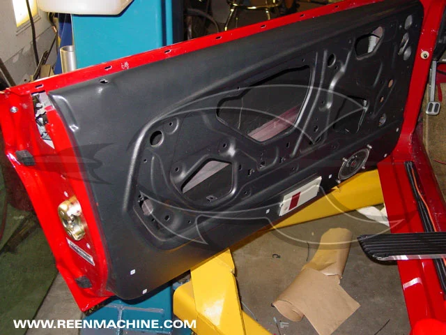

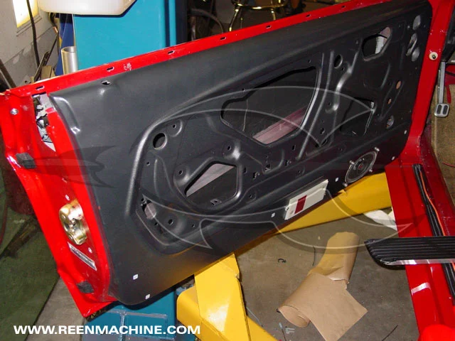

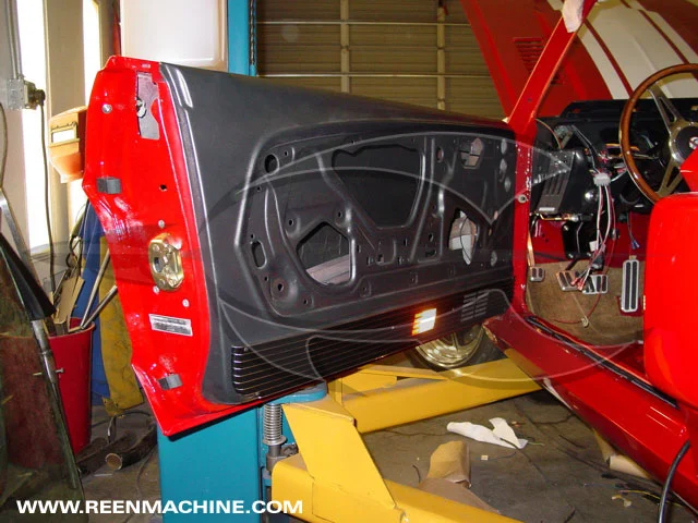

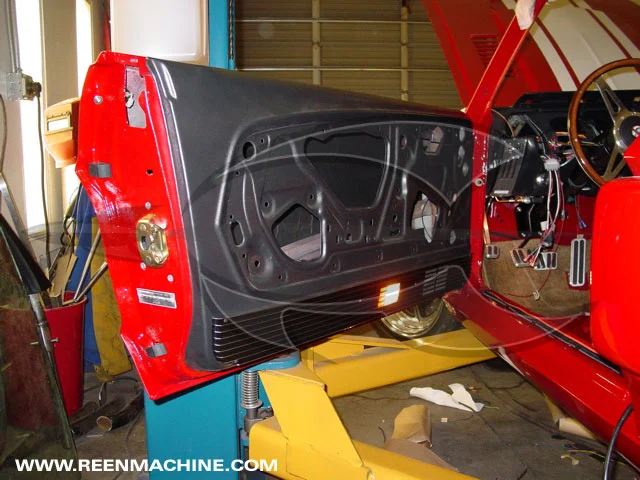

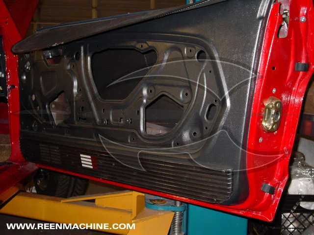

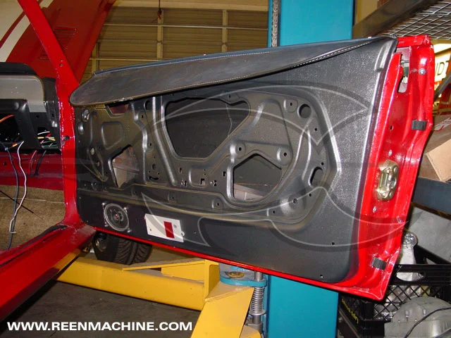

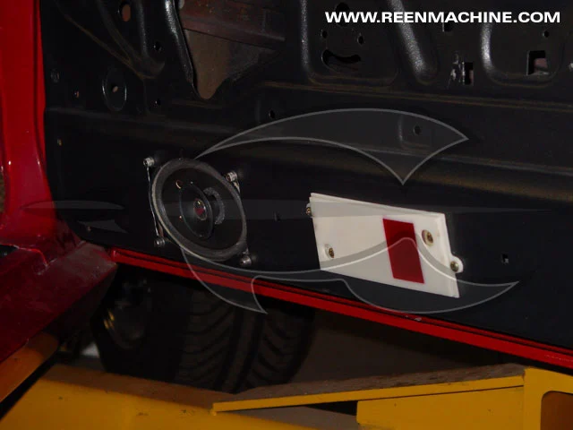

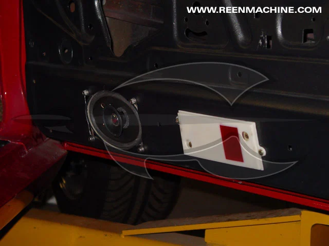

I put sound and vibration damping material inside the door skins, put in the restored courtesy lights, and added dual-cone door speakers. While this car was originally a deluxe interior car, it didn't have the door speakers so I had to cut the openings. I rounded them to match the curvature of the speakers.
After that, new deluxe grilles finish everything off.

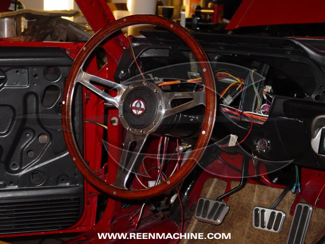

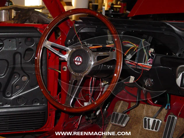

The Moto-Lita steering wheel and Flaming River tilt steering column are in place and all wired up. I'm building the instrument cluster now as well since all of the underdash wiring is pretty much done.
