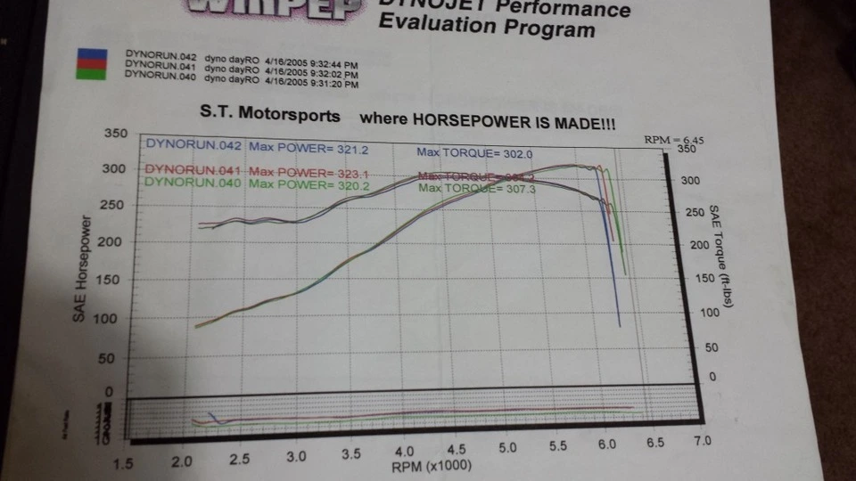

Honestly, you'll more than likely just move the power around. Probably move to something like 320rwhp & 305rwtq IMHO.... Dyno graph of a 306 build a decade ago, very similar to what your plan is....
RPMII intake, 70m TB, 75mm ProM, AFR165 heads(58cc), custom cam (.510\.535, 112lsa), BBK shorty headers, off-road x-pipe, Diablo chip, etcetera..... It was good & fun car I can tell you... ;)

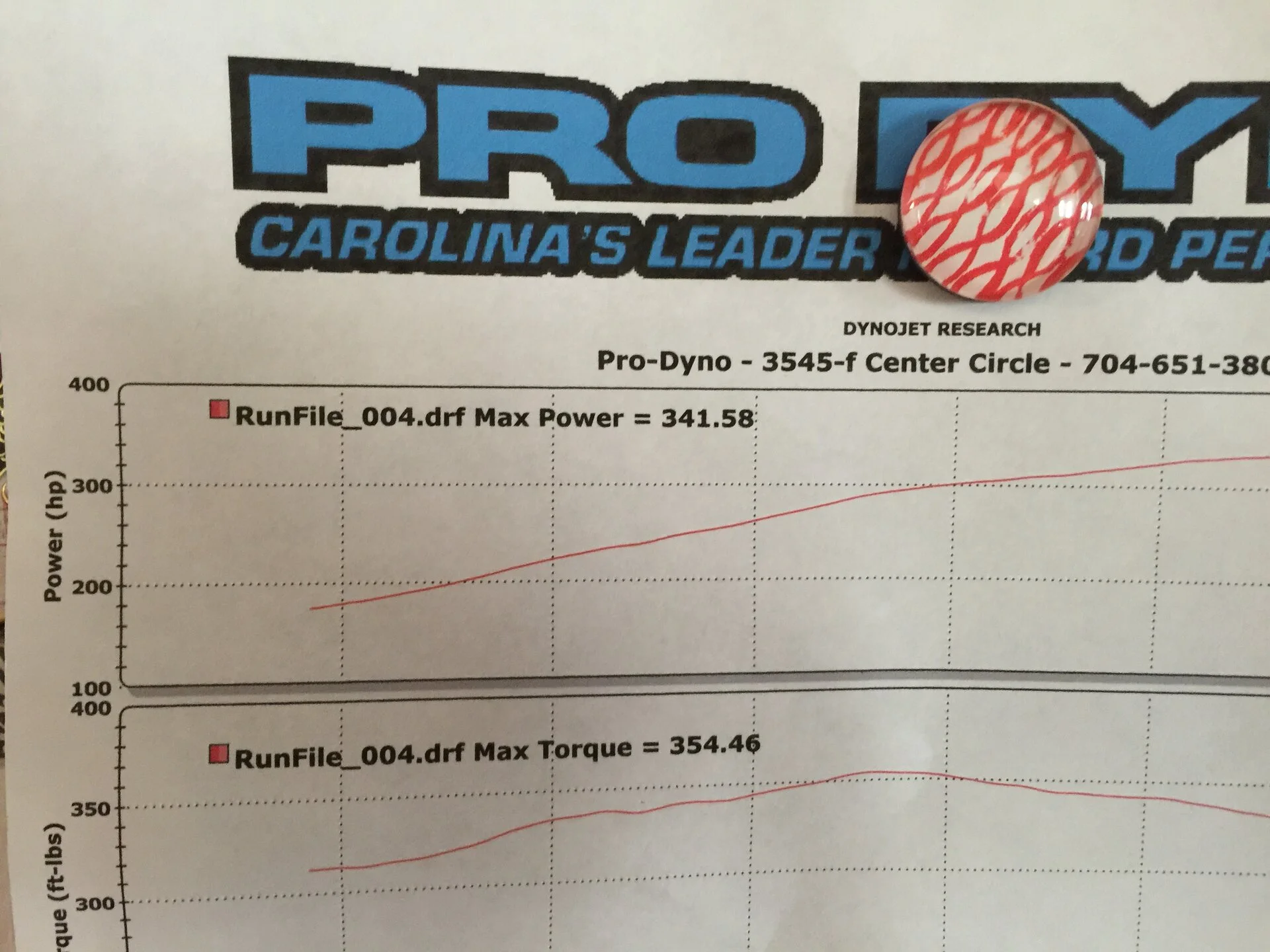

It made 350, although it was real hot on this pull….
