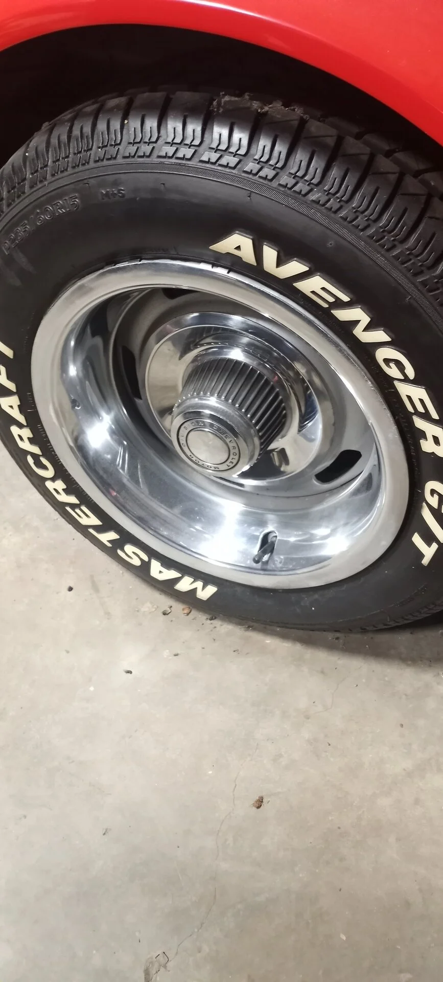

Looking for more tire like nascar these tires on these wheels
