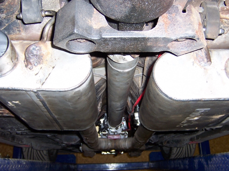

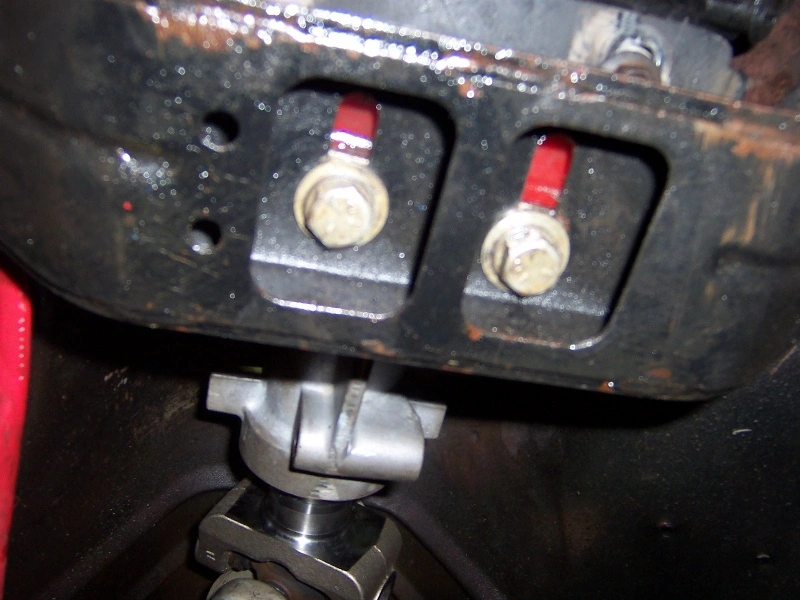

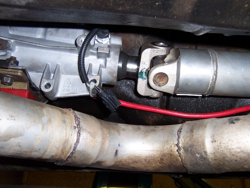

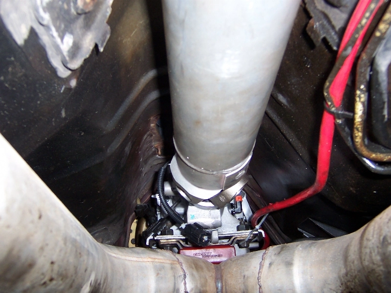

Only thing I got done last night was the exhaust. :( Oh well, I'll finish it up tonight. :)

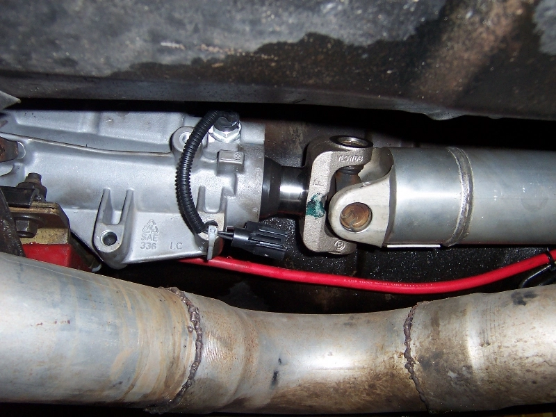

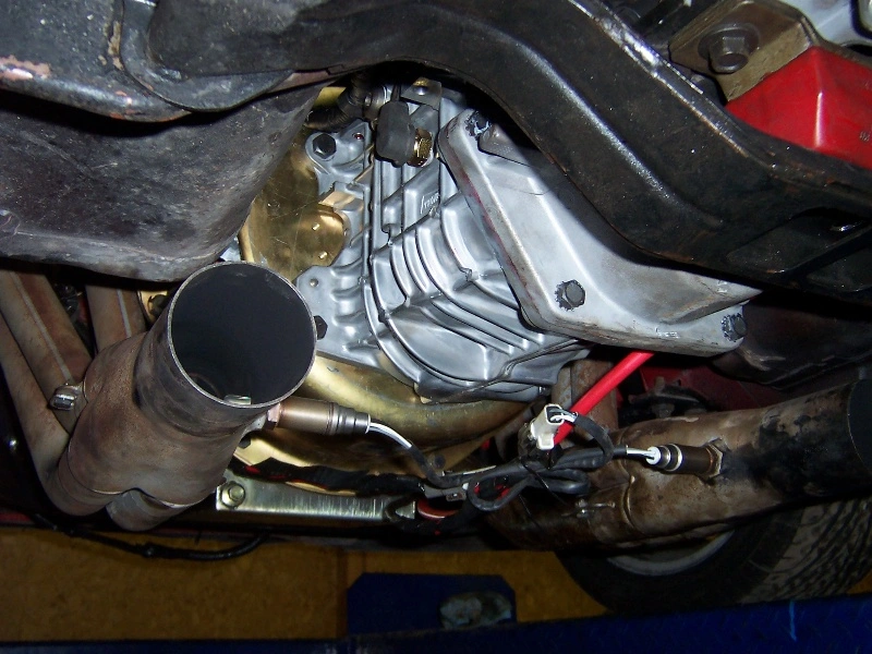

Here's a couple pics

Great pics! :nice:
Now this will be interesting...u have the "real" spacer that our car normally has(bracket) but u're using a urethene mount. Those mounts are not the same height as a stock mount IIRC from a corral thread. Im pretty sure they are a hair shorter. So i guess we'll see how yours goes.
Does anyone know of any bad effects from cutting those GM tabs off the tremec? They are used in the older f-body cars as a mount mount, but they are useless in our cars. Would it void the warranty(lol is there even one?) or make the case weaker in any way do u think?

Well, looks like I have the infamous 85mph vibration! :bang: So what should I try first? Rotate the ds spacer? Flip the x-member? I noticed the shifter is farther to the right than it used to be, and I think flipping the x-member moves it back towards center.

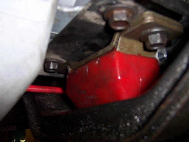

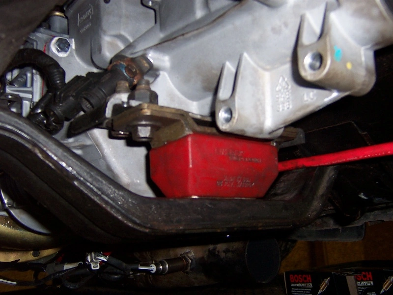

Ok, I lied. I tried adding the spacer to the trans mount first. The ds does look straighter now, but I can't tell if it helped or not. It was dark out so I only took the car up to around 70. I think the vib is still there, but I don't know for sure. I'll work on it tomorrow.
Here's a couple pics.
Before the spacer
After the spacer
Here you can see how the trans looks like it's too far to the right...
But here it like the ds is straight...

My tko-600 sits centered. I also have new motor mounts and tranny mount. The tranny mount you're using in that pic is not as tall as the stock mount (3/16" shorter) so you should use the spacer you put in there. I'm not using the stock plate (black one) so I've got a 3/8" spacer between the tranny and the top of the mount.
Also, which way do you have your crossmember?? Stock has the 2 small holes that are on the bottom closer to the passenger side of the car
Starman, is your shifter centered in the opening? I can't remember exactly where mine was stock, but I'm pretty sure it was closer to center than this one... I still have my crossmember in the stock location.
