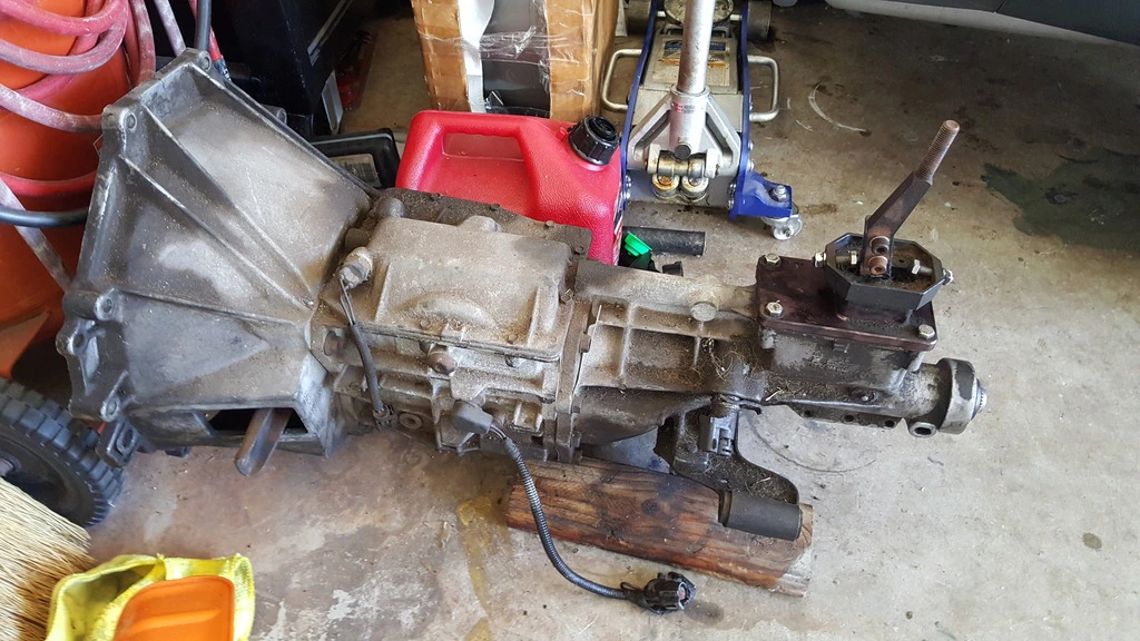

Well, there is always this sitting on my garage floor..... 20160628_092447_zps7hmxy1df.jpg
Not sure I want to go down that path though, even though I have done 4 5speed swaps in the past. I kind of like cruising with the aod.
