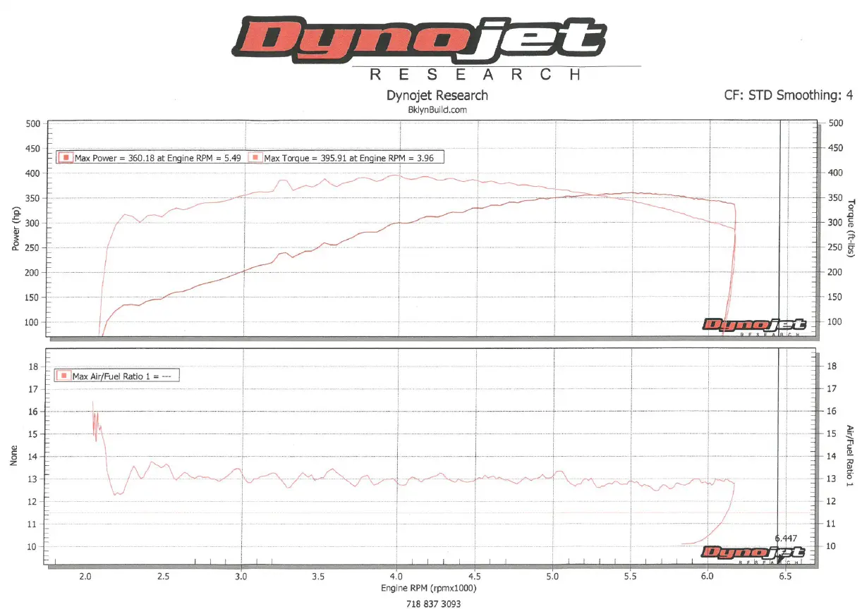

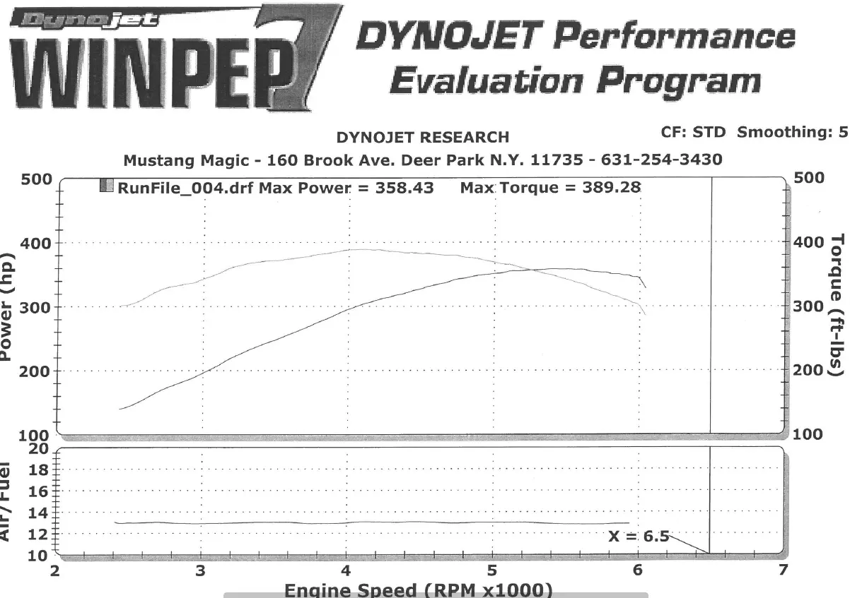

I don't have the sheet on me right now but I got 395 ft./pds with my 170's on a 347.

That's just over my power goals, but very impressive.
Can you elaborate on your combo?
Sure, it's not a secret recipe.
347ci Ford Competition Small Block
New Trickflow 170cc runner CNC chamber heads Track heat
q 61cc Chamber
q 2.02 In valves
q 1.600 Ex valves
q CNC Chamber
q 1.6 Roller rockers
q 10 degree keepers
q 1.440 dual valve springs
q 7/16 studs
347 Ford Engine Block
q A Ford Roller Block Was Used
q Block was square decked
q Block was line honed
q Block was square bored and honed with honing plates
q Engine was trial assembled twice
q Lifter bores are honed
Competition 347ci Ford Parts List Break Down
q TFS Wiseco Forged .030 pistons
q .030 Filt Fit Moly Rings
q A 5140 Steel 28oz 3.400 stroke
q Engine is 28oz balanced
q A Set of Scat SIR floated rods 5.400 length
q Large radius Main and rod bearings
q Seal Power cam bearings
q Brass Freeze Plugs
q Cam plate and bolts
q Mell oil pump and drive
q Canton pick up
q New ARP head bolts
q A complete gasket set
q Oil and Filter
q Double Roller timing set
q A Anderson N41 cam
q A set of Chrome moly Push rods
q A New Aluminum Timing Cover
q 1.6 Roller Rockers TFS
q A Trickflow Intake 51511002
In addition,
Accufab 75mmTbody
Pro-M mass air for 39# injectors
FMS 39# injectors
