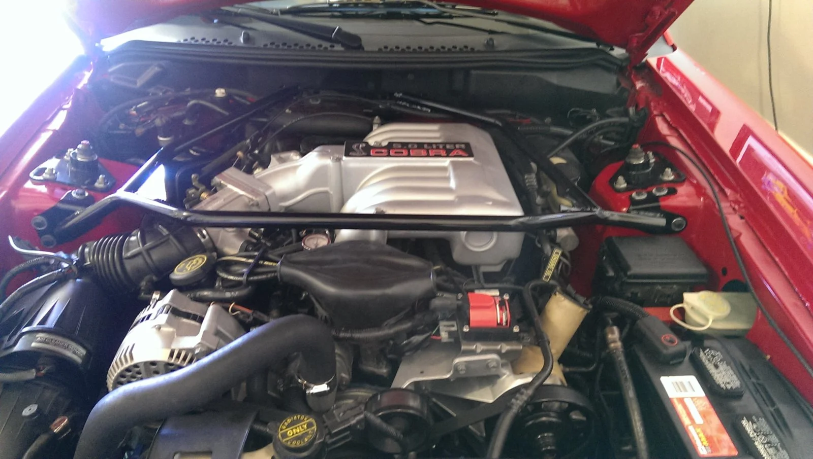

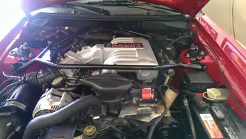

We actually did use the original block, but I don't think it matters much. There is some misconception about the concept of numbers matching cars. I am by no means an expert, but I have had to look into it before. There is no master list of part numbers that identify what part actually went in which car. The experts who evaluate cars for originality have general ideas of what parts could have gone into which cars, and by that logic make a reasaonble guess on whether an engine is original or not. Being that the shortblock from a GT was unchanged from 93'-95' and the same on the Cobra, I doubt anyone could tell.
The idea was to keep the Cobra as original looking as possible. The intake was ported by TMoss, GT40x heads that look real close to stock, etc. We also did some nice touches. We put an original distributor condom on it, it has an OEM battery, We milled the logo off a BBK throttle body, black ignition coil, and I even managed to stuff a 75mm PMAS air meter into the factory filter box.
Kurt

This is the Cobra engine for anyone interested. I think we did go back and put an original appearance black ignition coil on eventually.
Kurt
