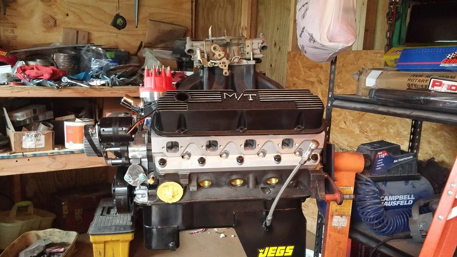

I am currently building a 333 from a 65 289 block with 12.5 to 1 ICON dome pistons Scat crank and rods. Same
heads and intake with a .683-.672 Howards cam.

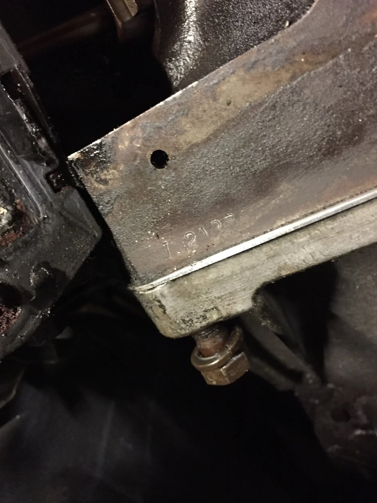

No, but the blocks are vin stamped.

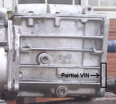

The transmission cases are also vin stamped.
So if originality is really critical to someone those are the things to check.
Example of partial vin on block
And location on t5
