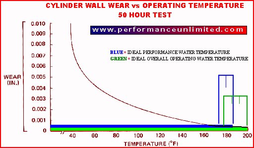

The stock T-stat is the best choice, regardless of injectors/pump.
The 180F stat isn't going to do any damage though...
The stat question comes down to personal preference...
I prefer to keep things hot...
