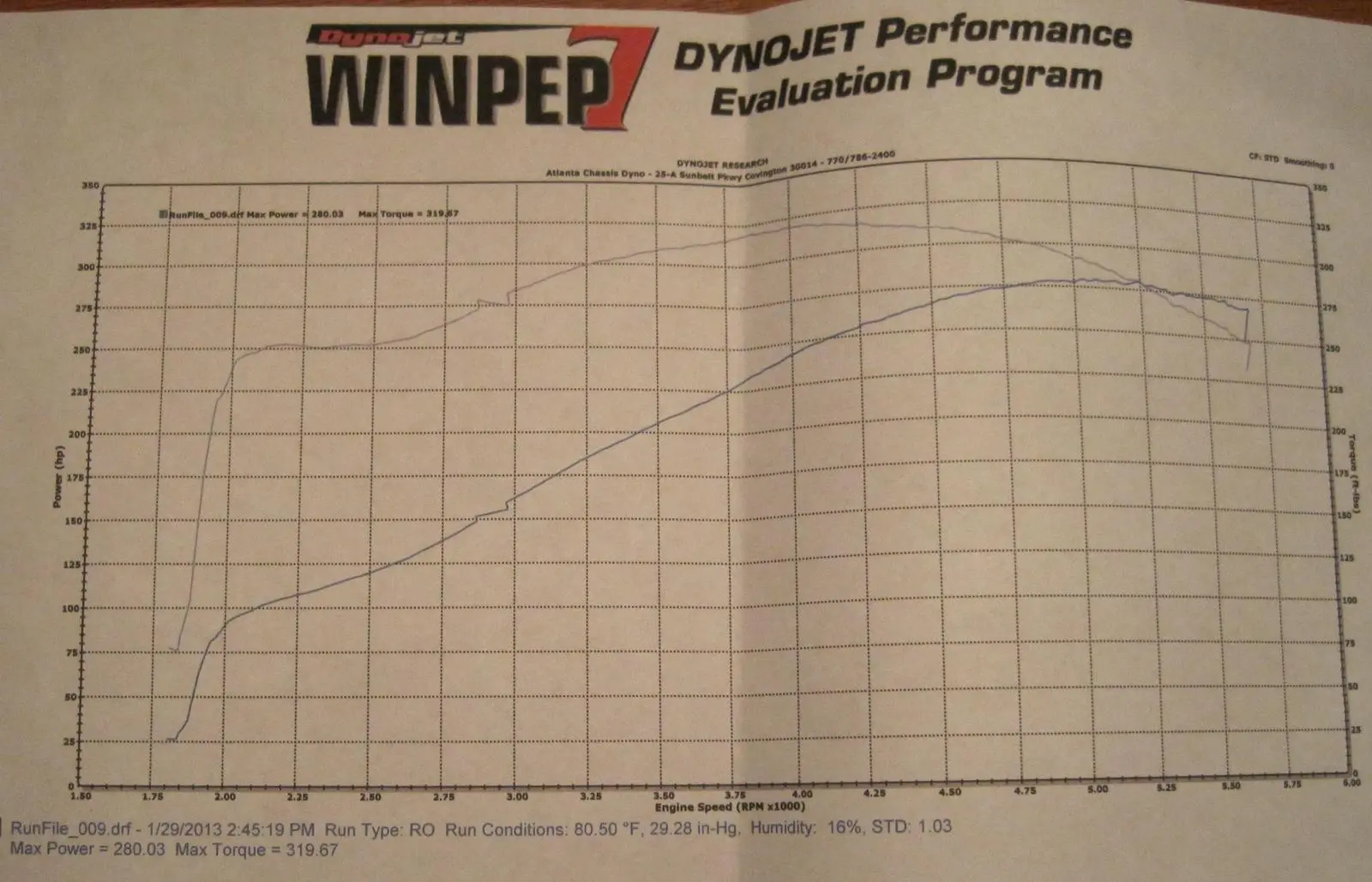

Here's my current output as of right now.
280rwhp - 319rwtrq

Lastly, nice numbers from that combo. I didn't believe it until I notice the GT40s were ported.
