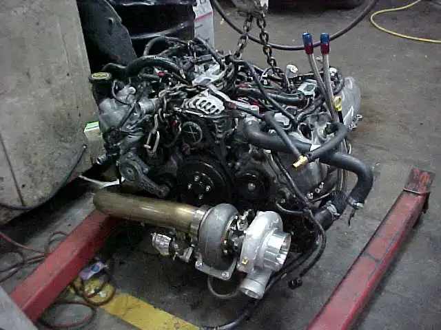

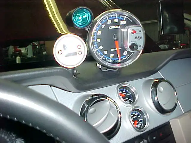

My car had a Prochager P1SC until very recently excellent unit...zero issues. Decided I wanted a lot more and since the P series was not upgradeable to the F series, I decided to go with a turbo. Started with the base 67mm from Powerhouse. Had a stock motor at that time. MAF gave out during dyno, so stopped prematurely, but the rear wheel torque was easily heading in the 500+ range.
Since then car has undergone major rebuild including upgrading turbo to 76mm, reinforcing FB Performance race tranny, a stroker MMR 950 block, adding 2 single KB boost a pumps to the GT500 dual pumps, 95 lb injectors/drivers, and much larger lines and rails. We think the fuel system will still be the weak link but target rear wheel hp and torque is 800 on C16.
The street tune is going to be tame on the minimum 11 lb spring (550 rwhp???), since car has limited street use and I don't street race. Present track plan is to use the digital boost controller to incrementally increase boost per gear. Not been redynoed yet.
