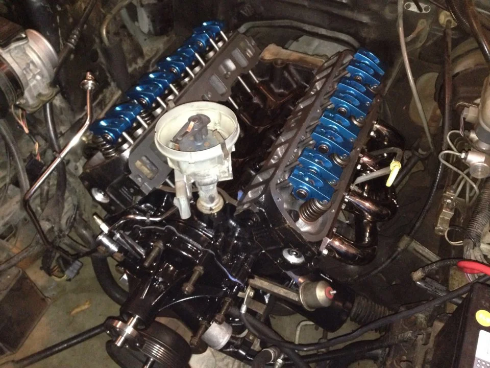

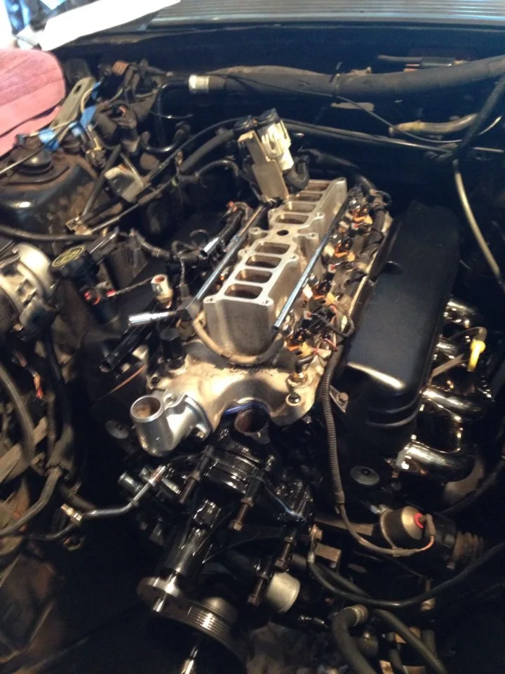

Hey guys. Thanks for the interest. Well I finally got a power steering pulley after bending mine installing it backwards and pulling it back off.
I'm going to install the lower rad hose and measure for the new belt right now. Been reassembling all day today. I deleted the smog pump and added an under drive power steering pulley so I have no idea what length belt to get. So by tonight I should be firing it up and seeing if everything is good. We have fired the car and it ides great. There is a hesitation when reving it up. I'm pretty sure it's a vacuume leak.

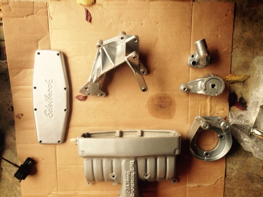

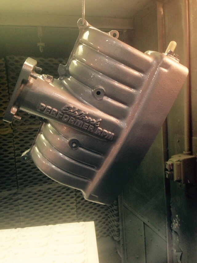

The engine is done and running great. The whistle was the porting access plate on the Edlebrock RPM upper. Sealed it up with some permatex and its gone. Very happy with the power. Had to rebuild my H pipe as it wouldent line up with the header ball seal. Car sounds great and also got my 76 mm BBK MAF sensor on as well a CAI kit. Really made it breath good.
