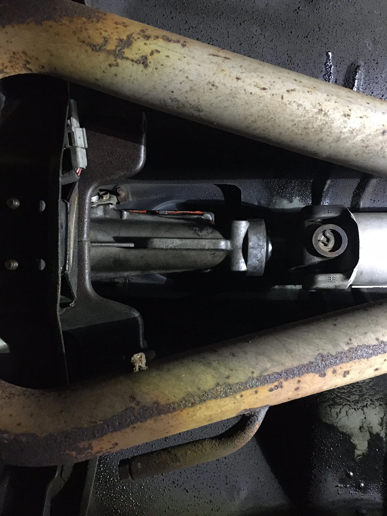

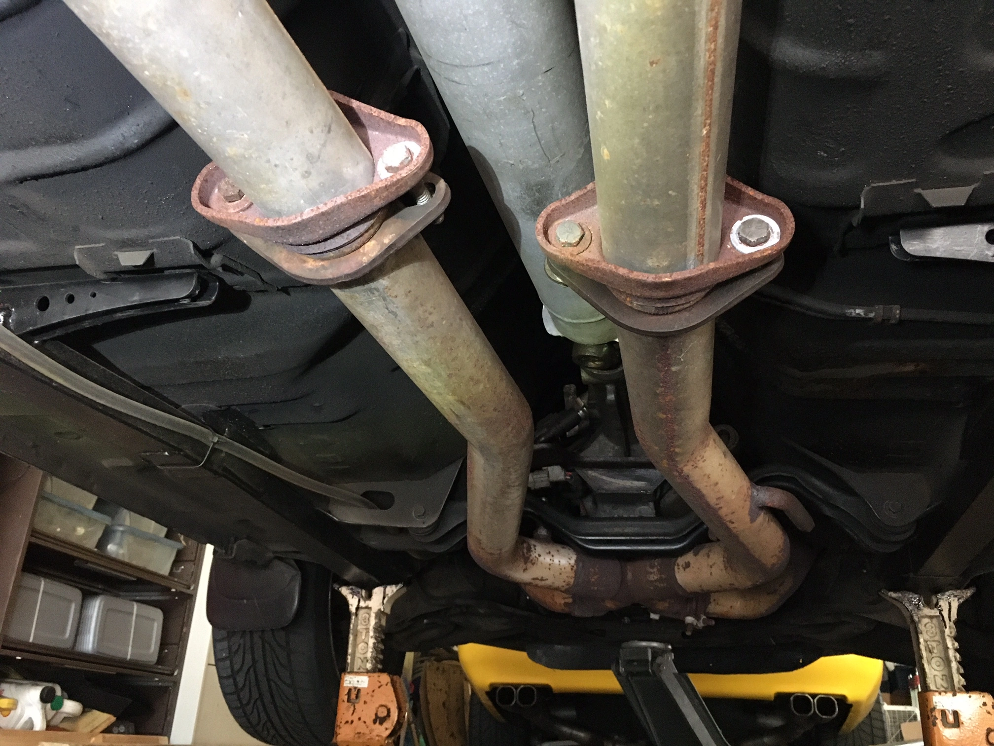

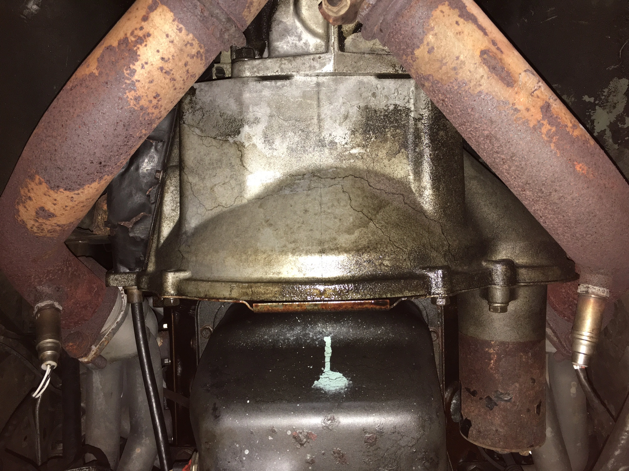

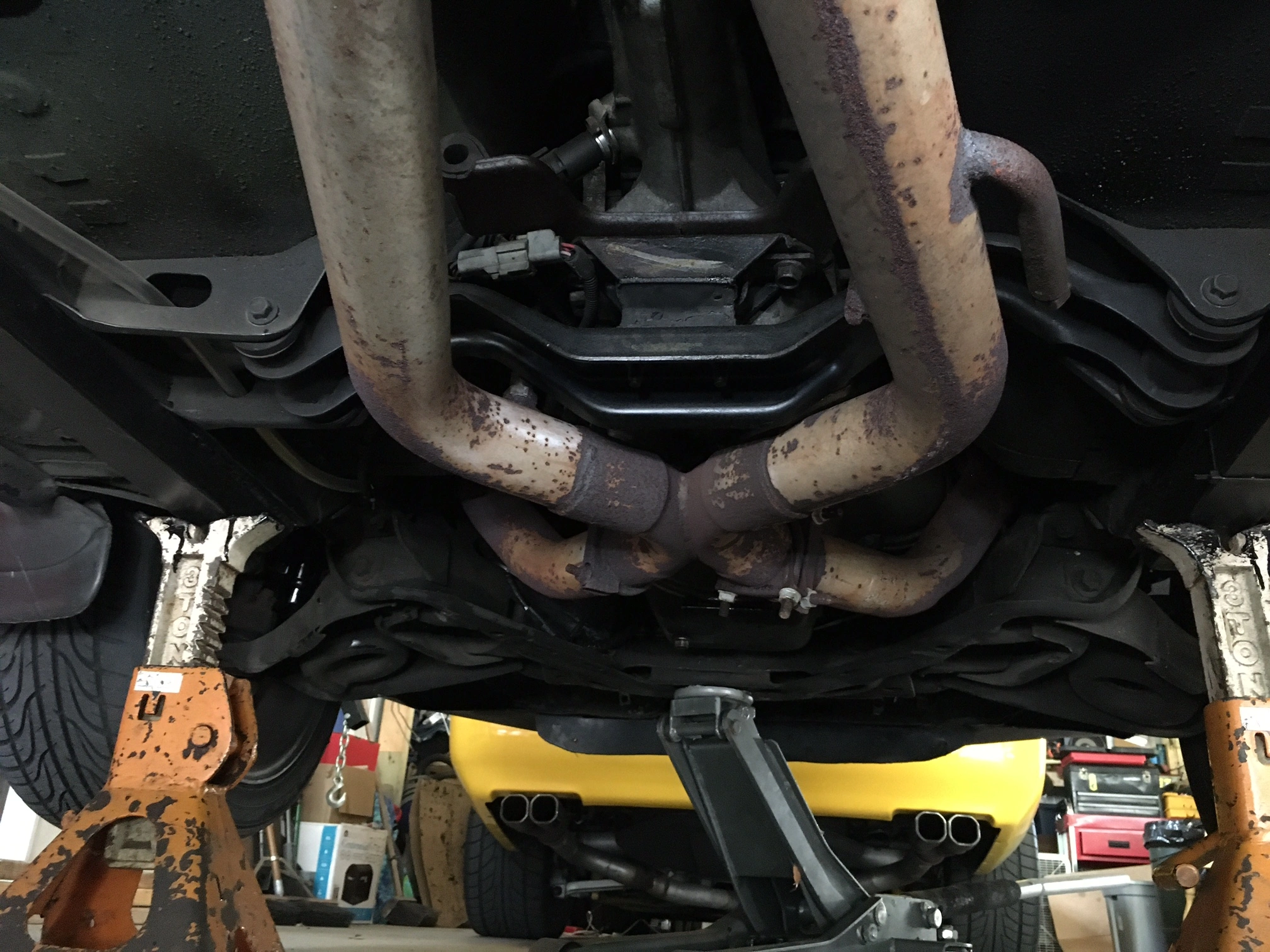

I got the car jacked up good and got under to see where there's room to splice in a pair of Magnaflow 2.5" cats with metallic substrate.
My mid pipe loos like a custom made piece and I've not seen another like it. The X is directly under the gearbox portion of the transmission and I mean totally forward of the trans tail housing. Most other mid pipes I've seen have the X or H fully after the trans tail housing including BBK, Bassani and Pypes.
One option is to put the cats forward of the X which would be nice and close to the engine and would get the cats really hot for good exhaust conversion. However this location is a tight squeeze and would require some custom bending and welding. This would also put the cats forward of my wideband which is not ideal but I could live with.
Option 2 is a simple install which I could even do myself using stainless steel band clamps. The position is aft of the X and directly parallel with the trans tail housing. Lots of room there which is great for heat clearance to any of the components in that area. It's also aft of my wideband which is a plus too. The downside of this position is that its further back from the engine although I don't think its too far back for the cats to work well.
I measured the position of option 2 and its 3 1/2 feet forward of the mufflers and 2 feet aft of the engine. So, is 2 feet aft of the engine too far to get good cat function to kill the stink? If it's not, then option 2 is a no brainer for me.
I attached some pictures but the car was on jackstands. Wider angle pics with the car on a lift would have been better for perspective.
Pic 1 is the forward position. Pic 2 is the aft position. Pic 3 and 4 are wider angle shots for perspective.

I understand that response no problem. I wont argue with you about it. However, I'd still like opinions on if 2 feet aft of the engine (right at the position of the trans tail housing) is close enough to the engine for the cats to work right. Heck, that's closer than the cats on the Bassani mid pipe right?
BTW, this pipe may not be stainless but its rock solid, seriously. And if I'm using band clamps there will be no deforming of the pipe or cat inlets so the cats could always be easily removed and used in other applications or vehicles.
