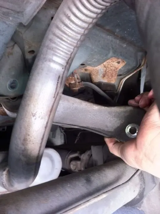

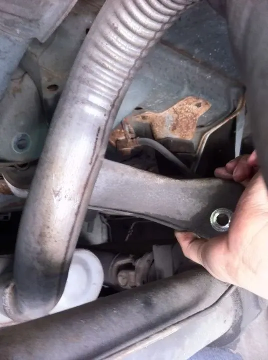

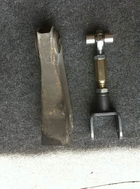

Lower Control arms and upper on driver side. Had issues removing the stock bushing of course. It's in there, like welded on. Rog ordered the removal tool.

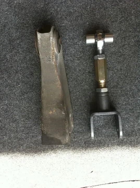

Removal of the stock upper control arm.

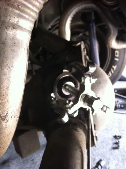

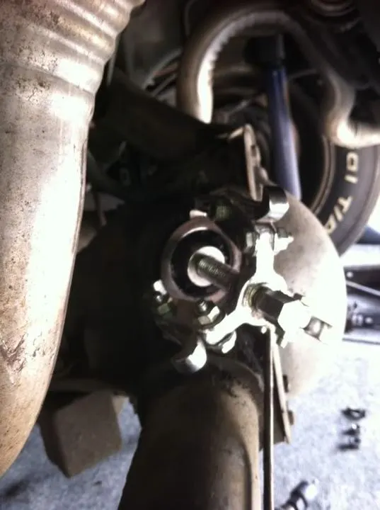

Tried bearing puller.

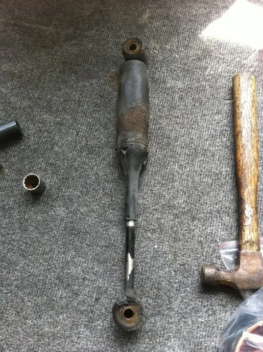

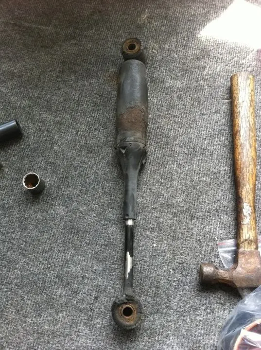

Trashed quad shocks, these are the worse quads I've seen. The bushings were rotted along with everything else.

You guys welding the torque boxes and putting battle boxes in?
If you have the time and inclination, I'd LOVE to see a short writeup/pics on that!
Green's friend who has a race shop will be welding in Sub-Frame connectors and welding around the torque boxes for extra strength. This car hasn't been raced, the torque boxes even after 20 years are in good shape. There is a little surface rust but some extra welds, grinder and paint should do the trick. Of course we will post pics of everything that's done. We would have done more this weekend but those damn stock upper bushings aint coming off with WD40 and a Hammer.
did you drill out the rubber? then take a chisel to the steel incert ?
We hole sawed the rubber bushing out, next up we will cut a notch in the steel insert then chisel. Green bought the upper bushing removal tool for the other side from Maximum Motorsports. Only problem is they didn't offer expedited shipping on the product so we have to wait until that arrives.

I always just caved in the metal part and it would slide right out. My brother used to work in a salvage yards so he taught me all the little "FAST REMOVAL" tricks. He also had a torch to use, but those ears are so thin that he was afraid of cutting through with a torch. Caving it in hasn't failed me yet!
Well, the Maximum Motorsports bushing removal tool is worth its weight in gold. Today we got the spherical bushings and the UCA's installed. Had to quit because the 97* heat was kicking both of our butts. Im sure Vib will post a picture or two later on. I also picked new front swaybar bushings and power steering rack bushings. After the rest of this install is done, I think we will have changed every bushing in the car.
