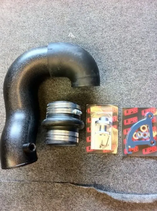

Parts arrived today.
UPR 4" Power Pipe
UPR Clutch Firewall Adjuster
UPR Clutch Quadrant
Thanks Rick91GT!

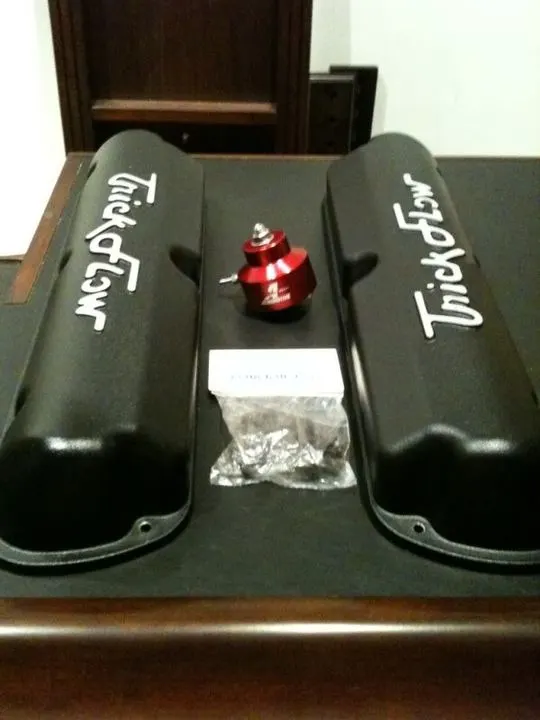

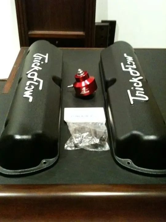

More parts. TFS aluminum black Coated Valve Covers and Aeromotive Fuel Pressure Regulator. Also will have a gauge on the regulator and we will also add Autoeter gauge inside the car.
Rog is going to drill holes in each valve cover for the breathers. Not only is the lip wider but we are using studs and nuts to secure.
