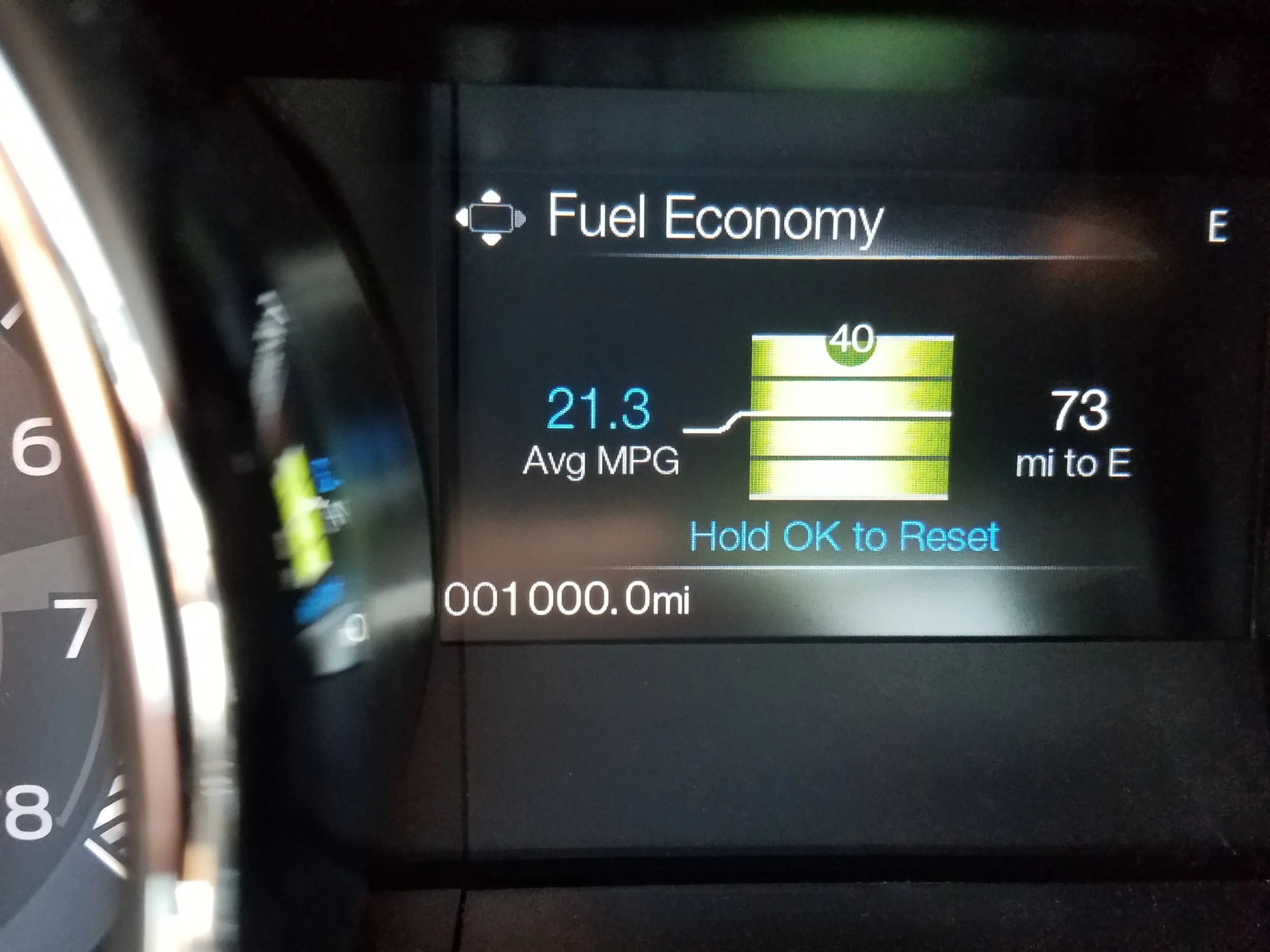

I got 950 miles on mine as of last weekend. Your mileage is better than mine. I'm only clicking off about 19 miles to the gallon.

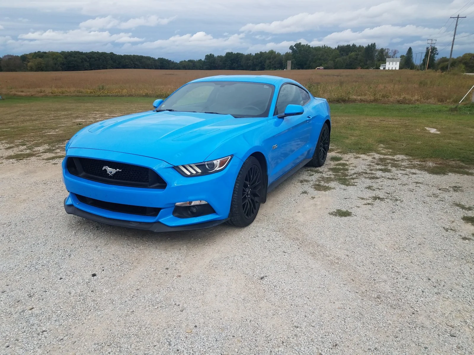

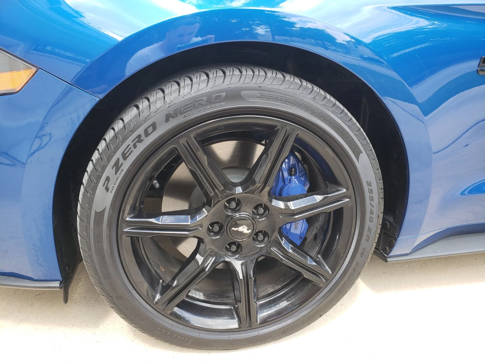

New member here. After owning a 2005 GT in which I sold in 2008 I was finally able to purchase an 18 lightning blue with black accent package last week. 5.0 coyote is way faster than the old 4.6 that's for sure. So far I've only tinted the windows, added a DIY tint kit on all lights, 25mm hubcentric wheel spacers,
and painted the brake calipers.
Nice job! That is gorgeous, congrats on the new 'stang :)

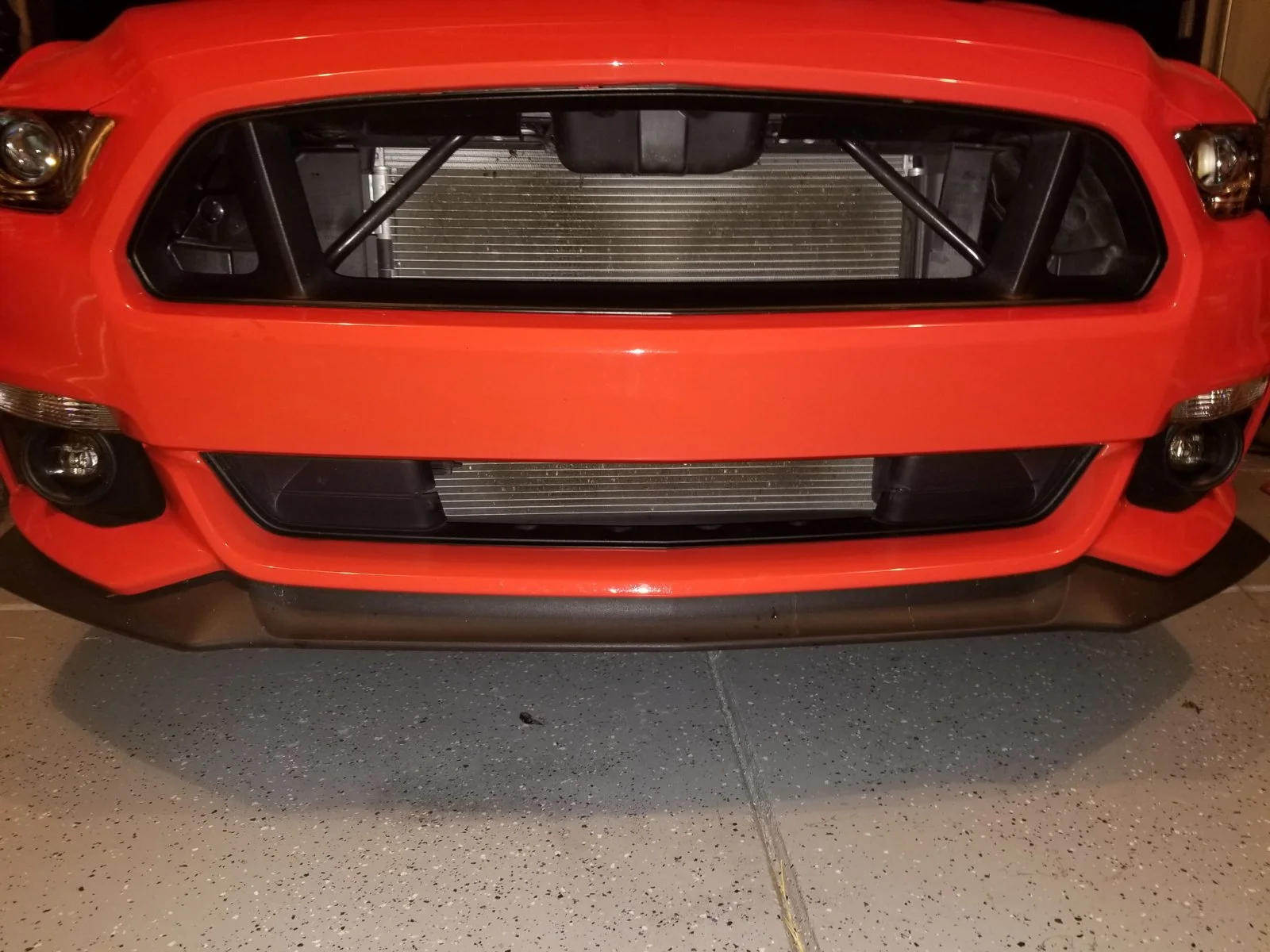

Did a diy grille delete, couldn't see paying for a high dollar or popular version. Plus I have that pita adaptive cruise control. Speaking of that does anyone know what this part is on lower grille passenger side?
