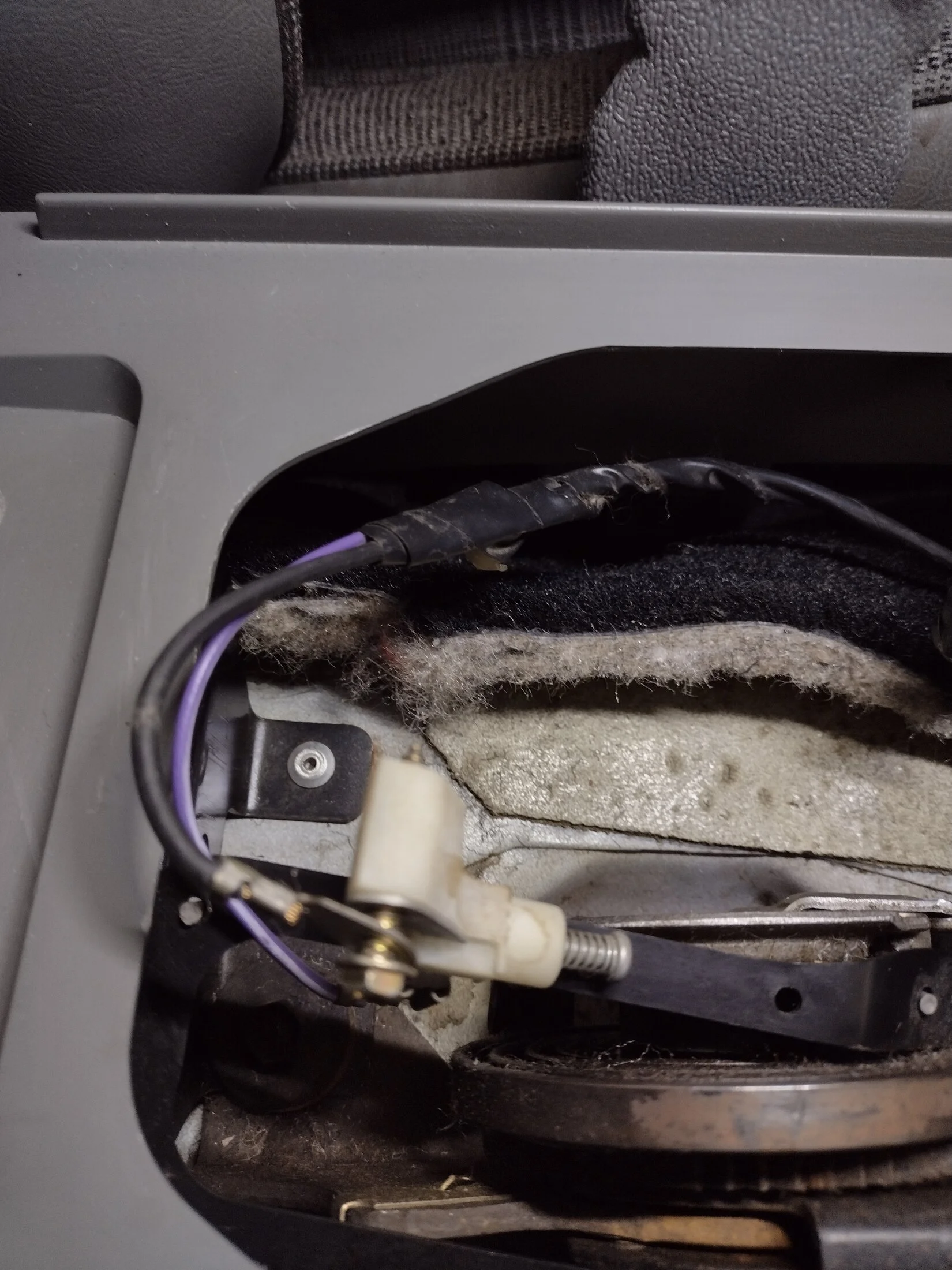

M Monkeybutt2000 Mustang Master Aug 11, 2019 1,387 849 133 Lafayette,IN Apr 3, 2023 #1 Apr 3, 2023 #1 Found this doo-hickey while I had my console removed. It's spring loaded like a door ajar switch. Does it work with the parking brake? It was just hanging out under there.
Mustang5L5 That is…until I whipped out my Bissell Mod Dude Feb 18, 2001 43,229 17,911 224 Massachusetts Apr 3, 2023 #2 Apr 3, 2023 #2 Parking brake switch. It’s what turns the BRAKE light on/off on the dash.
M Monkeybutt2000 Mustang Master Aug 11, 2019 1,387 849 133 Lafayette,IN Apr 4, 2023 #3 Apr 4, 2023 #3 Mustang5L5 said: Parking brake switch. It’s what turns the BRAKE light on/off on the dash. Click to expand... Lol,I figured. Weird it was unattached with the screw still through the eyelet. Give it a good look today figure out where it goes.

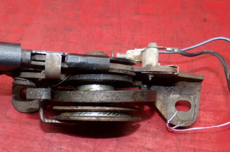

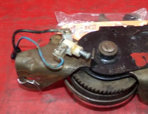

Mustang5L5 That is…until I whipped out my Bissell Mod Dude Feb 18, 2001 43,229 17,911 224 Massachusetts Apr 4, 2023 #4 Apr 4, 2023 #4 Mounts here Reactions: Monkeybutt2000
