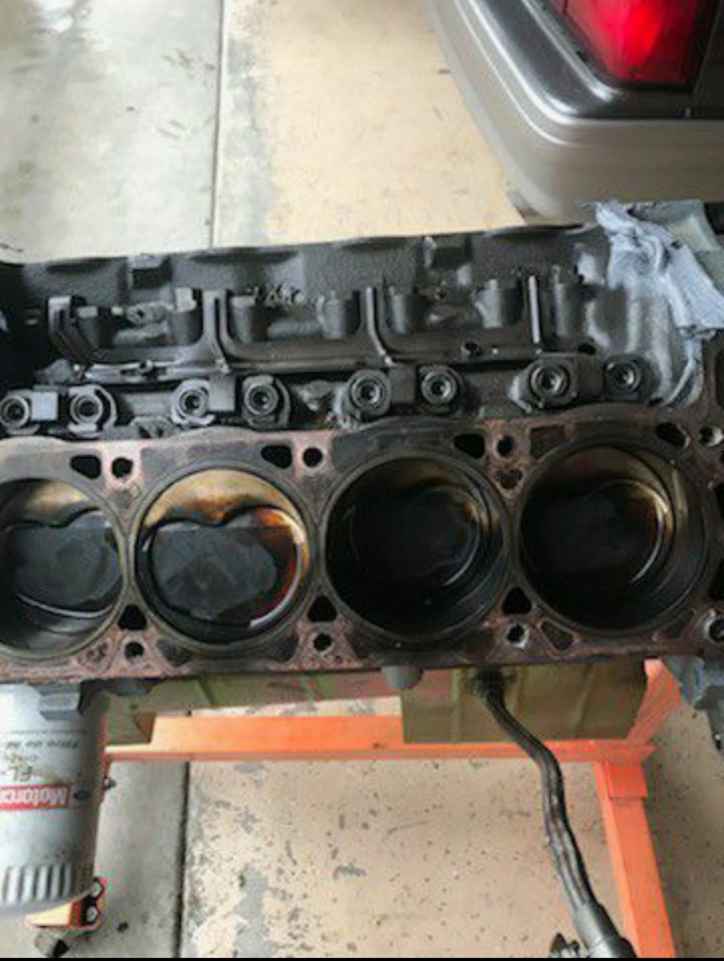

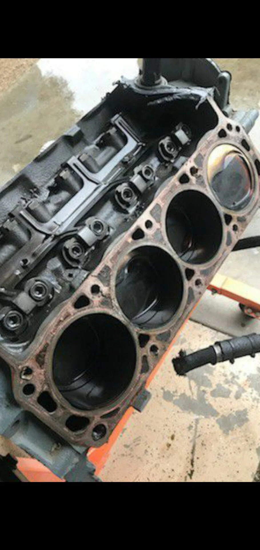

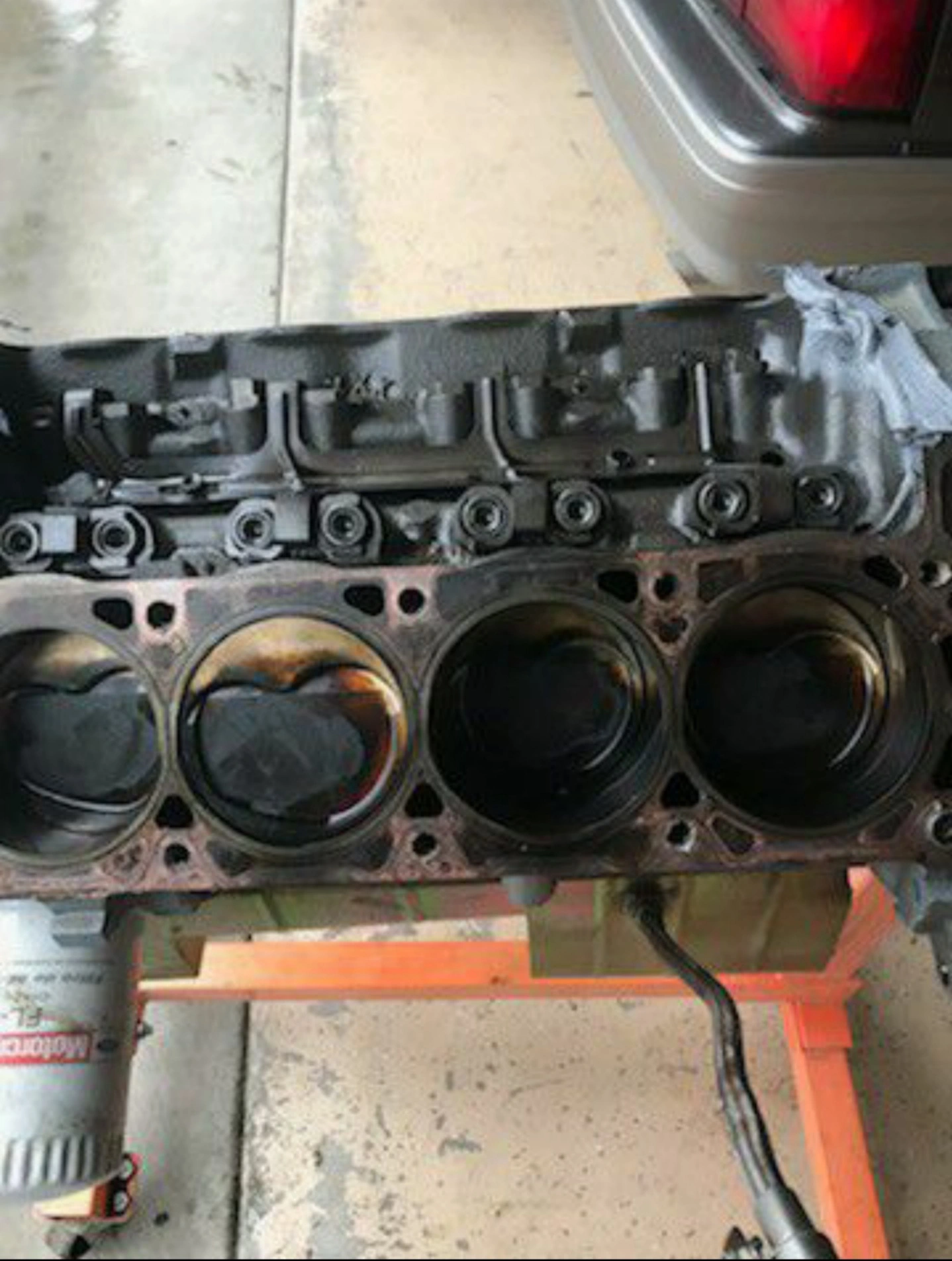

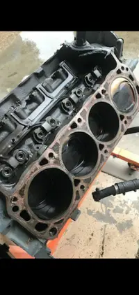

This is it anything look off about it to you?
