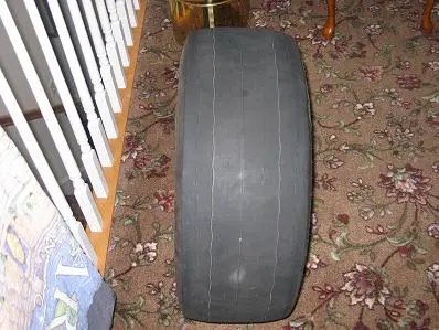

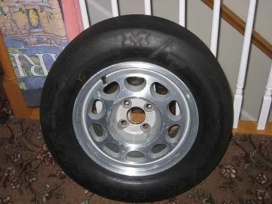

I run HOO-17400 Hoosier Quick Time Pro D.O.T, 26.0x9.5-15LT, on my 15x7 10 holes, and they work great, then even fit dispite the fact I have Eibach sportlines on it, I will try to post a pic tonight.
on those rims, at about 20 psi with my car on the ground they are about 25.5" tall from the ground to top of tire
here some pics
