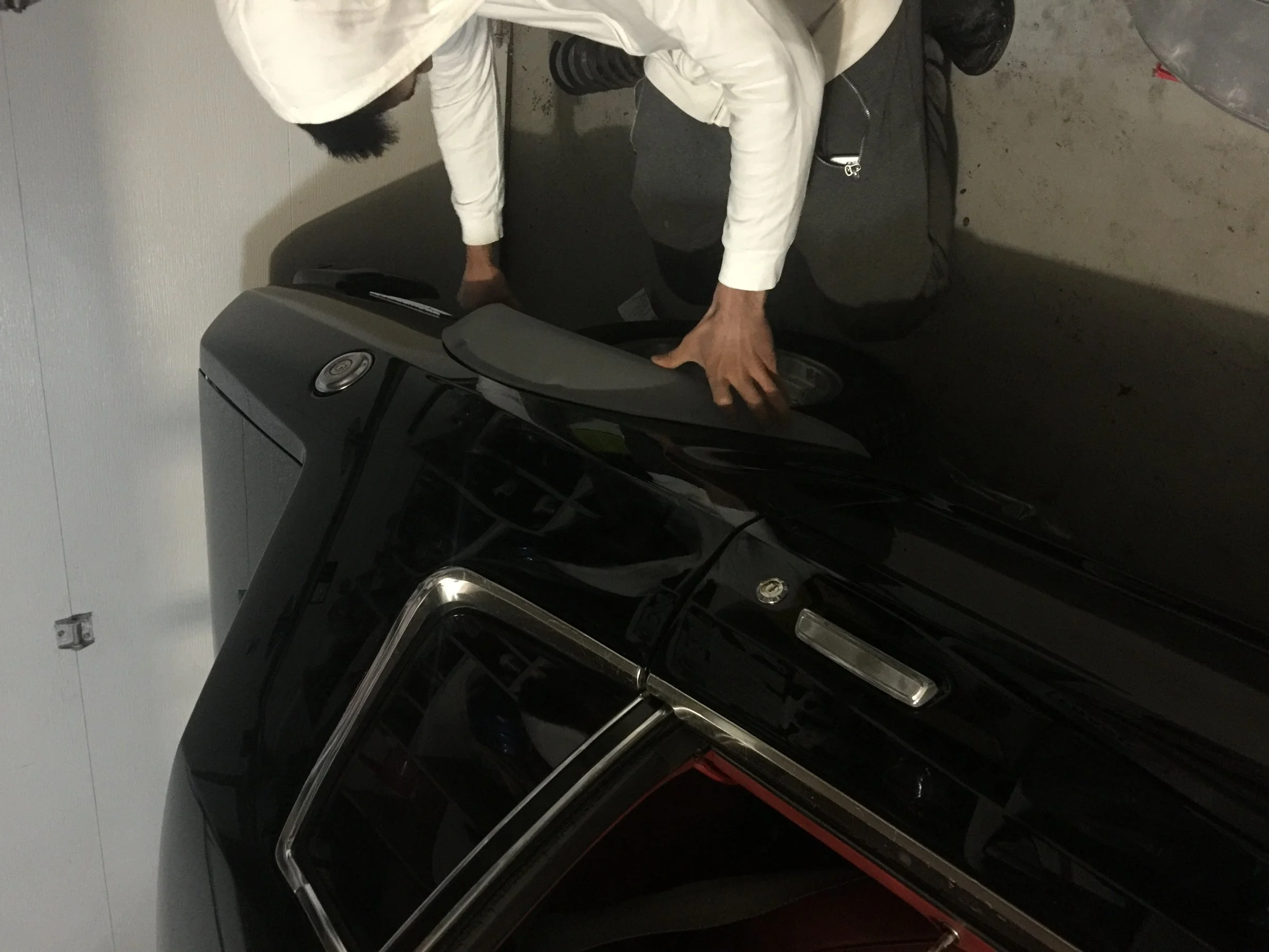

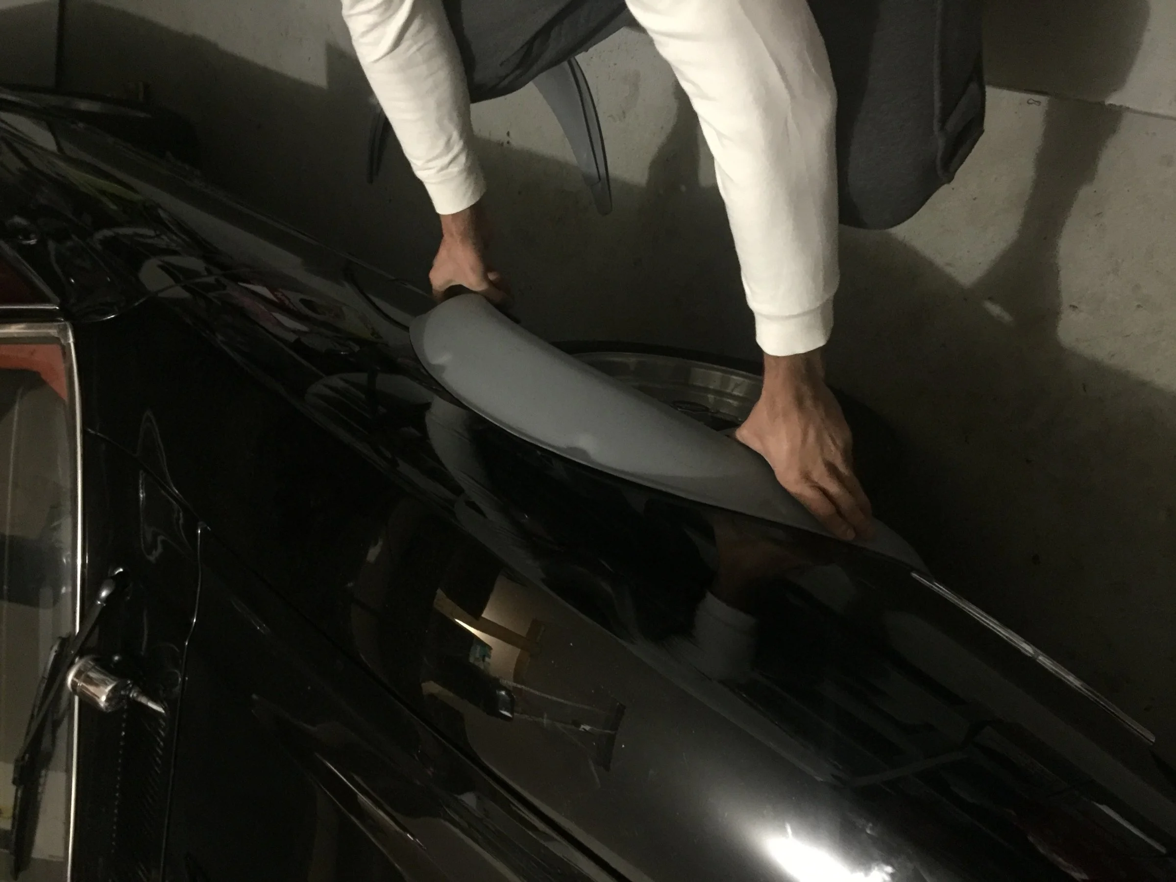

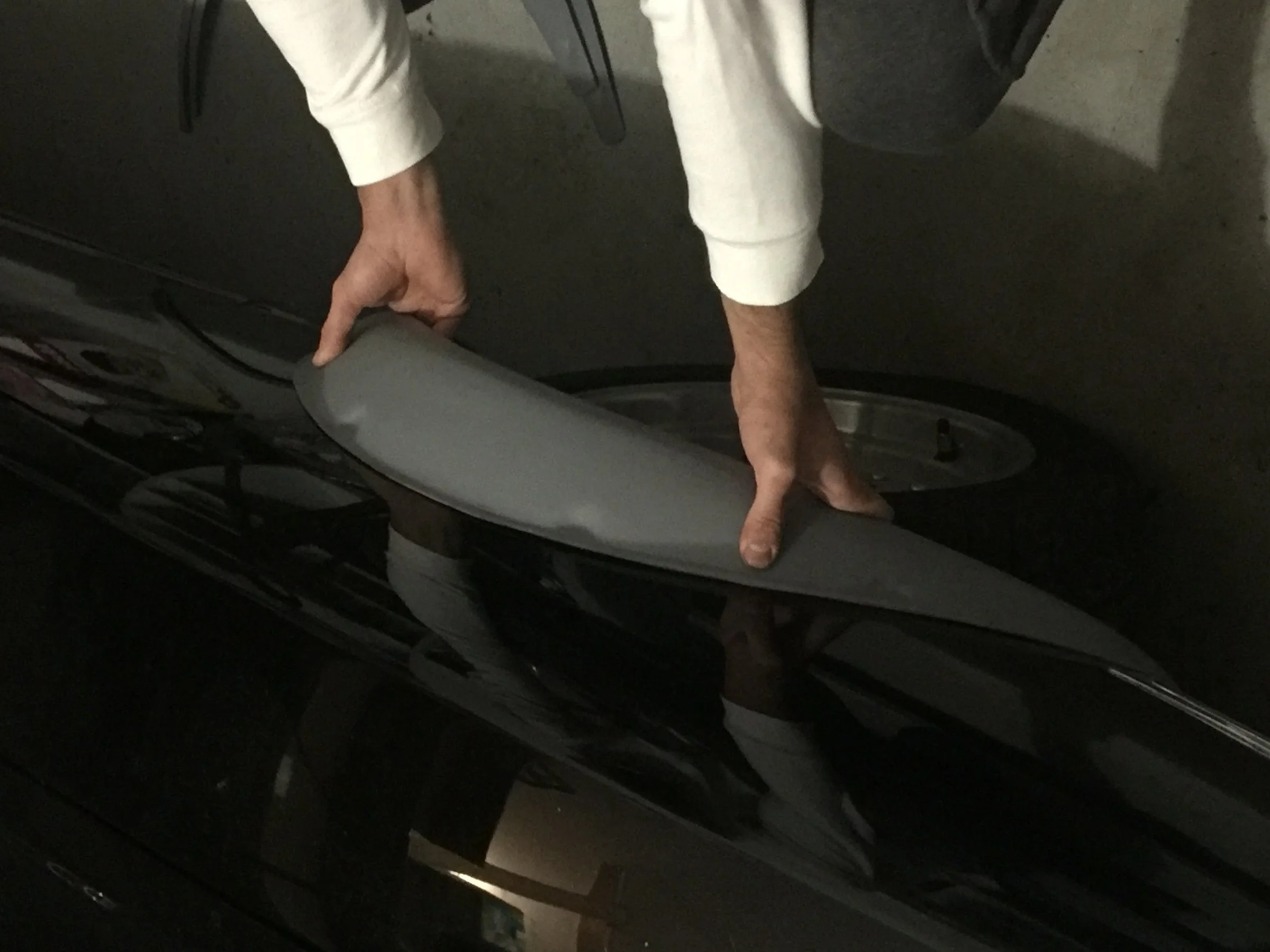

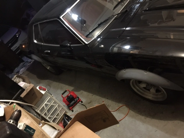

I got a young entrepreneur come by today. Here are pics of what he offers. They are bolted. He comes to my house to install them and charges 450$ installed.
I think I'll give it a try. Would just need to unbolt it and have it painted.

If I can fit as wide of a wheel in front of the car as in back, should I? Or should I make the front narrower than the back. Going 285/35r18 probably in the back.
Car is for fun, must be good for drag racing, lapping and going to daycare. So best all around traction is what I am going for.

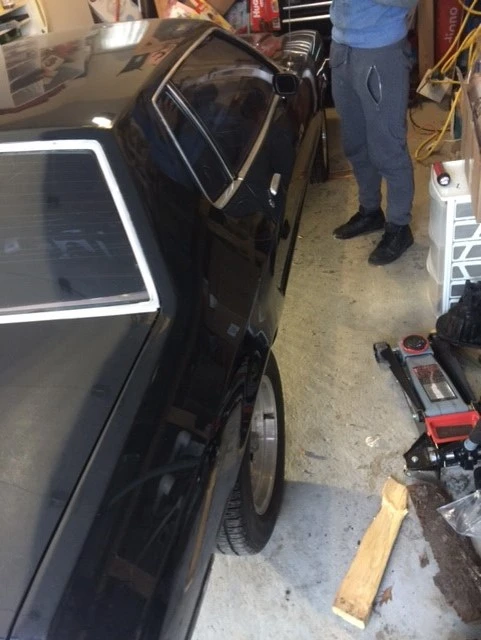

If the rear wheels poke out too much more than the front it'll have handling issues. Wide wheels is alit of work to do correctly.
Flares will add a couple inches but the body will have to be modified to tuck the wheels under full compression. In the front the fender openings will have to be modified to be able to turn that big wheel.
In the rear, the quarters will have to be cut, massaged, and re- welded at the new seam. On the front you could simply cut the fender material away to clear wider tires....but the rear is a different story.
If I went that far I'd tub it, too. So I could fit some 335 or wider tires.
BEFORE
AFTER
They are bolted on, I plan on removing them and sending them to paint with my trunk cover so they can match the paint. It will need a small bead of black calking before I reinstall and a little paint from a can were he cut the fender. I made him cut it conservatively, I can always cut more if needed. The back quarter panel is double, he hammered the back layer over the front one. I like the idea of welding too.

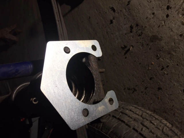

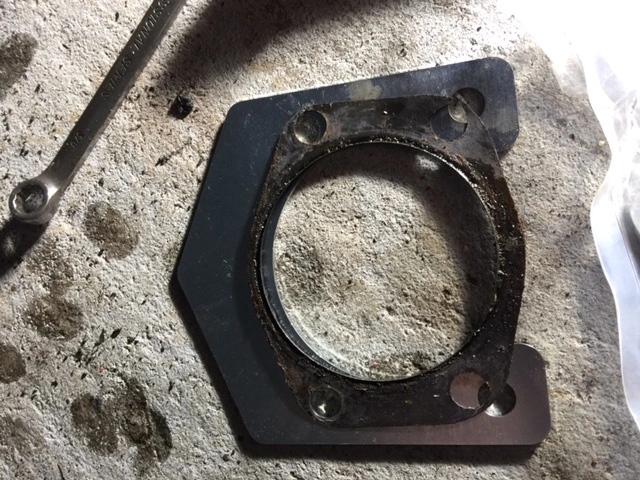

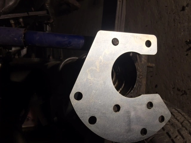

I ordered the rear disc brakes and some long studs. Getting that to fit is my next little project.

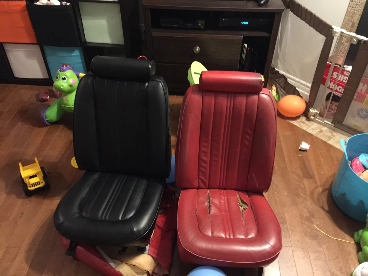

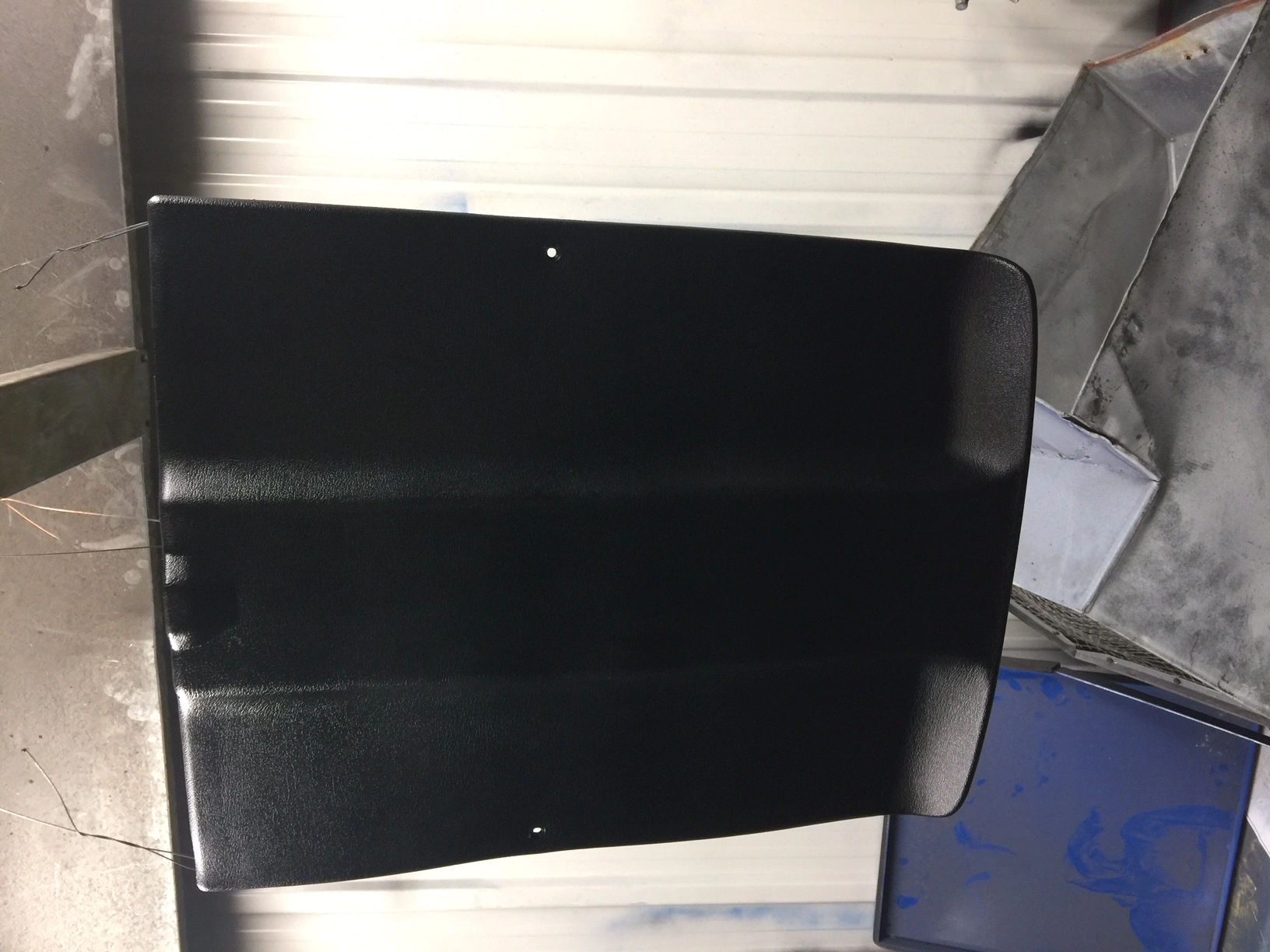

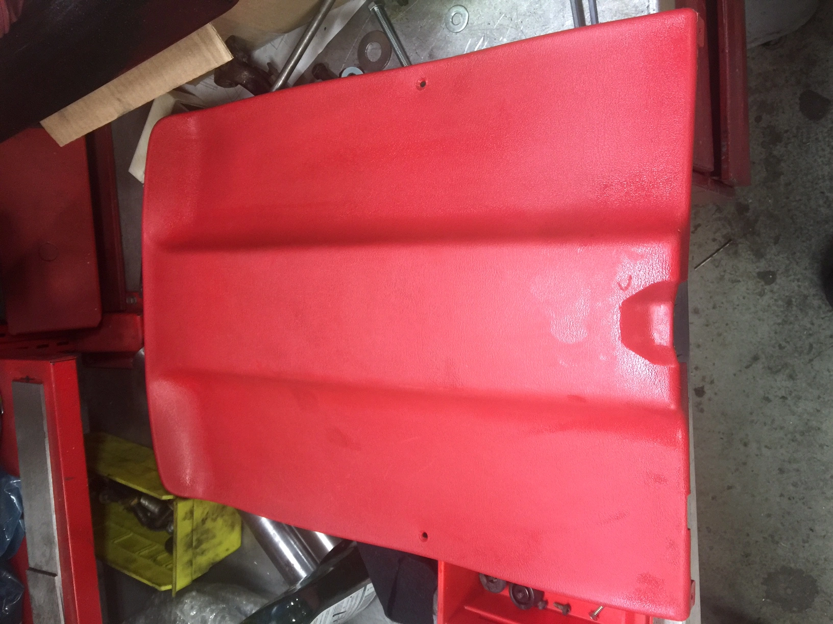

I also finished installing my new seat vinyls, overall I'm real happy with them. I repainted the plastic pieces from red to black using dupli-color paint. I'm happy with the look, but right now it's real easy to scratch and leaves obvious red marks. If I repaint a real obvious part like a door handle or dash I will have to find a black piece to restore.

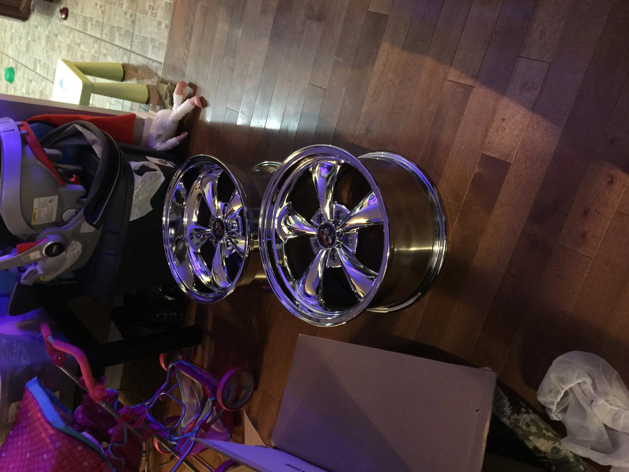

I got my wheels today from oe wheels. Overall, I am not impressed, I had an issue with shipping fees, they were outrageous at 243$US, but when I clicked on calculate taxes and shipping, I figured that the taxes and shipping would be included. Turns out that taxes, brokerage and I don't know what other bs was not included. I had to pay another 250$ when I got the wheels.
I'll take pictures of the wheels later, you can judge for yourself if the look is good or not.

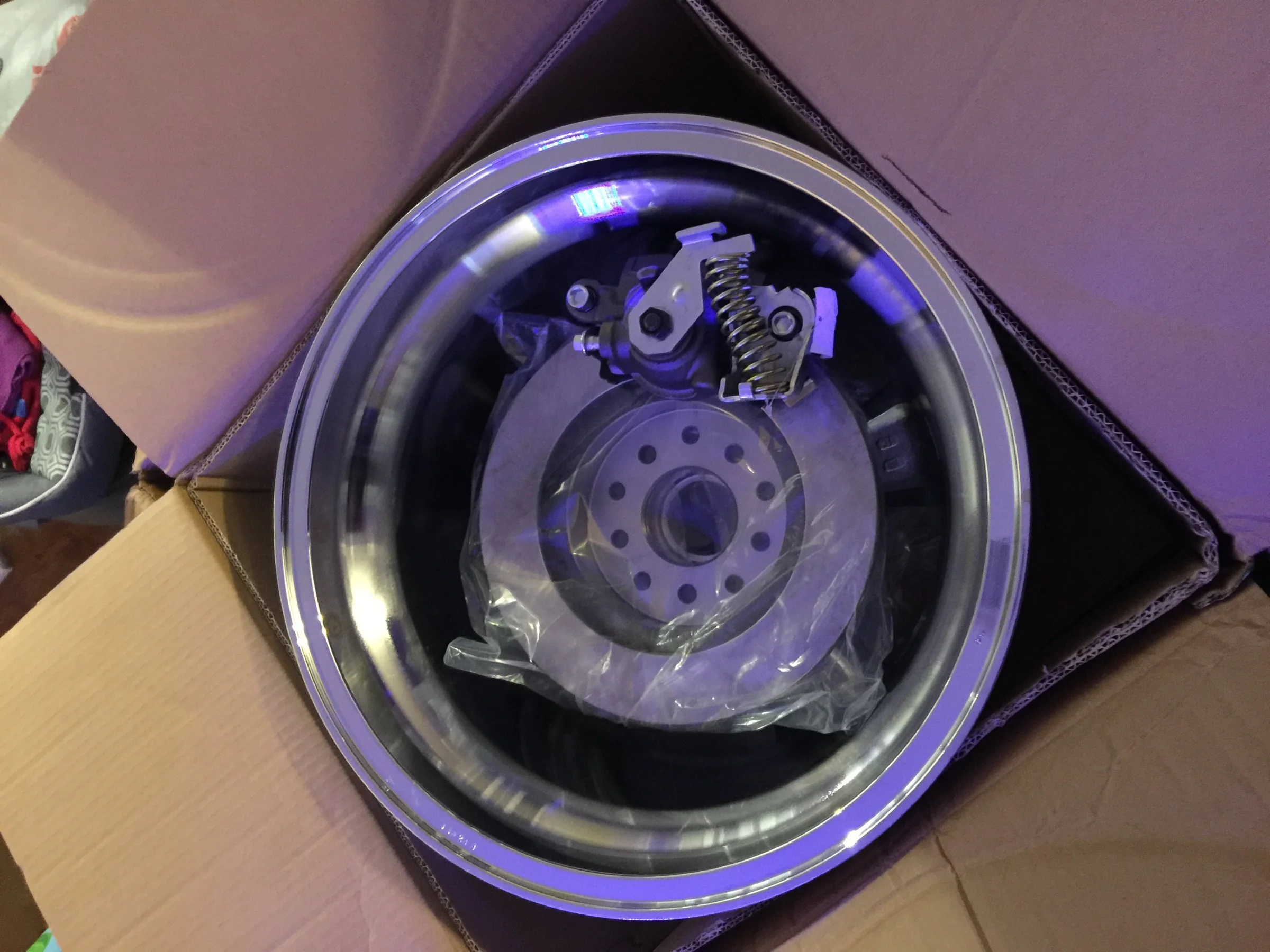

I'm sorry to hear about oewheels as I'd suggested them. I had no idea what Canada shipping / taxes would be or if other states-based suppliers would have been cheaper -- in the U.S. with free shipping it's a pretty good deal. That's good info for other owners from our neighbor to the north so thanks for letting us know. They do look really nice. Were those adapters for the 8" rear? I wonder if the flanges changed between the older 8's and the II. It doesn't look too complex to fill & drill.
