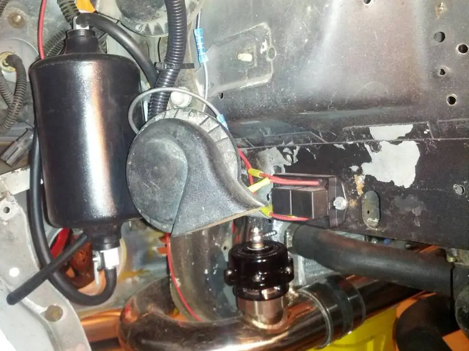

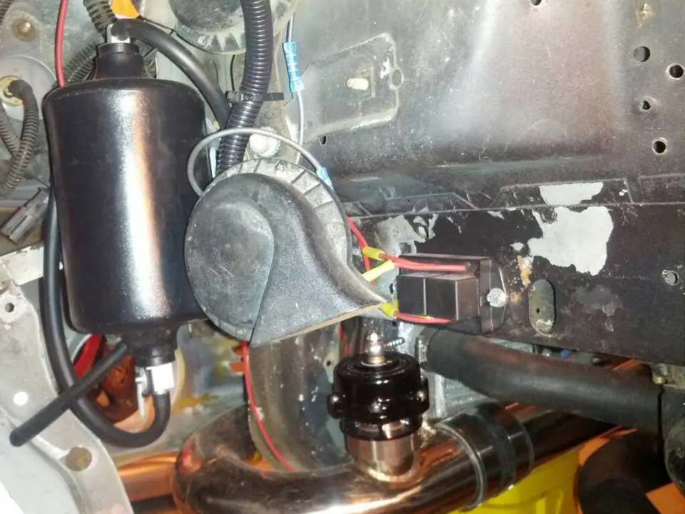

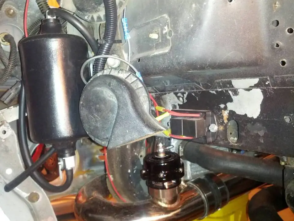

Mine is mounted just above the framerail in the driver's side bumper cover area.
So, its at about half the height of the radiator itself.
Moved it due to supercharger belt clearance issue.
Been that way for about 6 years or so. No issues.
mines an 89, but is tucked up in the fenderwell also
