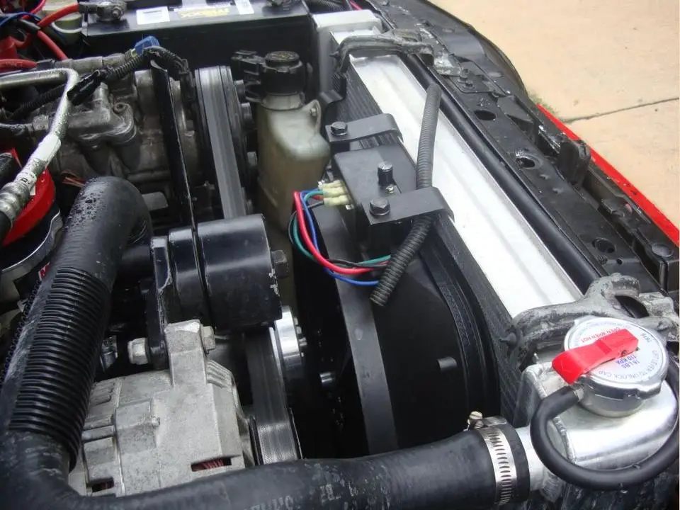

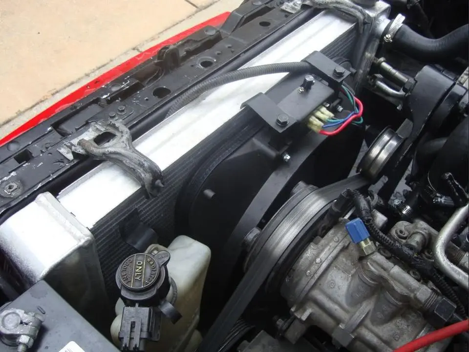

I think the same one
your haveing cooling issues with that setup?
I notice you have 4 wires going into the fan, mine has 3 (has 5 terminals just like yours but only uses 3) is the fan wired to your water temp sensor? mines not, just adjusted at the top knob to turn on at 210degs. Only runs for like 30-60 seconds before shutting off at @ 190-200deg. are you sure its a "puller" fan and not a "pusher"?

91StangGT5.0
Oct 21, 2009
162
17
Dec 26, 2009
#11
  • Dec 26, 2009
  • #11
Yea I put a rag in front of the a/c condenser and it sucks the rag to the condesner. Mine isn't wire like that anymore. I took the green wire out since the fan was installed when I bought the mustang and I found that the a/c clutch was staying on, so I took the wire out until I rewire it.

Tanus said:
oh and if the system has a leak it wont have full pressure causing the boiling point to be much lower
It's been pressure tested. It holds pressure. It doesn't overheat....well I dunno I drive 20-25 miles before it even gets to the "O" and I'm freaked out by then so I stop.
91StangGT5.0
Oct 21, 2009
162
17
Dec 26, 2009
#13
  • Dec 26, 2009
  • #13
The fan has a temp sensor in the module on top where the wires plug in. I don't have it set. It's wired to run on start up and all the time.

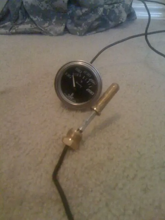

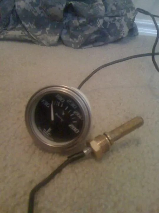

91StangGT5.0
Oct 21, 2009
162
17
Dec 26, 2009
#17
  • Dec 26, 2009
  • #17
here are pics of my gauge....as reference
2000xp8
SN Certified Technician
Aug 8, 2003
8,061
1,646
194
NJ
Dec 26, 2009
#18
  • Dec 26, 2009
  • #18
It's wierd, but you need another nut that's threaded on the inside and on the outside.
The bottom portion is threaded on the outside, and the top is on the inside.
Similar to this one, but i do NOT know if this is the exact fitting, it's been some time for me.
Auto Meter 2263 - Auto Meter Temperature Adapters - Overview - SummitRacing.com
You screw the fitting into the intake, then screw the fitting on the temp sensor into the one you just put on the intake.
I have some of those type of fittings from my electric gauge, but none fit the mechanical gauge.
2000xp8
Aug 8, 2003
8,061
1,646
194
NJ
Dec 26, 2009
#20
  • Dec 26, 2009
  • #20
Here, part number is courtesy of hissing's post a few above.
Auto Meter 2370 - Auto Meter Temperature Adapters - Overview - SummitRacing.com
