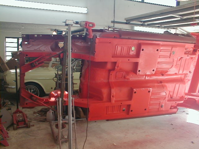

One thing I don't agree is on the frame weakening. As a retired engineer I have looked at that possibility and don't see a way it may happen if done correctly.
Changing the top and quarters it's about the same as if it was a coupe. In fact you can improve on the original coupling of sheet metal to obtain a stronger unibody cage. I did it on my vert frame rails, torque boxes and rockers and you should see it after I comes down from my "TILTLER" jack (Flips the car 90 degrees complete) (see my signature) The doors shut by finger touch and I jack it up after every show I go just to detail the under carriage. Don't get me wrong, I love coupes. Is just that I want the complete stable and enjoy making it in the process.
Buy the way; I have been thinking of the new 67 fastbacks body’s available and may try something early next year based on that kit.
Below is a pic of the "TilTler" Jack
