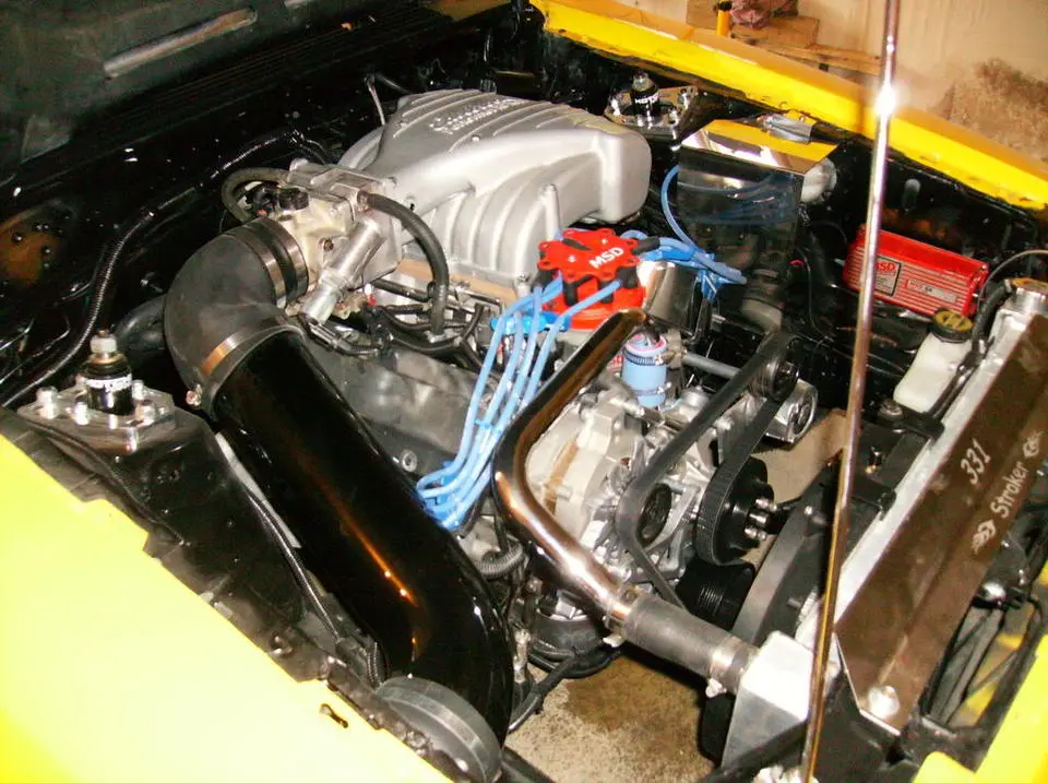

well buds, I have a 331 that I just finished this week and got it running and roadworthy. I have srp pistons/rods etc. , Edelbrock performer heads (1.94) Comp Cams NX264HR nitrous cam, 30lb injectors, paxton reg., 1" TFS spacer, Performer RPM II, 75mm Edelbrock TB/spacer, running with a A9S cpu in an 86 with conversion. I bought a JLT intake instead of the Anderson because my fenderwell looked like swiss chesse as it was and didn't want to make more modifications. As well the JLT came with the matching "big mouth filter" and was a little lower priced - this cost me too much already......
Anyways I have the Pro-M 75mm chrome bullet which is relcoated to the fenderwell. Car idles great and runs hard too. The only problem I have is a hesitation going into 5 gear after stomping on it. Of course the idle will hang too which I need to figure out. Have you had problems like that?

Yep that's the one. I took it out cruise night for the first time last night - oh baby she goes! Some minor details to work out however...........
I bought the JLT from a dealer in Calgary:
http://www.themustangshop.ca/product/302277/300357
It will work on 86-93 5.0's.
It was easy to put together but you will be required to trim the hole where the air box goes into fenderwell as it is one BIG pipe! took only 5 minutes to trim it up right. And yes the filter goes in the fenderwell pretty far as well. The MAC I had was at the very top of the fender which would be best if you are worried about weather.
