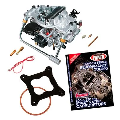

This:
This is a good out of the box carburetor, that has really strong support from Summit.
This used to be a Holley design, but the hard heads wouldn't buy it so they (Holley) sold it to Summit.
The jets are accessed through the top, so no draining of fuel is required for a jet change, there are center hung floats like all the good carbs have, it has an electric choke, fuel level sight glasses on each bowl. Adjustable, and or tunable airbleeds and the carb is all aluminum. It is very close to good right out of the box, but takes standard Holley junk to tune it should you need to.
I have one of these on my junker. I have only had to change the jets once, and I only did that to lean it out so that it would work on my tiny assed engine. I get 23 MPG at 73 MPH w/ this thing it starts after one pat of the throttle after sitting all night, and fires straight off after restarting it hot. The best part,...is that it cost 259.00.

Mike I bought one of those for the old chevy beater truck I sold last weekend. Got it on sale shipped to the door for $239 bucks. Pulled it ot of the box, dropped it on, ran like a champ. Damn fine little carb, I may put one on my son's 4cyl to v8 swap car if I can't scratch up efi parts.
