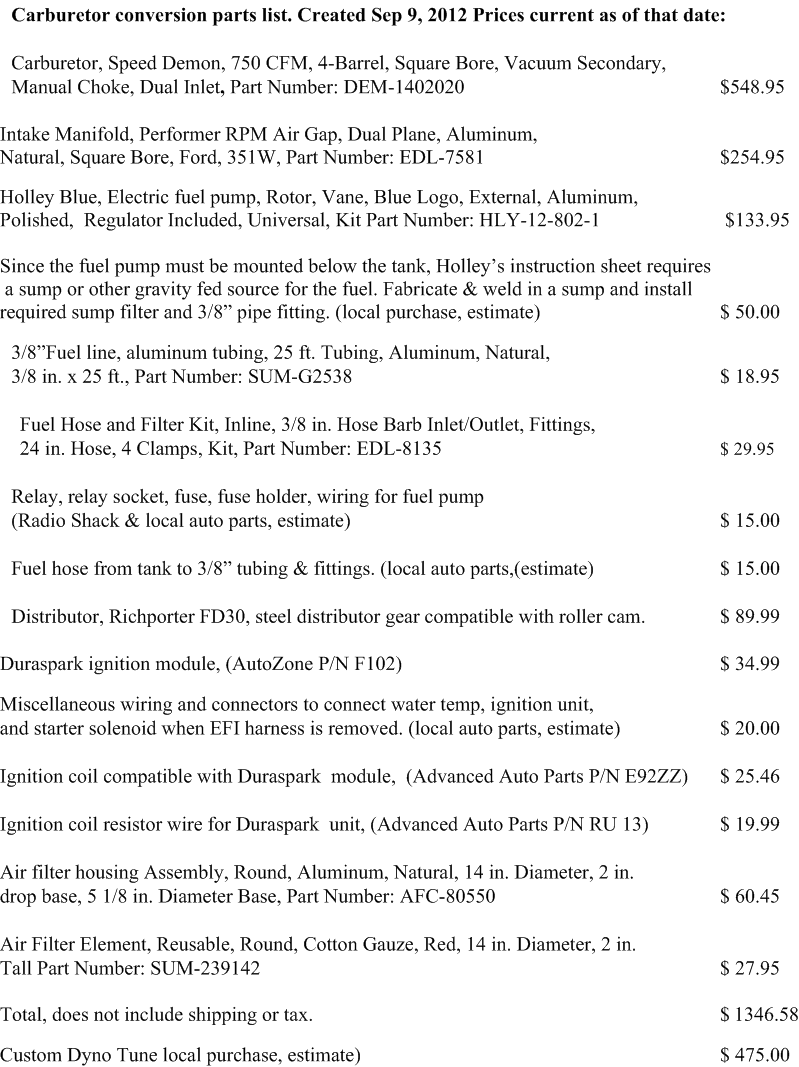

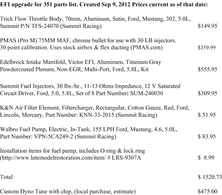

How much does it cost to add the 70mm TB, the 30 lb injectors, and the 80mm MAF? How much did the intake cost on the "hot HCI" in the stated example ? Will the stock intank pump support the power that the new combo is capable of producing, and how much will it cost to replace it if it don't? Lastly,.....if I decided to kick it up a notch, or drop it back one for better fuel mileage,....will the $125.00 little black box in the above example require I revisit the red headed kid w/ braces for a retune?
madmike1157 You asked to it, here is is. All the parts are new purchased from the same vendor where possible. No eBay, no used parts, no swaps with your buddy who had a shed full of parts his wife told him to get rid of. This makes for an apples to apples comparison.
The custom dyno tune is listed as an option, since both plans will run reasonalbly well without it. Mass Air EFI has a fairly wide tolerance range for changes and modifications since it has the ablity to "adaptively learn" changes in sensors and configuration. A revist to the "Dyno Guy" shouldn't be needed unless drastic changes are made in the configuration.
Parts supplier is Summit Racing unless otherwise listed:
carburetor-conversion-parts-list-gif.74045
efi-upgrade-for-351-parts-list-gif.74046
[The difference is $174.15 Given the increased fuel efficiency of EFI, that would easily be recovered by saving 50 gallons of gas in a 2 year period.
Ah, but the beauty is you don't need a $475 dyno session to tune a carb as long as you own a flathead screwdriver and a 10mm socket and invest about 10 minutes of reading into learning how to read spark plugs. You also don't need to spend $600 on a Demon when you can get a Holley 650dp for ~$350. Also i would opt for a Stealth intake which will save you nearly another $100 and is a better intake than the Air Gap. That list is made to be conveniently close in price, when reality is much much different. I bet i could easily and *safely* shave at least $1000 off that list and still do the swap "right".

It's easier than it sounds, if you tune it yourself and save the $475, the $250 less on a Holley, another $90 off the intake, that's already over $800. Also it's very simple to make your own pickup to replace the EFI pump instead of spending all that cash on a sump. It can be done safely and reliably, or you could just swap the tank out for an '85 spec tank and skip a bunch of those little fees. I'd also opt for a mechanical pump and swap over the timing cover, but that's personal preference. Plus, instead of going the Duraspark route, you could spend $145 on a HEI distributor, which will save you another $35 for the Duraspark and shave a considerable amount off the wiring bill at the same time. So, add all that up and i'd be damn near right at the $1000 mark. :nice:
This is an open invitation to do a like comparison. We all would benefit if you can go off and create a Bill of Materials from reliable vendors that shows savings over what was listed. Until that happens, it's just talk...
One thing that puzzles me is that there is a $300 difference between carb and EFI intakes. Granted the EFI intakes use a Tuned Runner design to get more torque, but there isn't $300 more engineering and aluminum in an EFI intake manifold.
