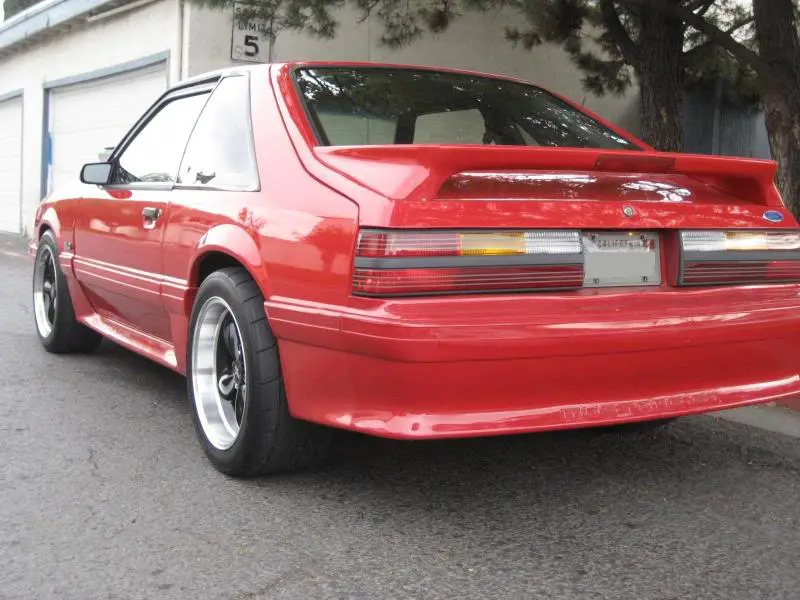

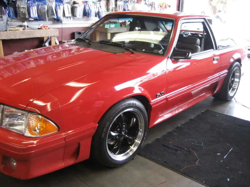

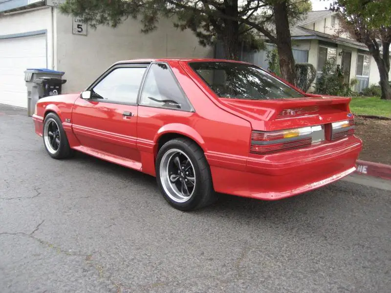

OK folks, I have recently converted my 93 gt to five lug. I am using stock length axles with drag launch springs. Quads have been removed. Anyone know how wide of 17 I can put on the 2001 bullit rims? Im looking for anyone that has got something a bit fatter on the rear.

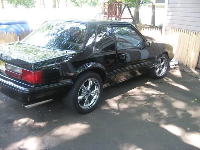

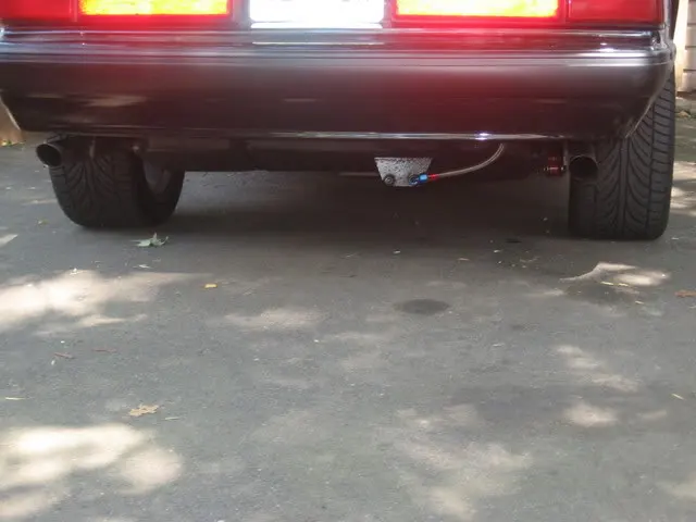

yeah 315/35/17 nittos and still have the quad shock just flip it, with 1/4 inch spacers, fits fine no rubs....

Anyway, 8" wide rim, recommended tire size is 245/45/17. You could put 255's on there.
275;s can be mounted on the rim as well, but there is sidewall bulge and it's not recommended.
For a fox, i'd stick to 245's...or maybe 255's out back
I have actually found a place that sell Bullitt Wheels in a 17x9 with 6.42" Backspace which is perfect for a 275 Rear, the only problem is they only come in Black. I have been thinking of picking up a pair and getting them painted to match my Fronts.
