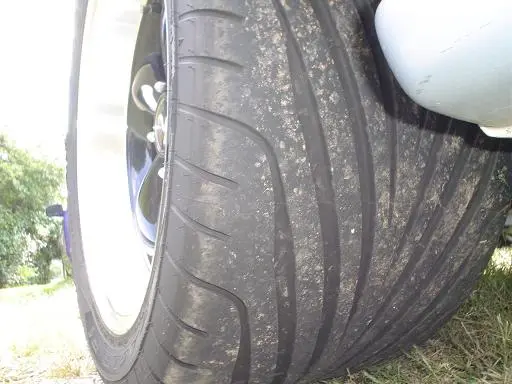

I'm running that exact size. Fits good. You'll have to flip the quad shocks (or remove them). Also, depending on what tails you're running, you may have to relocate them, dump them (me :D ), or go with side exits. Depending on what brand tire it is, you may have to "roll" the inner fender lip as well (me again). An example: "Goodyear Eagle F1 GS-D3's are wider than Nitto DR's". Here are mine.....

They fit on mine without messing with the Quad shocks or tailpipes. Go with them!! I thought I might include this funny picture comparing tire sizes.............. :hail2:

Yeah, but those look like Sumitomo HTRZ's. If so, my buddy has them & he didn't HAVE TO either. Mine HAD TO BE FLIPPED. No way around it. Like I said, different tire brands are different. The F1's I have are over 13" wide.... but I don't know exactly. I was just giving a "heads up" (not knowing what he'll go with).

Ahh gotcha! I think the sumitomo's are around 11" or so wide. Have fun with 315s either way.......... :)
Mine fit, I run a 1/4" spacer, puts the edge of the rim out to the perfect location. With the nitto Drags my quad shocks clear by a MILE. They even clear my 3" tips. You can see in the 2nd pic how well the edge of the tire sits compared to the fender.
