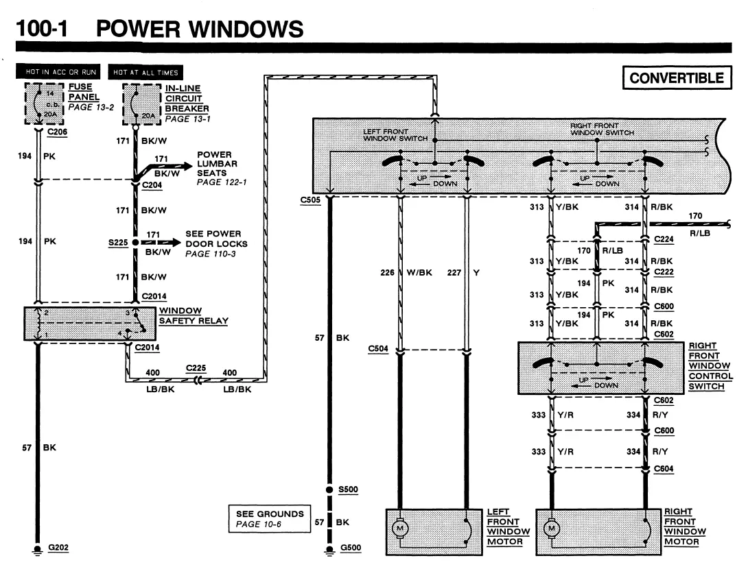

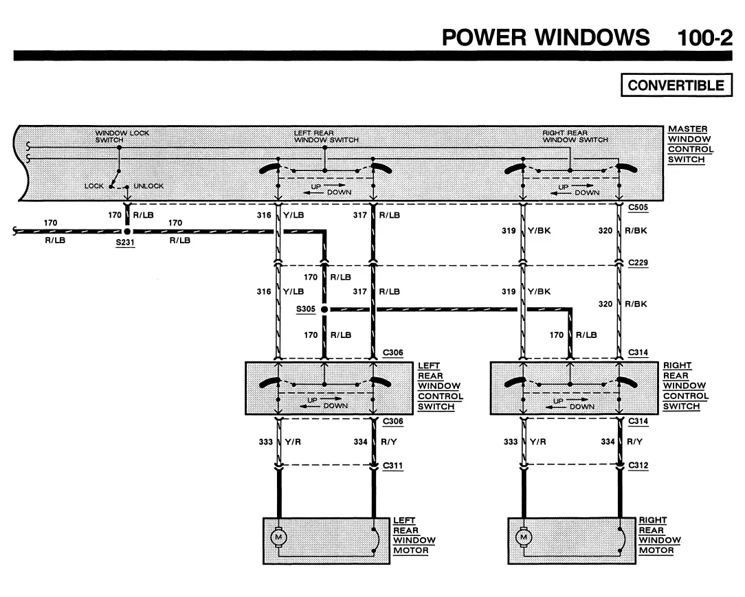

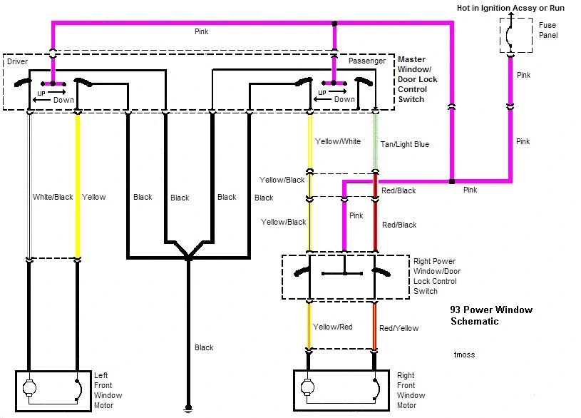

Just in case someone searches this the 1993 cars are one year only on the power window wiring. My copy of the 1993 EVTM shows the ground for the power widows and lock is in the middle of the driver door on a 93 regardless of hardtop or vert. Would think that would be the same on the 87-92's but I cannot confirm.
Diagrams courtesy of Tmoss & Stang&2birds:
1993 Windows:
1987-1992 Windows:
