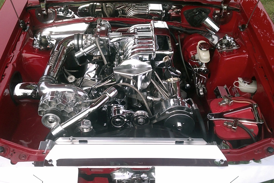

Pardon the dust and beat-up paint. It's going in for some engine bay paint touch-up in the spring.

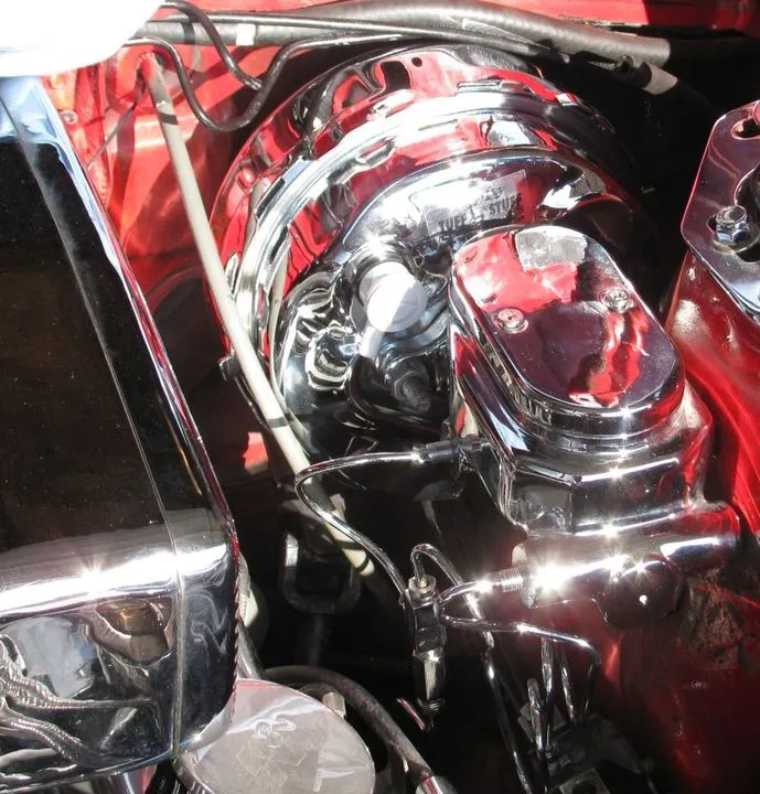

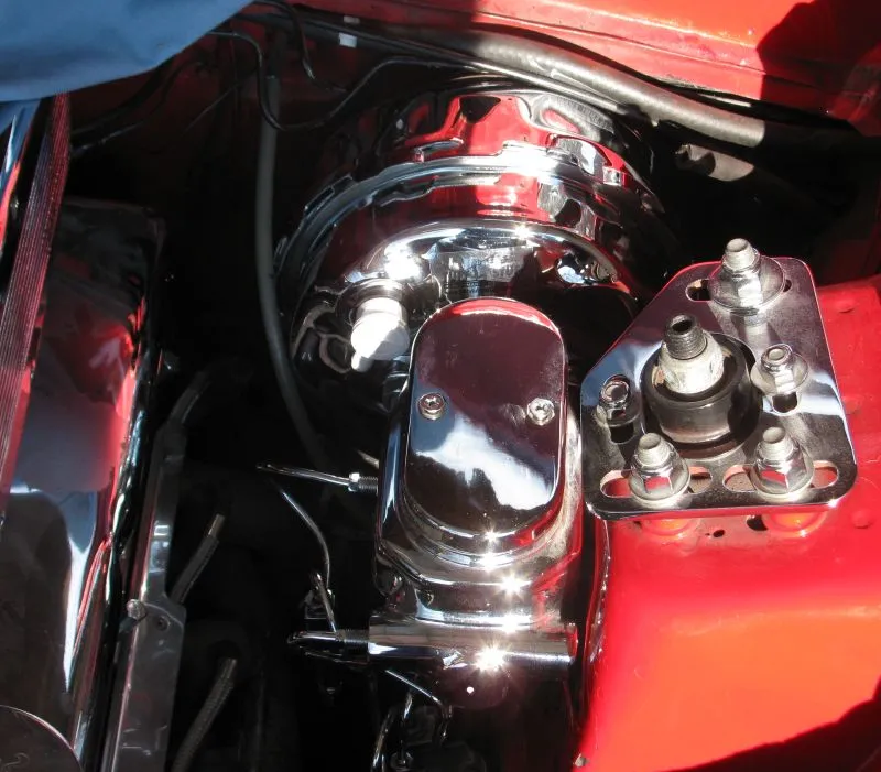

They've been chromed for a few years along w/the master cylinder, but the booster is a new addition (my stocker was painted body color) and I replaced the SN95 master cylinder with that one-piece street rod style unit. Here's what it looked like before:
Another stretch of no progress worth showing, but I've got the brake booster, pedal assy., and all the under-dash stuff back in place. No large task, but with my sparse availability lately it's good.

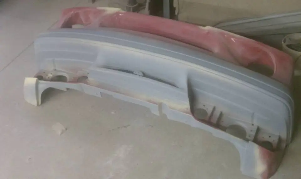

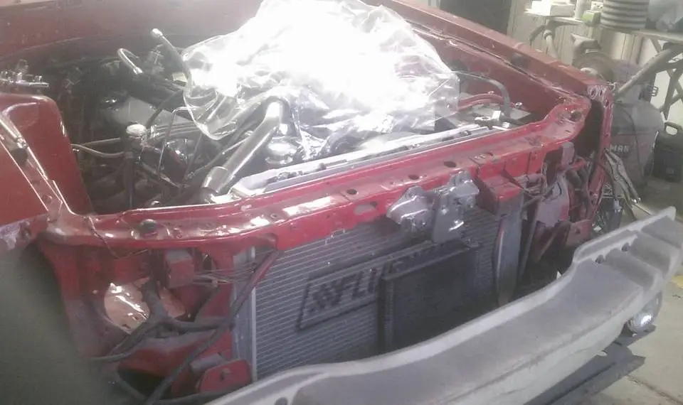

Paint work is underway. The front of the hood has always rubbed against my front bumper, so first up they're fitting it better so that no longer happens. Once done, the front bumper comes off for a repaint. While that's off I'll probably be freshening up a bunch of harnesses, brackets, etc. that are mostly hidden by it. Since it'll be off it will be a good opportunity for me to do so.

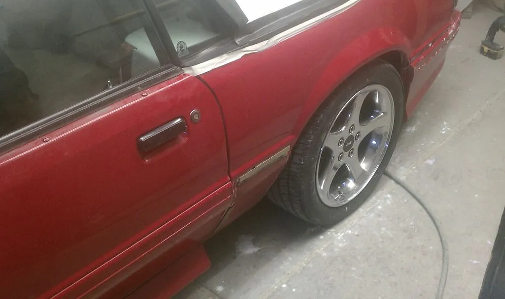

Some of the belt moulding has warped over the years, pulling away from the body slightly at the top edges. I was there this morning and they had some of it off to re-shape it as closely back to normal as they can get it. That will be nice, they were like that when I bought the car 12 years ago and I never replaced them. The driver's side front ground effect was the worst culprit and it's looking pretty straight now. Since they're repainting the front bumper and touching up a bunch of little scuffs and scratches, I'm also going to have them color sand the entire car before it's all said and done. The paint never really looks bad but when you're right up on it you can see some imperfections in the clear. Despite my detailing efforts, I can't perfect it myself. Good to have body men in the family, I guess! I hope it gives me the results I want.

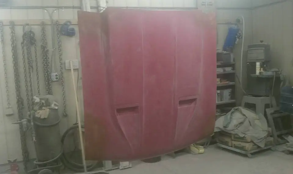

A few panels are off and fixed or color sanded already. Hood + bumper are in the middle of their reworking. They no longer hit each other and now they're focusing on making sure the underside doesn't hit anything anymore either. They'll be painting the trunk area to match the body and I'll likely have them do the inside of the doors in the same manner.

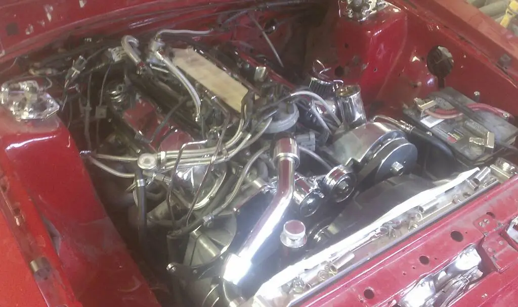

Now that there's room the attention will soon be on the engine bay. I have a few parts off to now polish or powder coat, and some more bolts to replace with chrome ones.
When the bumper comes off I'll be back so i can look at a bunch of things being hidden by it. It's dirty as hell in there!

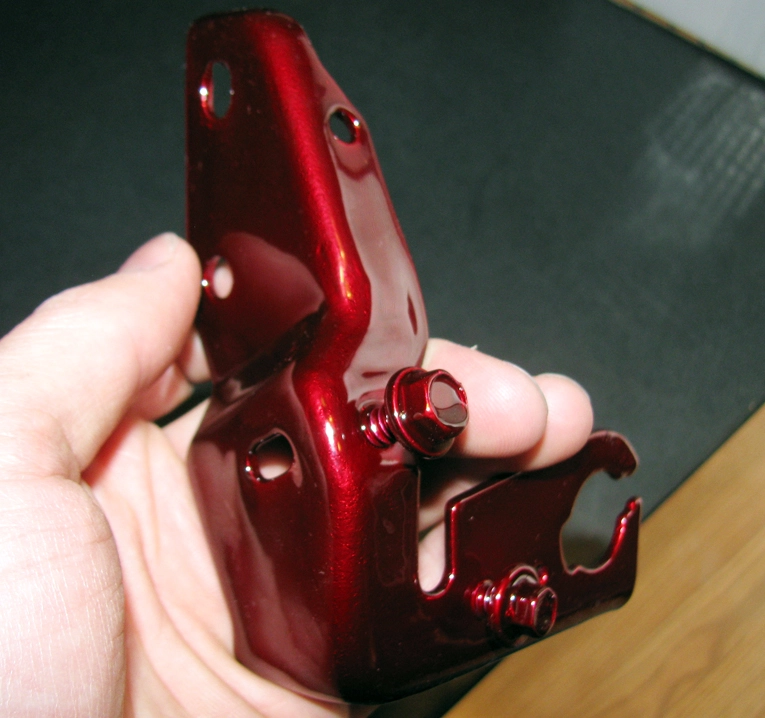

Doing some sample work for the candy red powder for my lower intake:

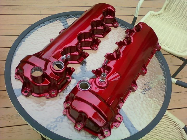

This red topcoat is more of a tinted clear as opposed to a translucent color on its own, which makes it tougher to lay properly. It came out darker than I expected but overall looks great. Anyone who's familiar w/laying powder will know what I mean when I say that it flows out like a clear, making for a very smooth and slick piece. Only trouble w/that is the color kinda bleeds a little bit and results in a less uniform color. What I was hoping for was similar to this color below (Translucent Red, a separate see-through powder to be laid over chrome similar to this candy red topcoat) but a little darker:
It looks great with good light but in darker situations it, of course, looks darker. For the lower intake I'm thinking it'll be too dark. I'm going to mess around w/more samples to see if I can get this to lay smoother upon shooting the first layer, which should have it cure a little lighter/brighter. Failing that, or if that doesn't work anyway, I'll pick up some of that translucent red the valve covers are done in and see if I can lay it on a little thicker to see if it gives me the results I want.

The progress: the re-shaped ground effect and the cowl have been painted. Still need the initial wet sanding but so far they look glossier and brighter than the rest of the car does. Can't wait to see how great it looks once fully wheeled out. The hood is basically ready for paint, there's just a little more prep work on the inside curves of the underside. It no longer hits anywhere, thank God. Hopefully once it, the radiator hold down, etc. are all back on it will remain that way. The way the hood fit at the cowl area, there was a large gap. So to close that up and make the gap more uniform all the way around the hoodline, they built up the rear of the hood to help close it up. Sweet!

Pretty productive night. Got the lower intake off and will begin powder prep tomorrow. Removed the vacuum tree from the fenderwell and re-routed all the lines so I can mount it behind the intake/under the pinchweld. This was the better alternative than running vacuum hoses into the interior and back out of the firewall - no thanks. I have to have various vacuum lines going to my EGR and intake stuff, plus of course the brake booster, and there's only 1 small connection that really needs to be in the fenderwell. Since the intake & booster hoses are big and ran along the firewall, they looked messy and ugly and I couldn't tuck them behind the new brake booster. So now they'll be out of the way and the only one visible will be the small one going to the fenderwell (and yes it will tuck along the pinch weld and behind the booster). Should look a lot cleaner there especially since the main harness is now gone, too!
Now that the bumper is off I have access to the crash sensors, wire harnesses, etc. so I can remove stuff for paint, cleaning, and re-looming soon.
