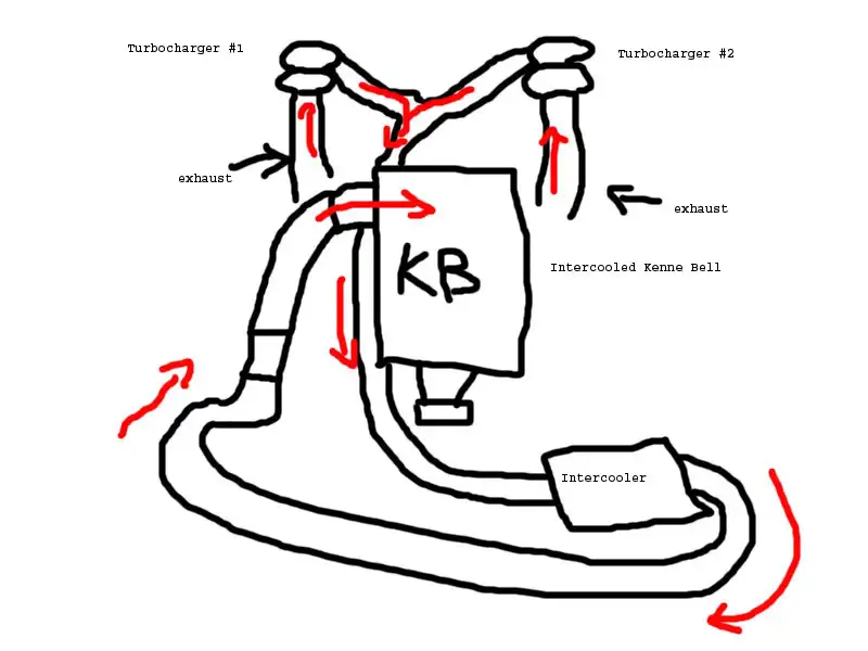

I'm sure this has probably been posted before, or something similar, but I have yet to find it. Would a setup like this be possible? I'm not talking economical/affordable, but like...if you had the room on your car and the $100,000 burning a hole in your pocket that you just HAD to burn somehow, would a setup like this work?? (yes i'm very bored at work right now)

So the turbos are driving the air though the intercooler which cools the supercharger? Hmm talk about boost lag that's some serious backpressure. I've seen staggered inboard 496 motors on a 42 foot boat with a simalr design. Works better with direct drive tho cuz no shifting and crazy boost lag on top of breaking your neck when it kicks back on.
Turbo supercharged has been done successfully in few cars. Most common(if you can call it that) is 1st gen MR2.
Get 4A-GZE, get vintage HKS turbo manihold from late 80's, strap turbo(most use turbo off of DSM. perfect size, and its cheap), upgrade fuel system.
Guess way it works is that it works like sequensial twin turbo. At low RPM, Twinrotor type OEM blower pushes air, then after 4000+RPM, turbo kicks in.
But thats because they have sucha small engine, when you have big enough engine, who cares? just built up ur engine, crank up the PSI. much cheaper, less complicated, and makes more power...
