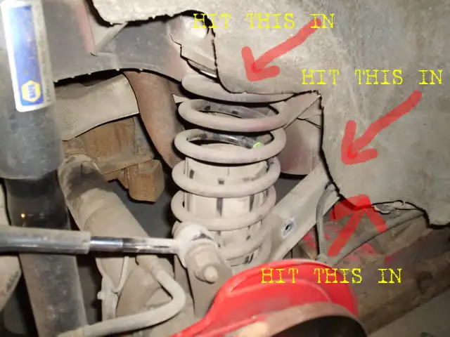

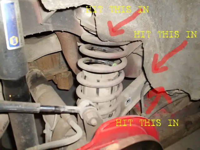

i think your somewhat confused...im not talking about rolling the inside of the fender (the quarter panel)....im talking about inside the car...heres what im taking about...take the back wheels off, and beat in these metal edges with a mallet to make it face inward a bit.....that was when you go around corners, it wont rub...trust me, dont take teh back springs out, just do this if necessary...

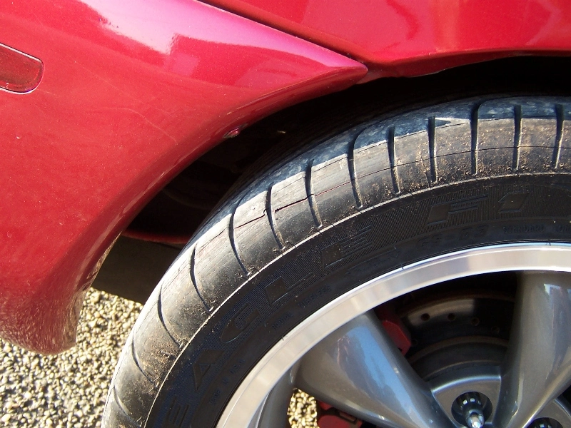

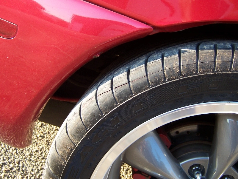

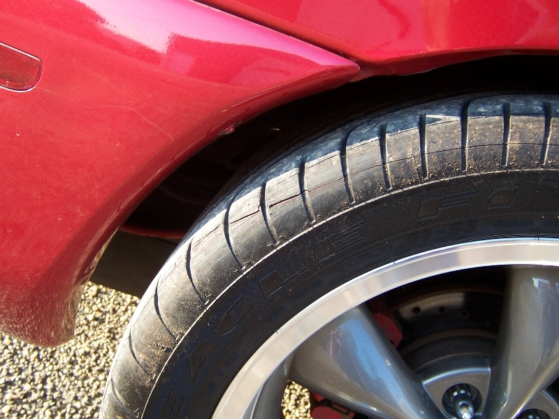

im worryinng about things like this from the fender lip happening...
how much room do you have from the tires hitting the lip on the inner fender????

Adam95GT said:
Yea but nitto's are aparently smaller 315's then these tires.
Just so you know that didnt happen from normal drivng. Someone rear ended him when that happened.
