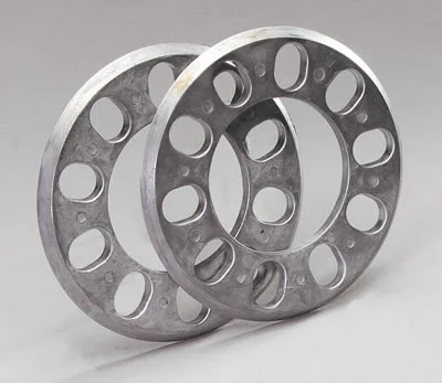

I would like to issue a warning on those spacers.
I used them on the front of my 76 when i decided to use 88 tbird rims for a while.the first night I had them on, I was coming home from work, the lug nuts stripped off the studs because there wasn't enough thread to hold.
needless to say I got lucky,and the wheel stayed under the fender.But what a mess! I was also lucky that I managed to slow down before it happened,when I noticed something was going wrong.
If you use spacers,make sure that you have enough stud thread to hold them.
Gluing them or epoxying them exactly centered wouldn't hurt either.
Right now I just have some ****ty slip on ones. I know, I'm stupid. They're like these:
I'd like a bit of a wider one however, cause it barely clears the inner fender. Problem is, all the small spacers I've found are either too thin, or they're too wide of a spacing.
I want like a 1/2" spacer, I find 1/4" or 1.5"+
The wheels are fox 10holes, the tires are Mickey Thompson Sportsman Pros, 26x10.5x15

Yeah well you got it all wrong. There's NO WAY in hell I'm gonna trust a CHUNK of aluminum to hold my wheels on. Anyone remember the Roto-lug?? Yeah.. I don't think so.
The slip on (as you guys are referring to, the $hitty ones) are by far much better. Anyone with 1/2 a brain knows better than to use these with stock length lug studs. Change 'em out, they're a buck or less a piece for cryin out loud. For a fact, the Circle Track class i use to run (Street Stocks) allowed the use of 1/2" sandwich spacers on the wheels, if we desired more offset, since our class was designated a specific tire size and wheel. Now you sit here and tell me what's gonna break first in a hard corner... the aluminum spacer SANDWICHED between two steel surfaces with studs going ALL THE WAY THROUGH -or- an chunk of aluminum bolted to the hub and trusting it's studs (which are held into the aluminum ONLY) to secure your wheel to the vehicle... heh... no guess here which one I'D run...
