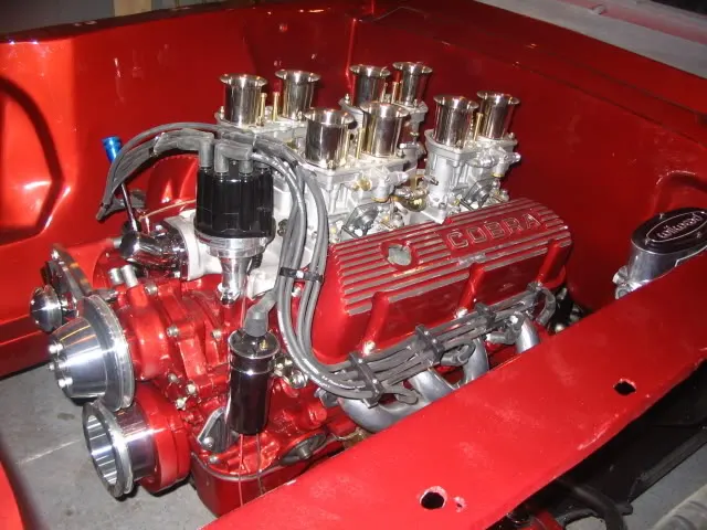

Weber IDF's, 302 w/289 heads.

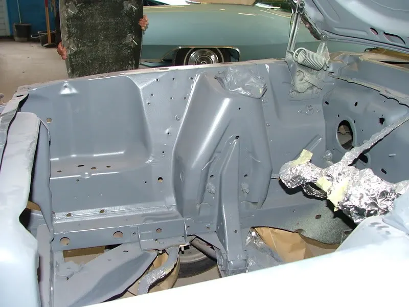

from the left side. That black thing you see is the Boss 429 hood scoop that the shop owner's kid was holding while I took teh shot

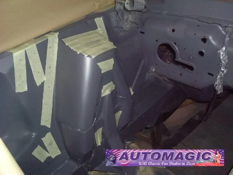

from the right side

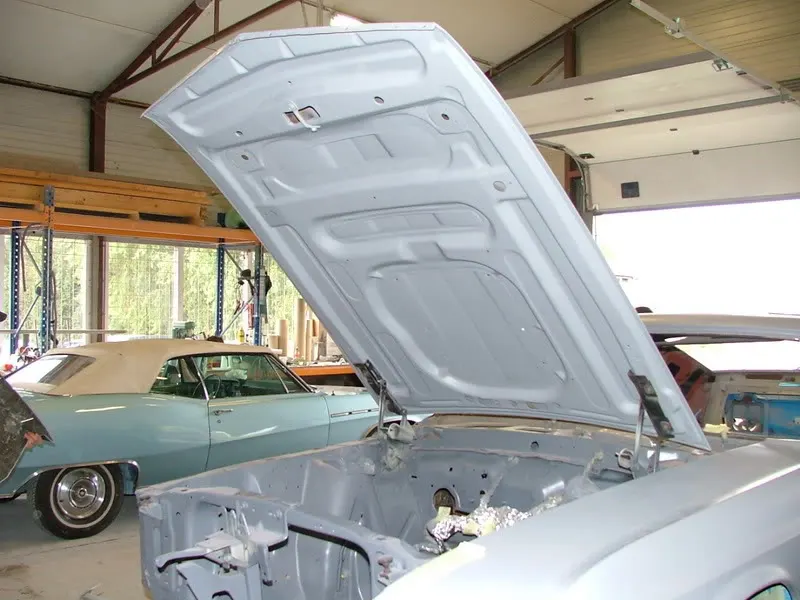

sorta from the front

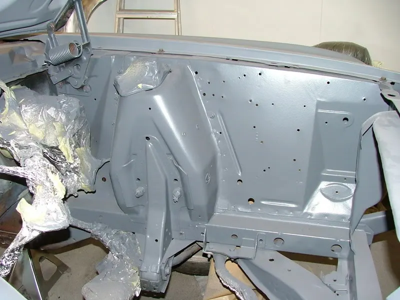

and a view of the Boss 302 shock tower reinforcements welded in and primed.

Realistically you could make your own using commonly available parts. Very few pieces in the kit, if any, are complicated. Measuring correctly is the key to making the pieces fit.
Yeah, measuring and then likely adding half an inch or more to push the towers back out to where they should be. One of my buddys has cnc access at work and a lot of machining tools in his garage, too bad ive already got him "working" on 2 projects.
