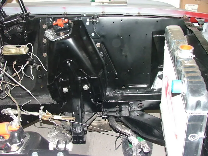

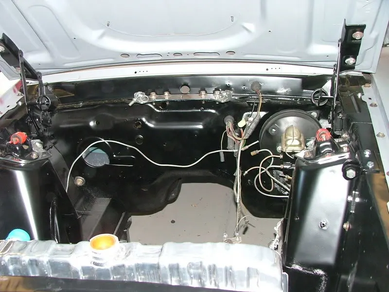

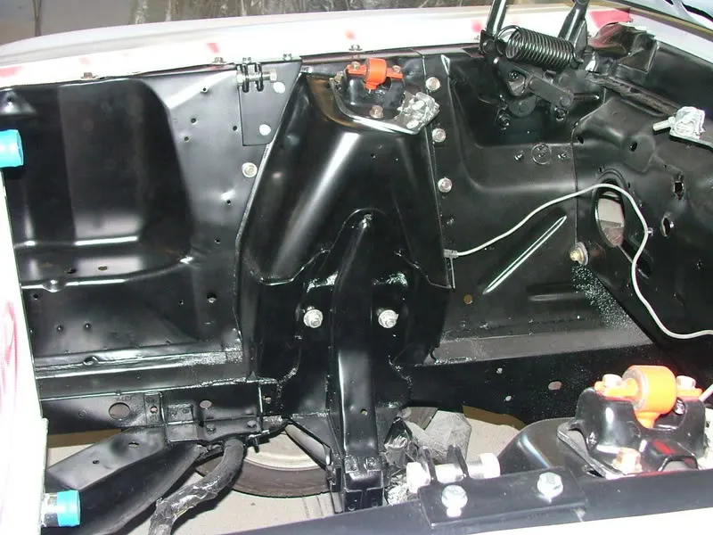

This is the finished product. Only needs an engine now.
View of the bay from the passenger's side
view of the bay from the driver's side
view from the front

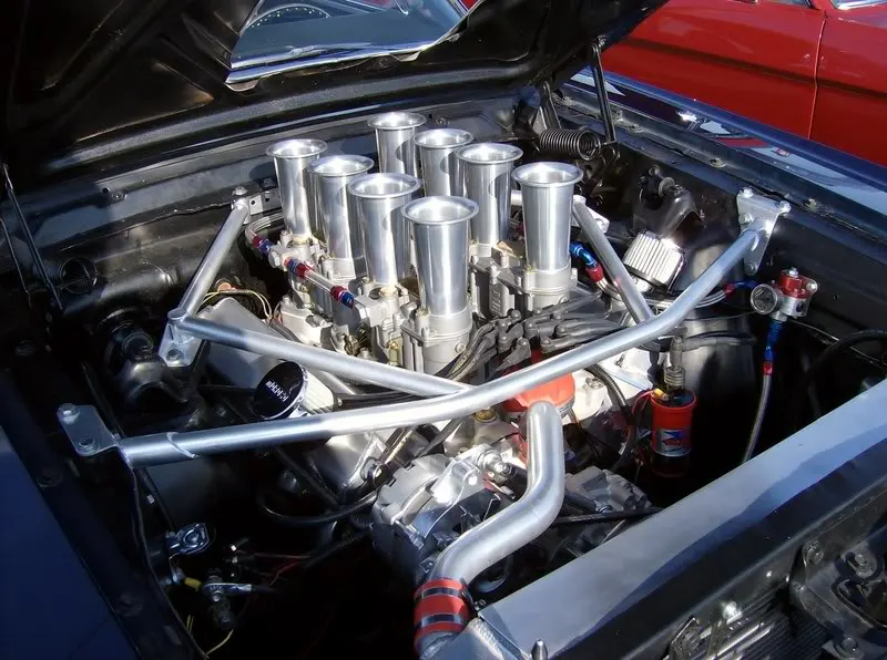

Here is what i Just finished on saturday. and Before anyone says I ruined a K, My father has owned this car since Jan of 1967, removed the K engine that summer and put his drag engine in the car, then cut the shock towers in 1970 to slide a 351C 4v engine in there. No modifications were done since 1970, cept for cutting of the fan shroud for the new radiator, but he had cut it back in 70, so a regular 66 rad. wouldn't have fit.
66 Fastback K-code, 58k original miles, never restored
427 Windsor stroker engine
AFR 225 heads
Weber induction system
long tubes, lots of ceramic coating
Custom strut bar (mounts in factory locations, no cutting or welded required)

If you go to "Speedway" (similar to summit) they happen to carry the Aluminum swagged bars with right and left threads, which appear identical to the bars used in TCP's braces and they are significantly cheaper than what TCP gets for theirs, you do have to add in the cost for heim ends and making the brackets.

Are you making that power on a stock block??????
The block is a Mexican with a girdle and o-ringed. The 733 HP run on the engine dyno was an "accident". Very lean. I have too small injectors ( 42 pounds ). As it is now, it can be safely turned to 5500 rpm. Still makes 654 Hp and 625 lbft. Plain AFR 185 heads and a edelbrock rmp hydraulic flat tapped cam ( no roller ). Weiand Xcelerator inntake that I converted to EFI.
Is that an out of the box Paxton blow thru carb hat or is it modified?
This is the hat that came with the kit. It was for a Chevy vortec engine. ( hard to come by used speedparts in Norway ). So i had to plug the 2 holes for extra injectors and mount the bypass valve to it. Works ok on an 4-hole throttle body. I dont think it will work god on a carb application. To low and to much turbulence I think. I had to fabricate the brackets for the supercharger.
