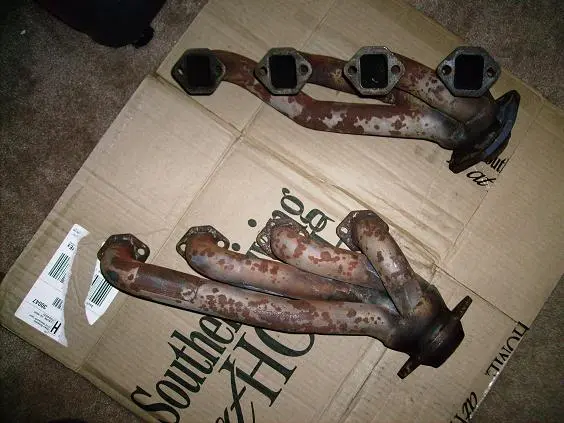

Mac 1-5/8 shortys. Yea they look awful but they'll get sandblasted and painted at work. I know the separated flanges are prone to warping and a tough install but I test fitted them with all the bolts on a set of E7's I had in the garage and they lined up fine. Not bad for 10 bucks if you ask me. :nice:
EDIT: what's even crazier, I saw them for sale on craigslist. I go to see them and it's a guy I know and they're off a car that I used to own. lol

I've found that with the shorties it's hit and miss with the warping. The thing is, full lengths tend to warp easier but they're also much easier to pry on and tweak into place than the shorties are. Once the shorties warp they're HELL to get on right. Still not bad at all for $10. I've been thinking about trying my hand at making my full lengths a solid flange. I think if i bolted them up to a junk head and then made some connection bars and welded them on while they're bolted on that it would work without warping them.
