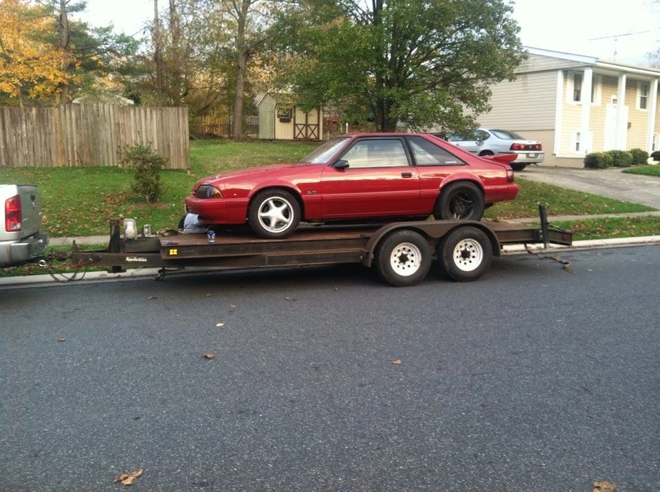

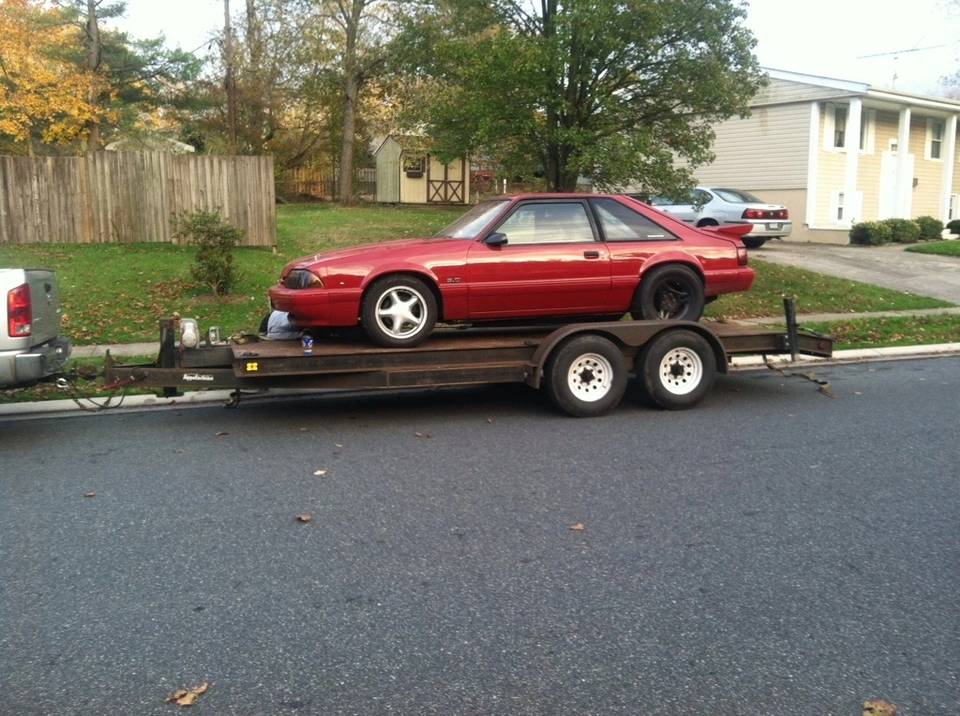

figured id throw this in here... was taken right before i left for the track.

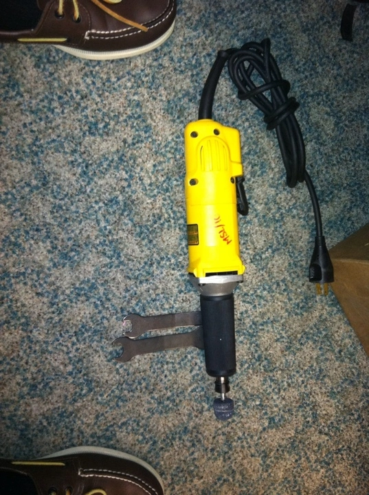

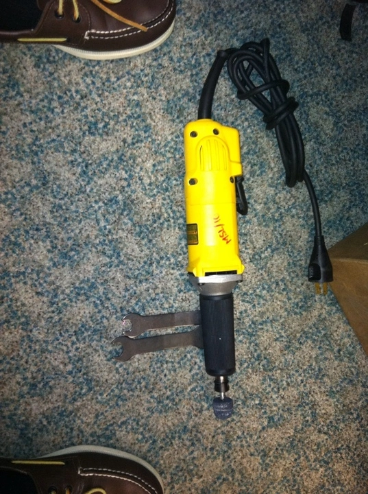

Port work!
Also, nice Sperrys :D.
haha im pulling your man card for knowing what type of shoes i had on lol
but yes... port work! going to open up the top half of my intake a lil more. im plan to fill the EGR spacer with JB weld and blend the upper to it. the 65mm throttle body go away for a 70 or 75 (havent made up my mind). then open up the runners to match the gaskets which the lower is matched to

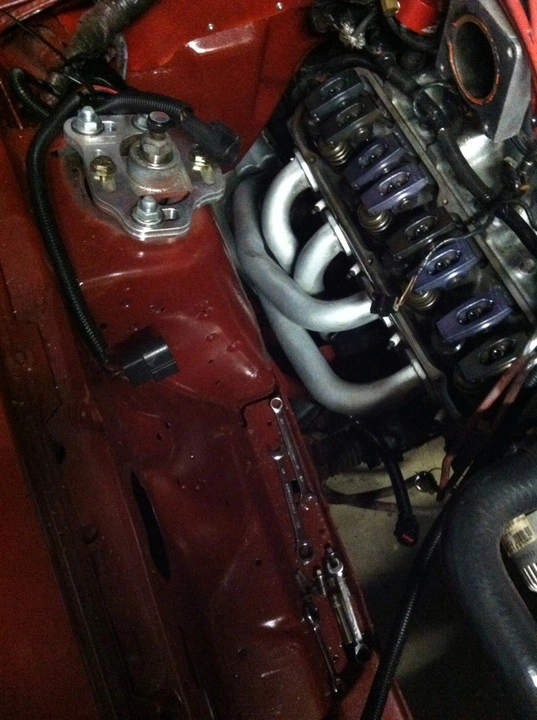

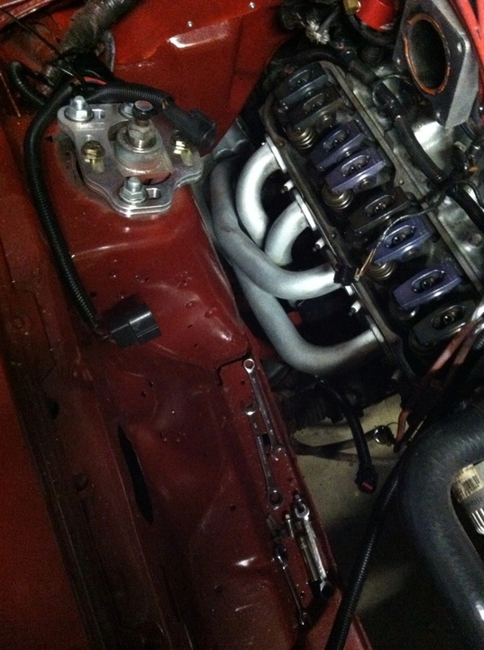

You gonna dimple the shock tower for clearance? Looks like it's rubbing or damn near close and going to rattle like all hell. Love the colors on those RR's.. I've never seen a darn set all one color in 20 years.
nope... should be fine i have solid motor mounts.
always wondered why they changed colors and i still havent figured it out. my guess is heat makes the pores open up and oil discolors them. i saw ford racing has a new set that are adjustable with out using shims
