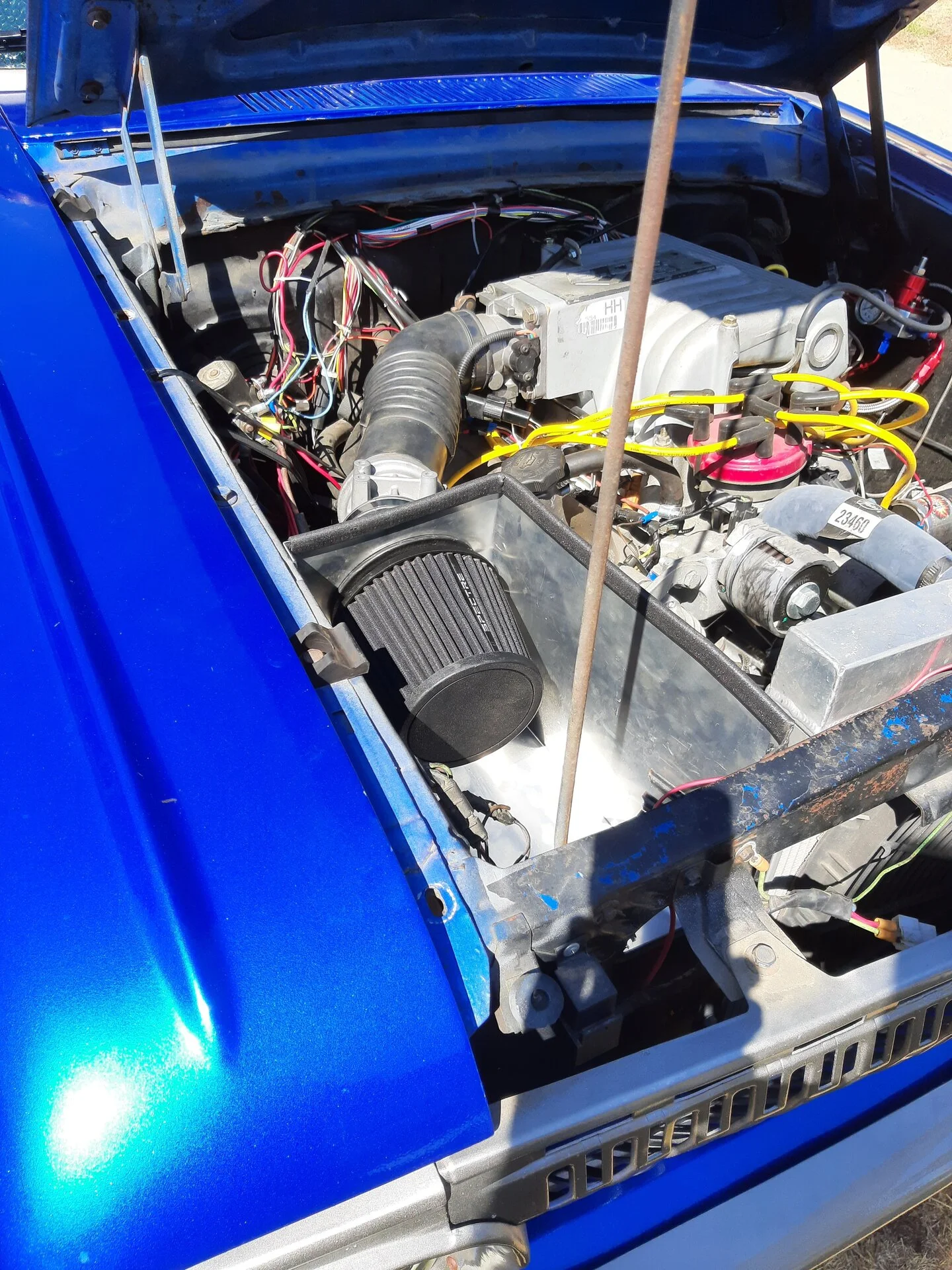

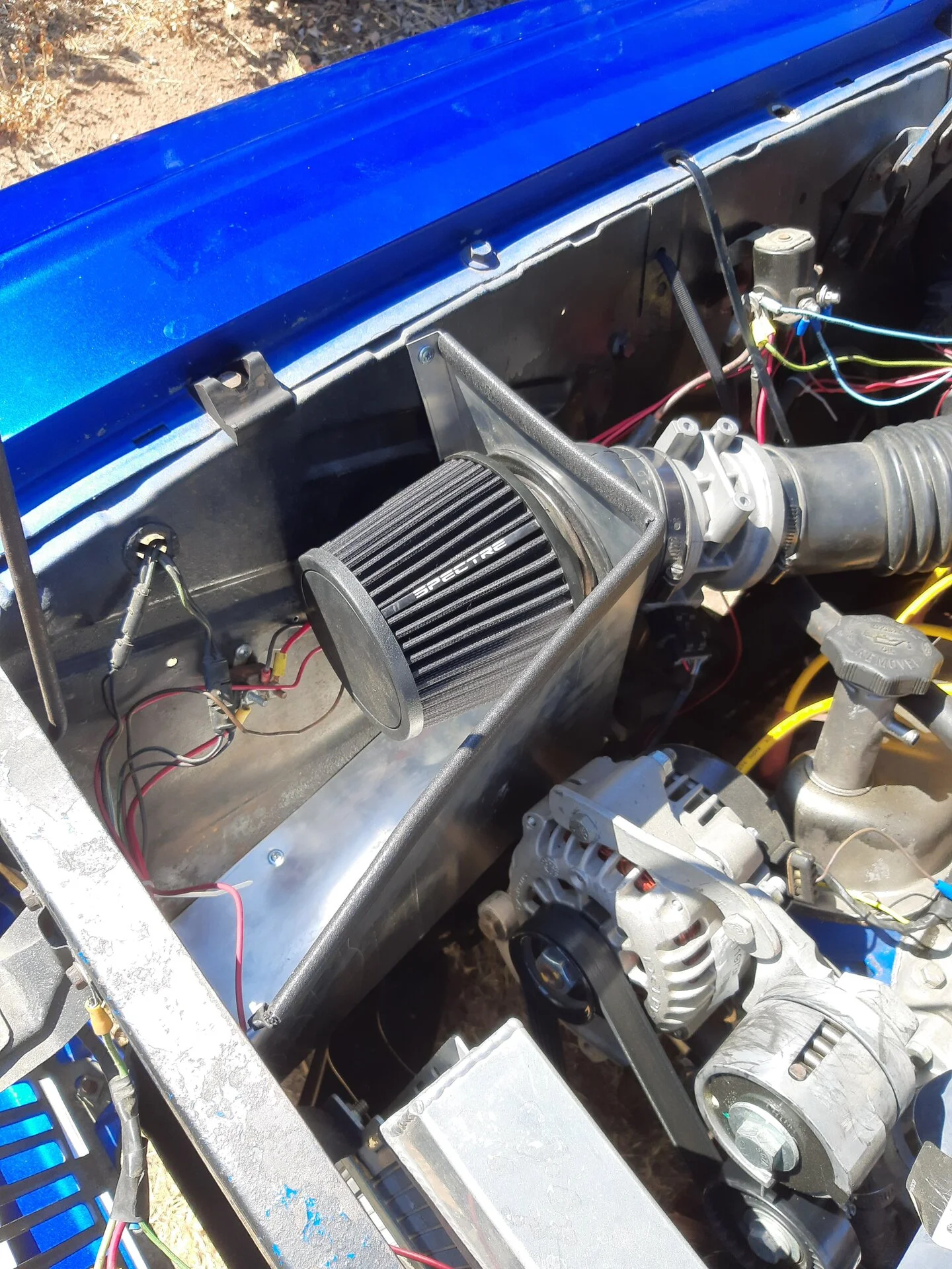

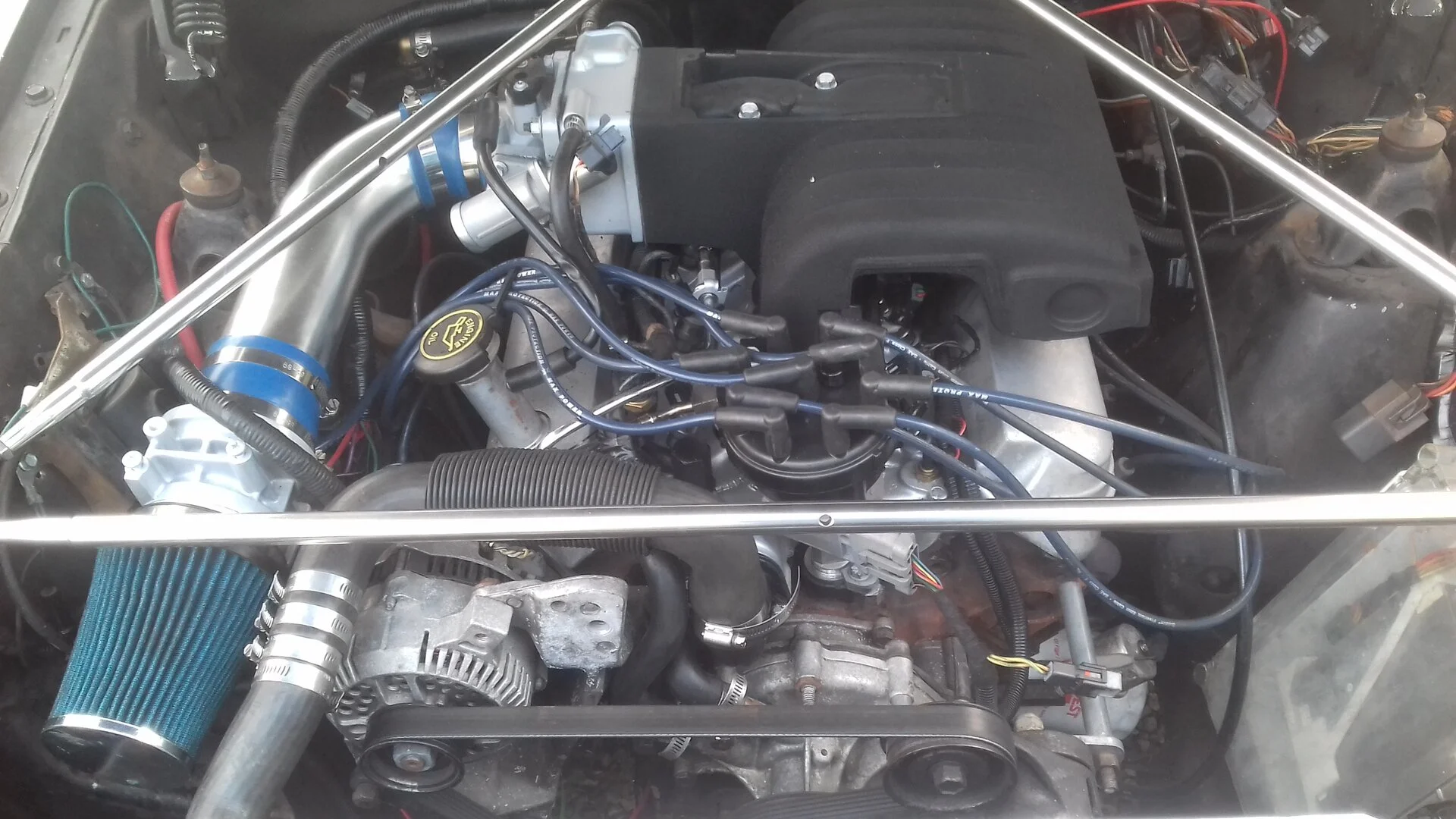

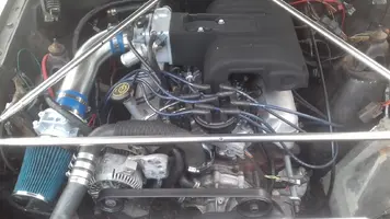

IAC or maf? Looks like the maf is upside down, oh, and the filter on the maf is bad juju, turbulence jumbles the maf readings, needs at least 6" +- between the maf and filter, I was told this years ago by the people that sold me my maf, it can be clocked to get a better sensor reading, you're also getting heated air, not fresh, cooler air.
I guess I need to write comment then post pics. Anyway this is what I did on mine for cold air intake. There is some convenient louvers between the headlight and radiator on the core support. I just opened them up and put in the sheet metal box.
It looks pretty good like that. Simple and effective. There are some companies out there that make a replacement for the stock elbow, connecting from throttle body to airbox, that you could add if you wanted better looks and a bit more flow.
I was referring to the tubing between the maf and tb, I have a C&L tube but you can get exhaust pipe the same diameter with bends then cut at an angle to point towards the filter box, use rubber coupling, they come in different colors, that will make for a better looking assembly, paint the exhaust tubing black or whatever color suites you.
just say'n :shrug:
One day it will be prettied up, for now it works. I do have plans to dress up the engine bay, some day. Clean up the wiring, paint some things, put in shiny stuff. The whole car is like the engine bay, functions as intended but could look better. Always working the time and money balancing act, you all know how it is. I like how OP, slipkid269, engine bay looks. I just throw stuff up for his inspiration. I wonder if he got his idle issue resolved.

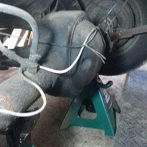

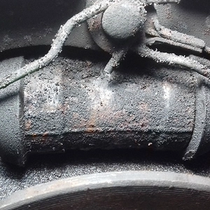

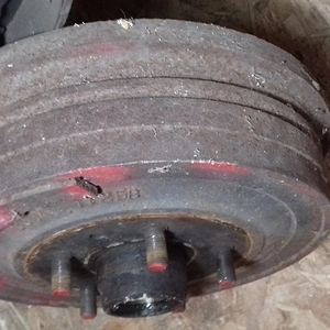

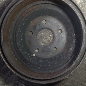

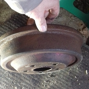

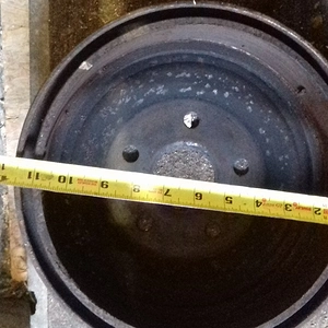

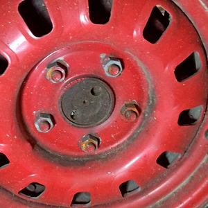

I will be posting elsewhere later, pics of my brakes. I need to get wheel cylinders and shoes but don't know what they are. Falcons were originally 4 bolt wheels but this has been converted to 5 bolts. Of what? I don't know but its time to get that goin. My bet is that they are Galaxy or Fairlane parts. Maybe mustang. Not sure where to post it yet, maybe under the "maybe mustang" header.....hmm couldn't find that. Swaps? I'll figure it out.
The ball joint holes on the Mustang 5lug drum spindles are bigger. The Mustang disc spindle is longer. Falcon guys would take the Mustang 5lug spindle and control arms for a basic bolt on swap. The nuances are covered in great detail over on the Ford six website.
Reactions: General karthief
Ok, seems the best way was to put them in a gallery. There are some axles pics too. Everything looks in good shape except for the leaky wheel cylinder. It leaked onto the brake shoes and they turned to brown goo like melted crayon. Never seen that! From what I have learned these look like later 68-70ish mustangs? or Galaxie or Fairlane of a earlier year like 64? Nothing I find I feel is definitive. Short of going into Napa and knowing what I need I may have to ask for multiple years and models so they get them in I can compare. I miss the good ol' days when you bring your parts in, the old guy looks at them, goes in back and says heres what you want. Try that at most parts stores now and the kid will go...what is it? Whats it off. And if the computer doesnt spit out the right answer they havent a clue....I digress. So here they are any help is appreciated.
