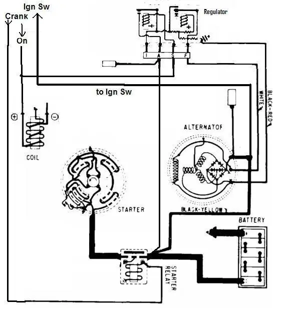

It starts fin. It will not shut off! I jumped both places on the NSS and neither had an effect on shutting the car down. Check this out, while the car is running and the key is in the off position if I pull the harness on the voltage regulator off, it dies. Should it?
Possibly a wire or two are in the wrong position on the voltage regulator plug.
Maybe this diagram will help
I have a dozen times and it all seems right......the only thing unique and not sure if this matters is the ignition wire (green/red) was broken off from the VR plug...thought I had found the problem...NOPE, so I ran that wire directly to the prong on the VR instead of through the plug...would that matter?
