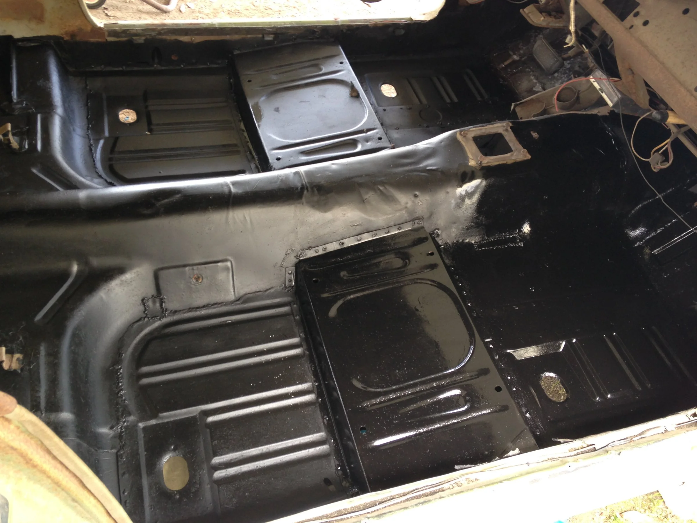

I shot some SEM bedliner under the floor after I sandblasted it. I would have preferred to fix the trunk area too and bed line it all at the same time but I got in a hurry because I have to give the rotisserie back. I have to order some some more parts now.

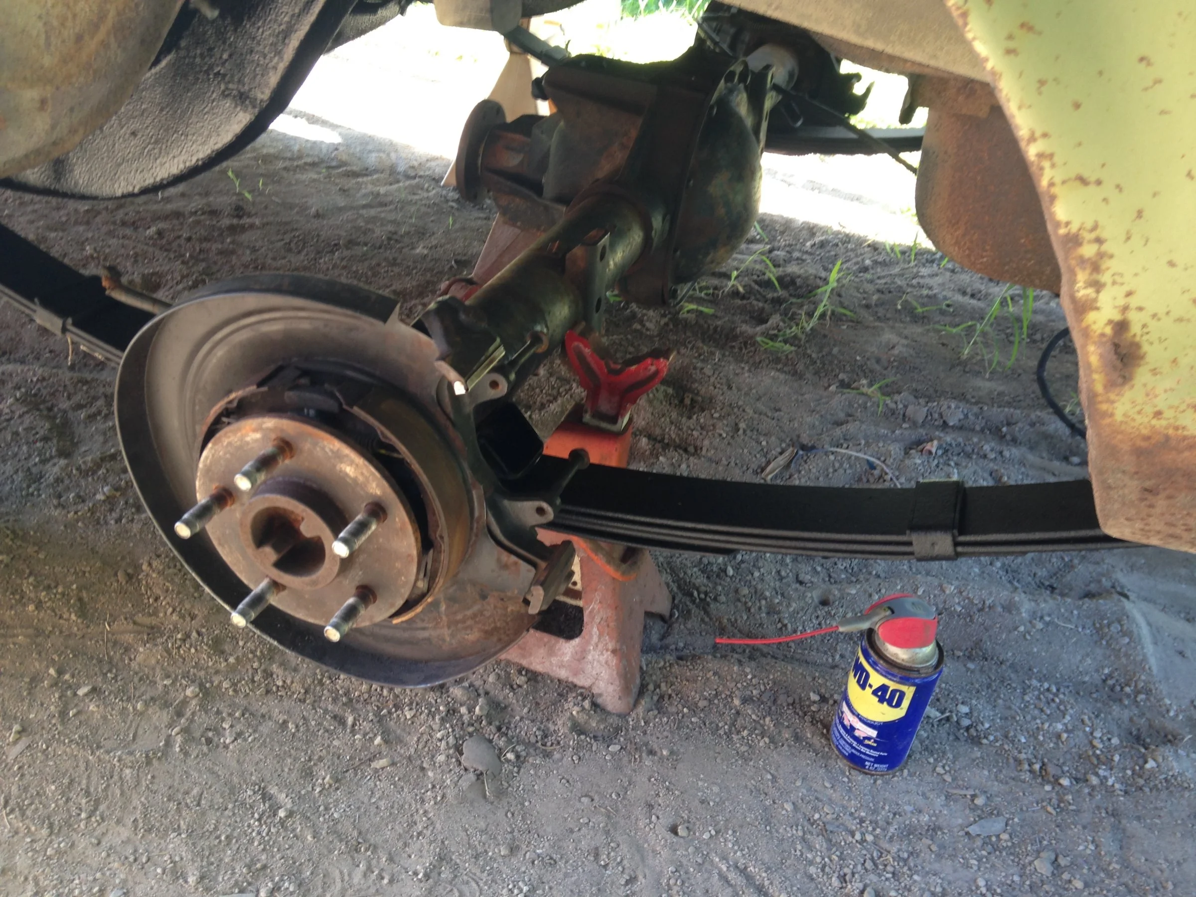

I put that rear end in by myself with a floor jack. You know how well floor jacks roll on dirt. I raised the rear with the jack, put it on stands, then installed the leaf springs . After that I raised the rear again, moved the stands out of the way, and set the rear down on the springs. I found my U bolts at Napa.

There's a lot of stress behind this picture. I thought I would never get these springs in. The Loan a tool spring compressor from Auto Zone was probably not the best tool to use, but it beat nothing. I gotta get some strut rods and then I can put it on the ground. The rear is waiting for me to modify the shock plates so the new u bolts will fit.

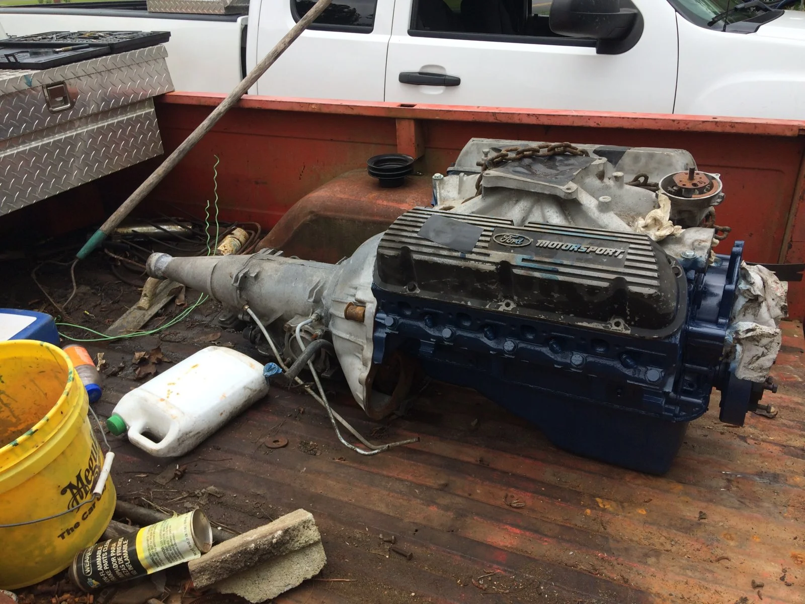

Wow I've been gone almost a year. I haven't touched the body of the car but I have rounded up a roller cam mid nineties 302 for it and a small bell housing C4. I plan to start the 302 on a stand and see if it runs as good as the previous owner said it does before I put it in the car. The C4 will need to be rebuilt. Many more missing parts will need to be located.
Reactions: 120mm
Here's my 302 and C4 waiting to go in. The internals looked mint on the engine. I think its been rebuilt before. I added some GT40 heads and a HO cam out of an old 5.0 Mustang.
