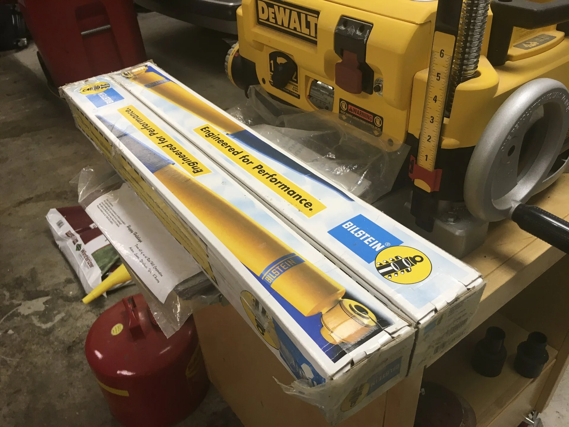

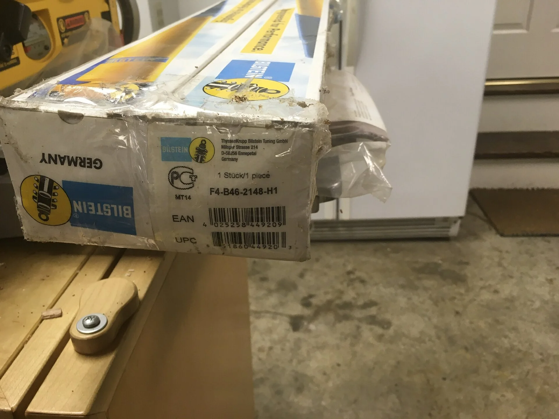

Alright then, thanks a lot. At this point, any input helps as I am stuck between milling the spindle down to fit the 87 shocks and seeing how much Willy will sell his 86 shocks for? Speaking of so, WillyBill how much would you let those 86 shocks go for.
$100 plus shipping. Never been opened.

ATTENTION: Currently looking for Bilstein struts that will fit an 85 Mustang GT 5.0
I swear these struts are harder to come by than an 85 mustang itself. Just kiddin, is there a spacer that I could purchase to make the 87 struts fit the 85 spindles?

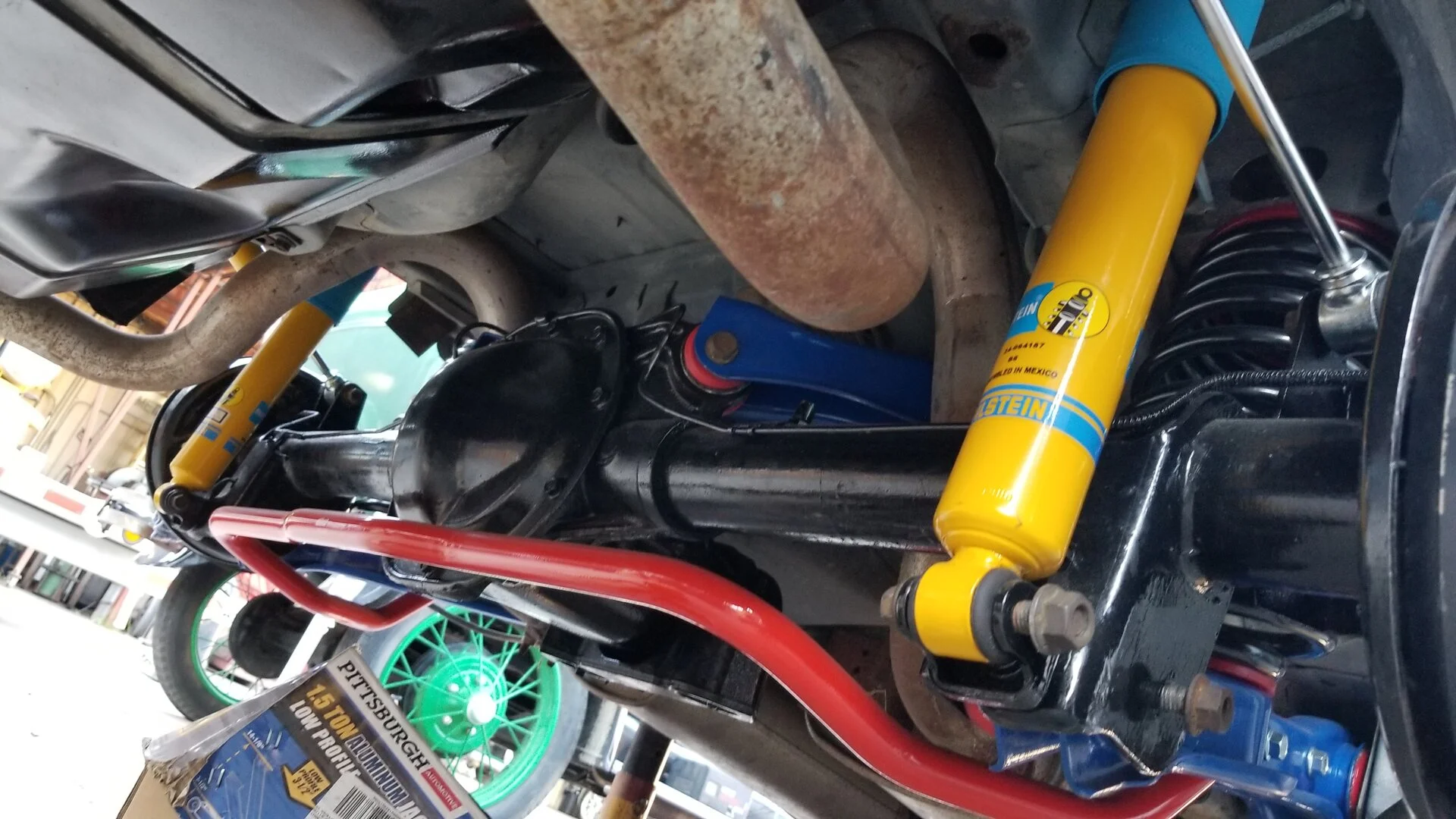

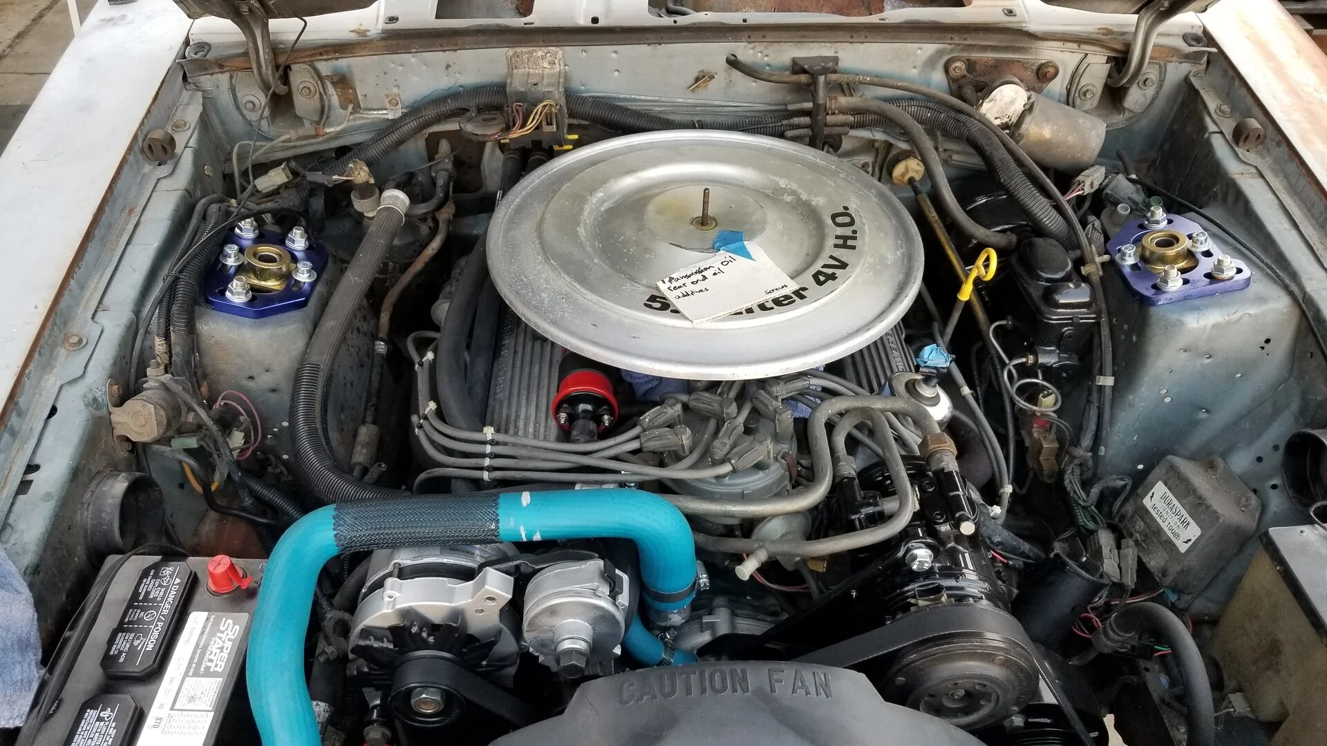

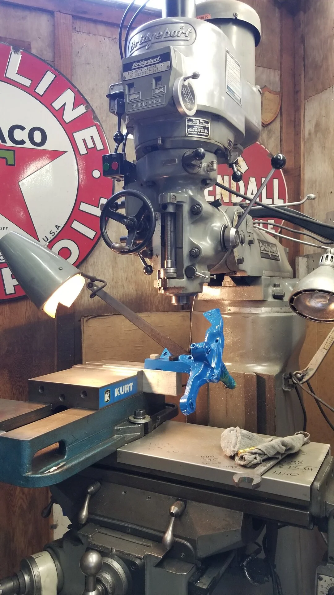

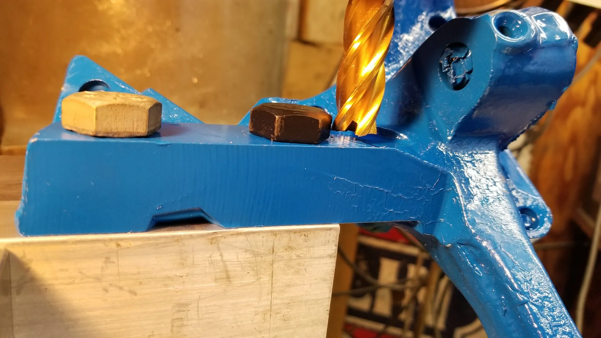

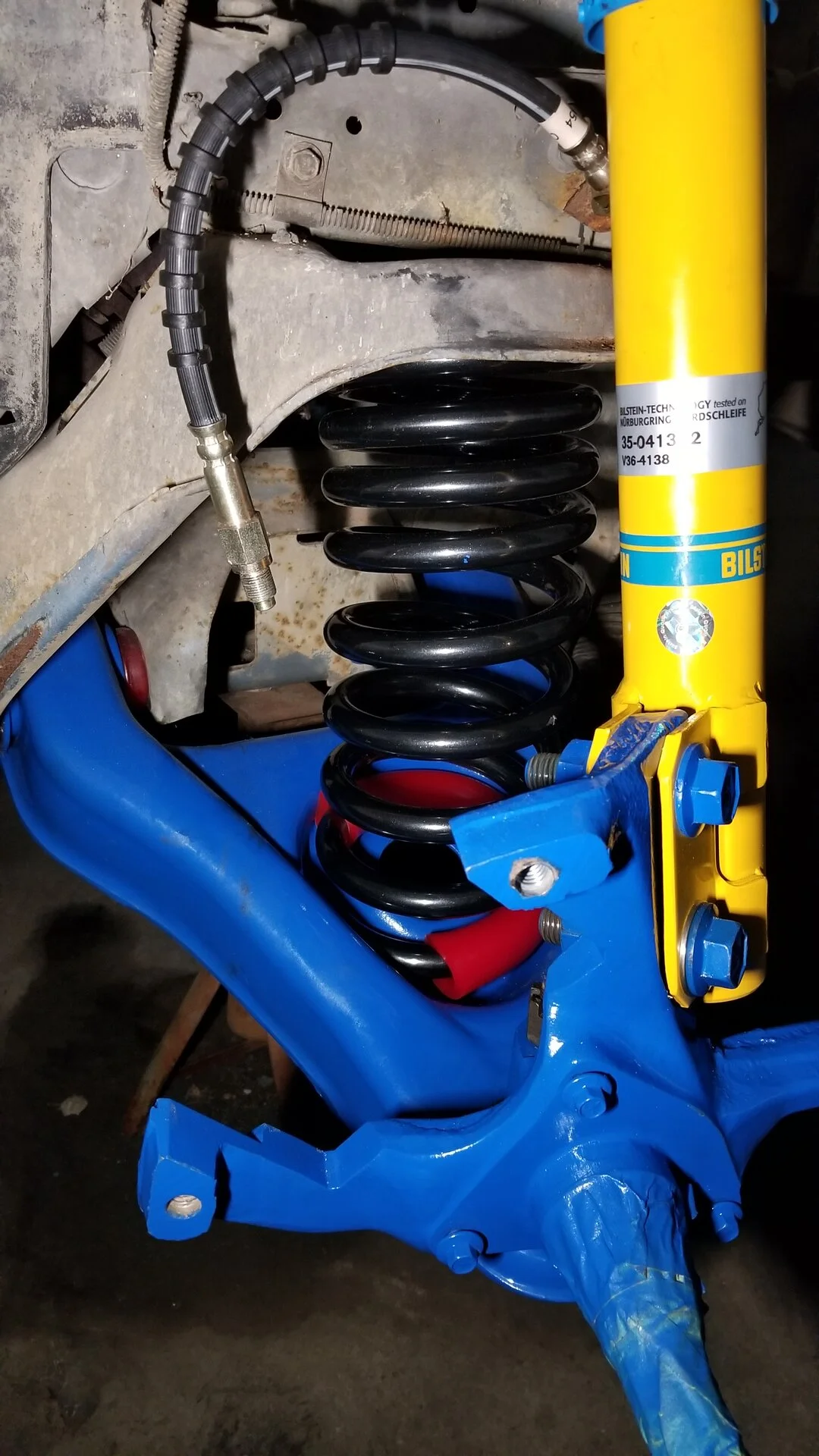

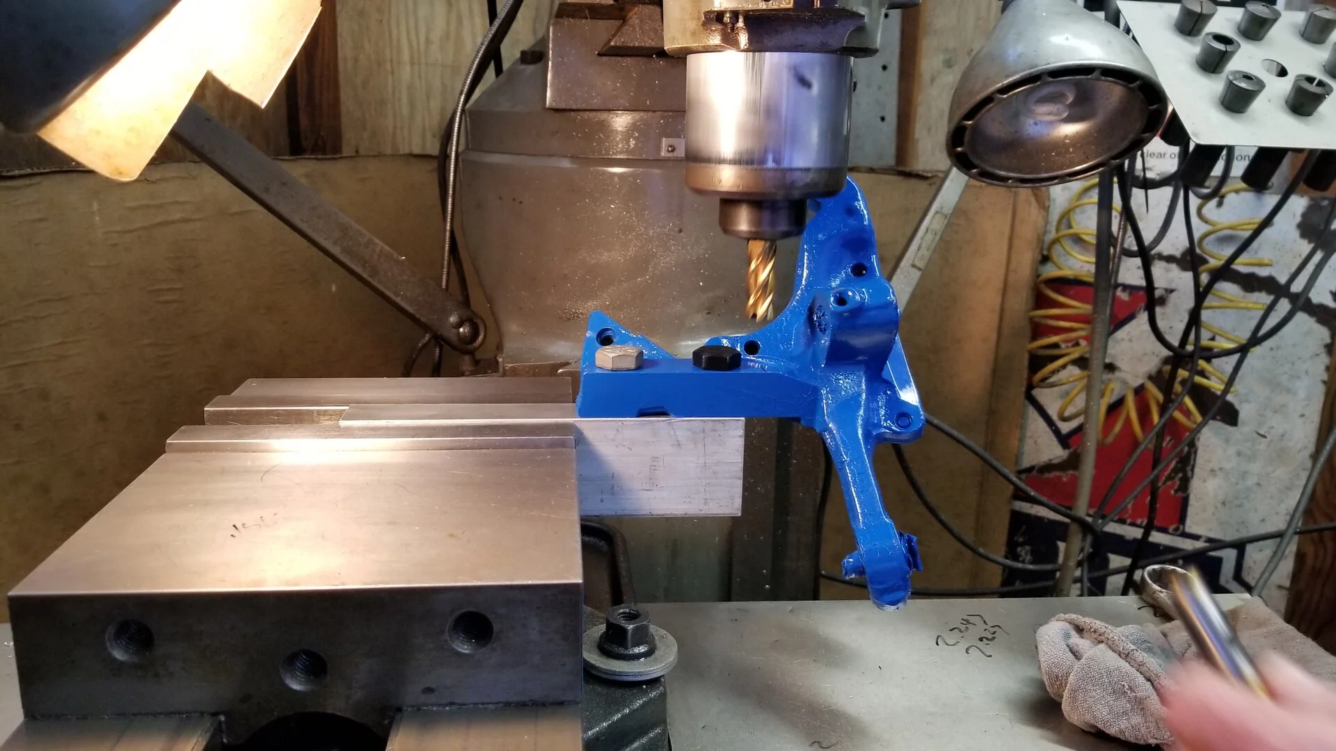

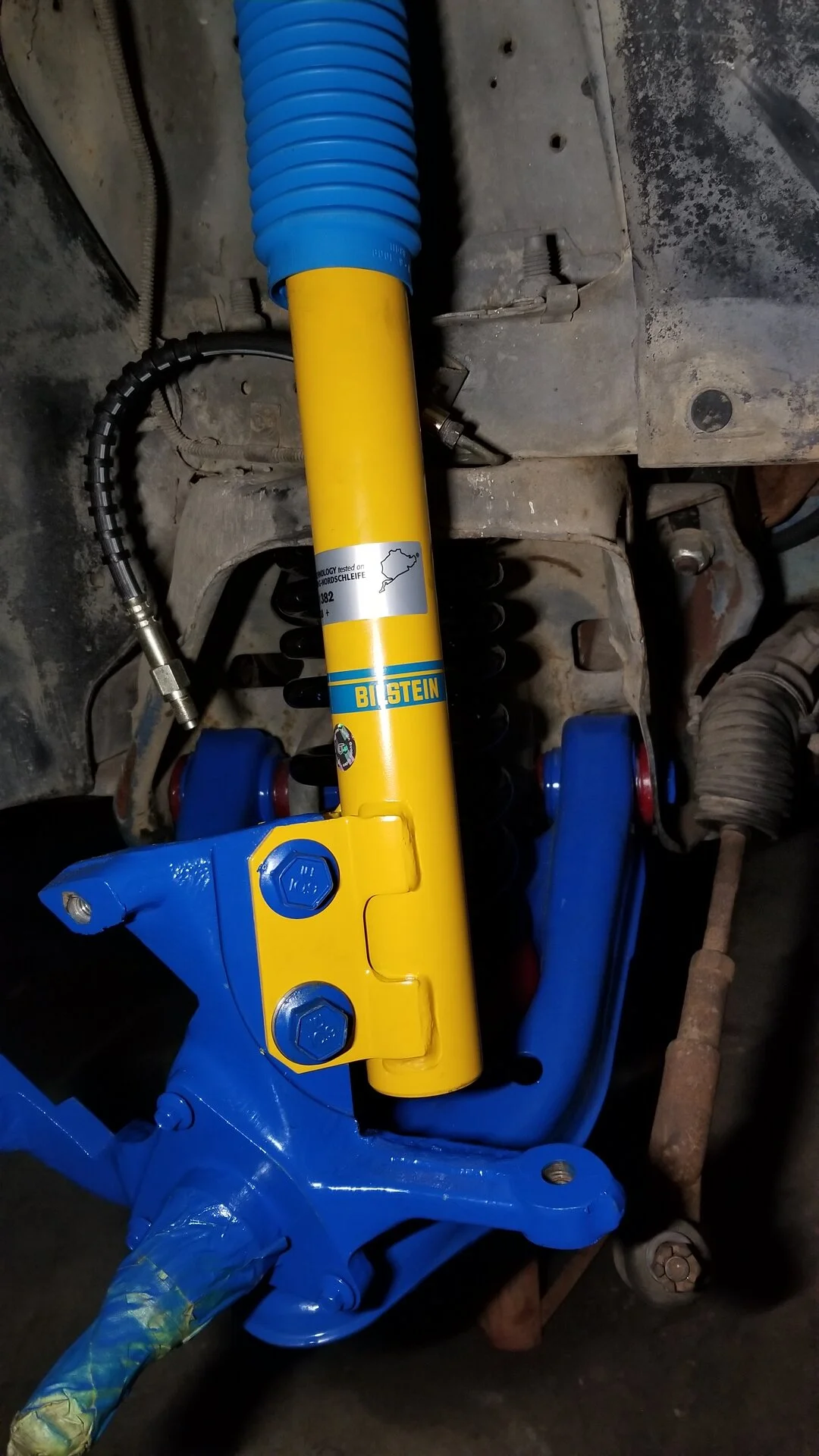

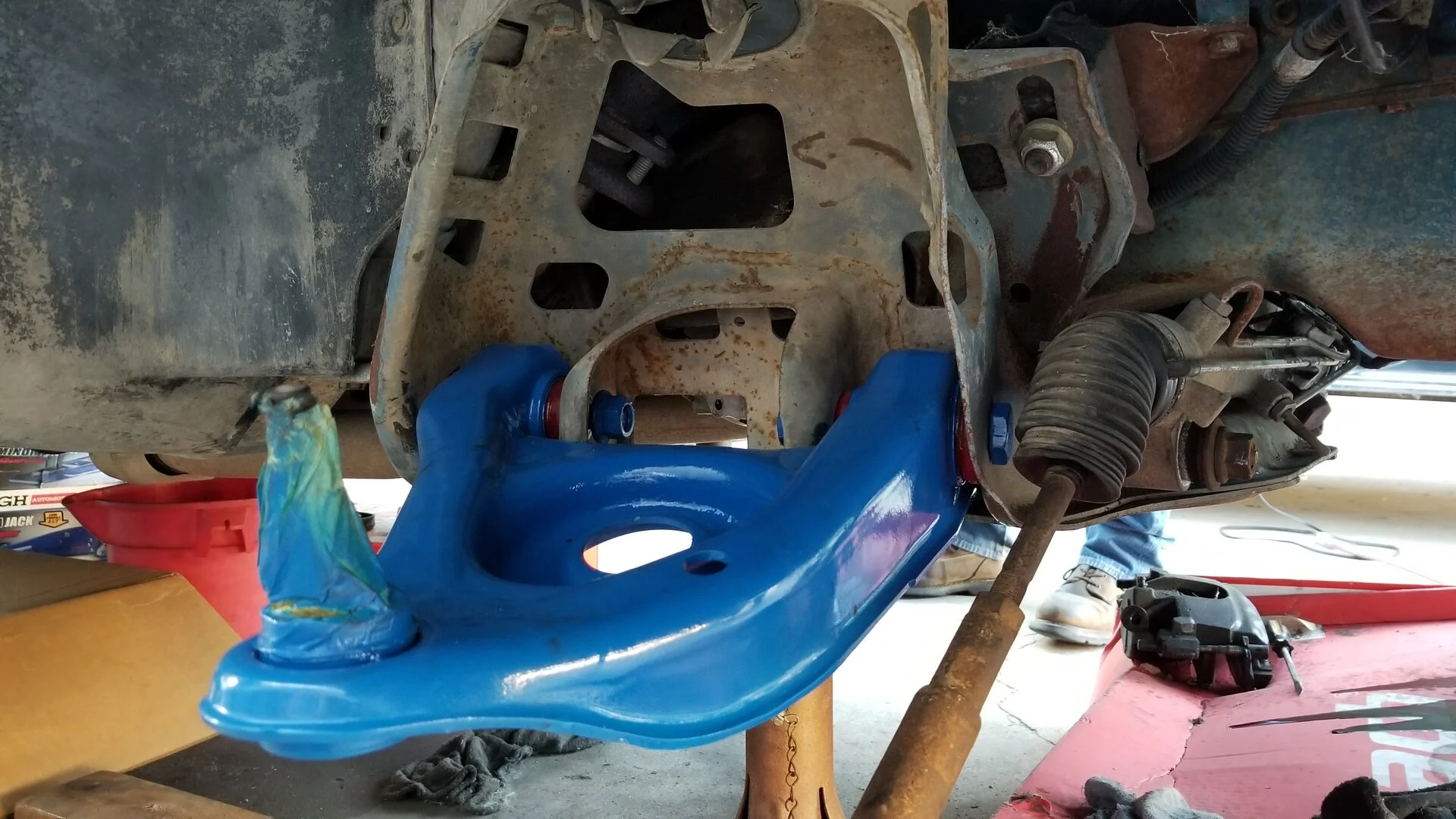

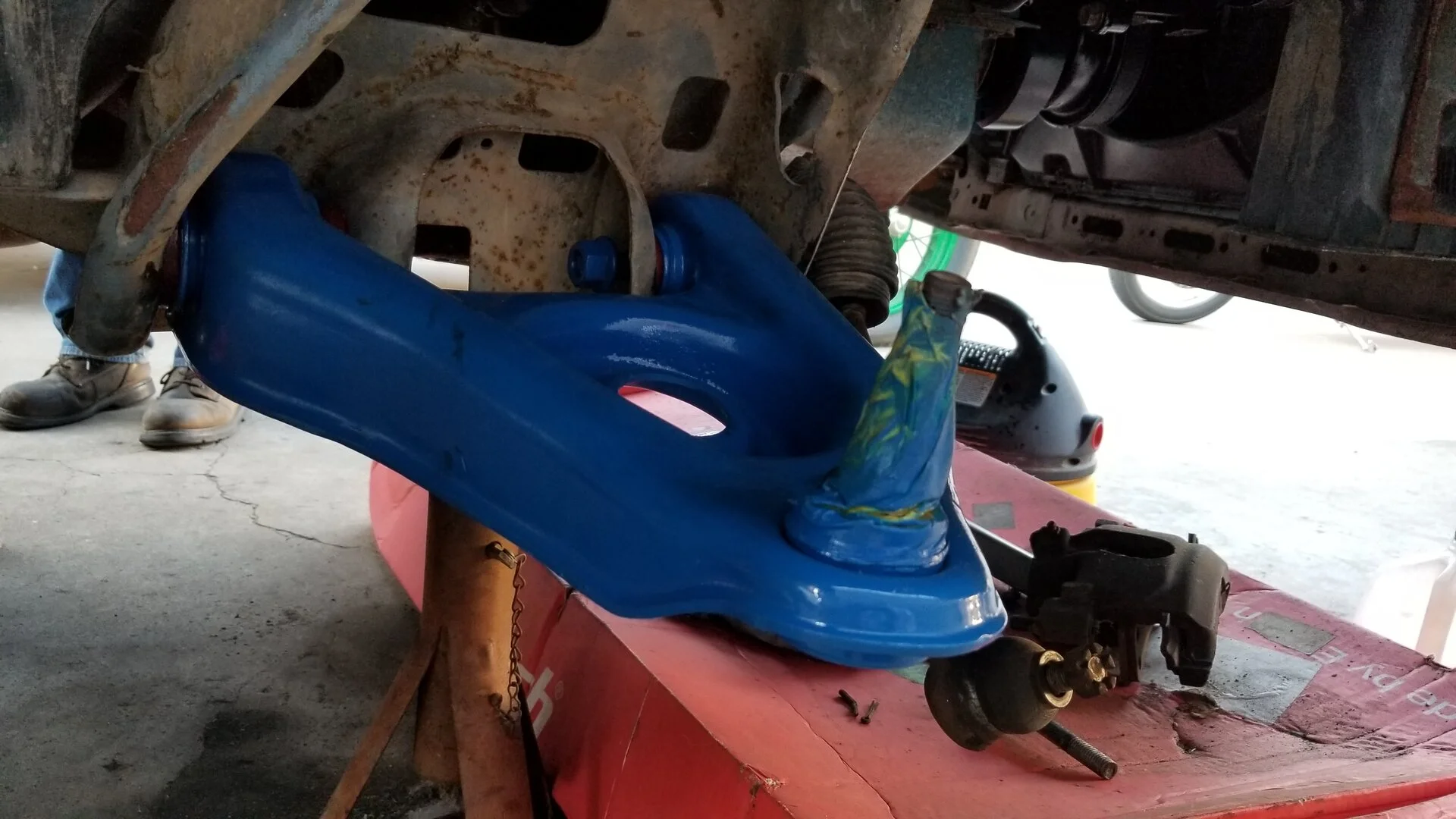

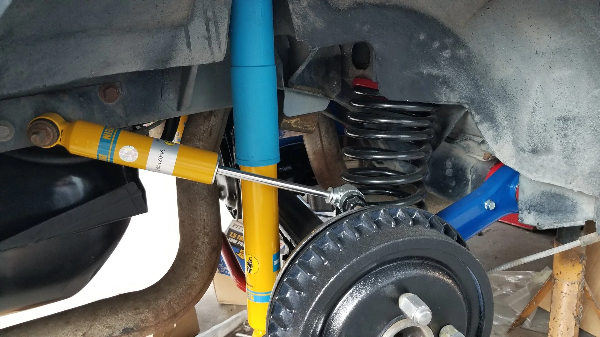

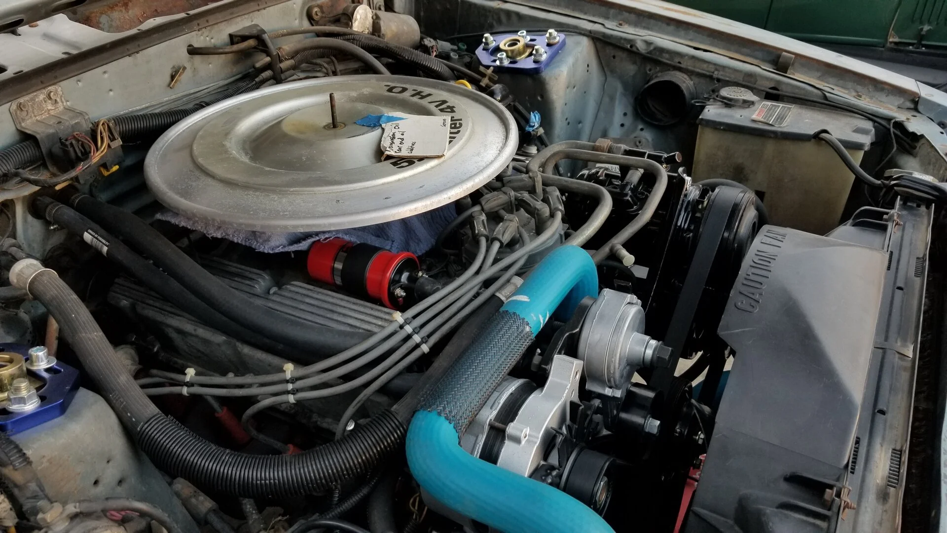

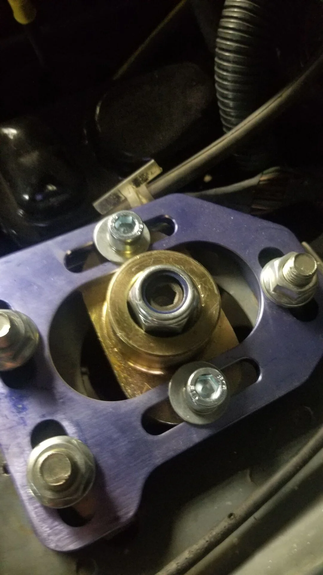

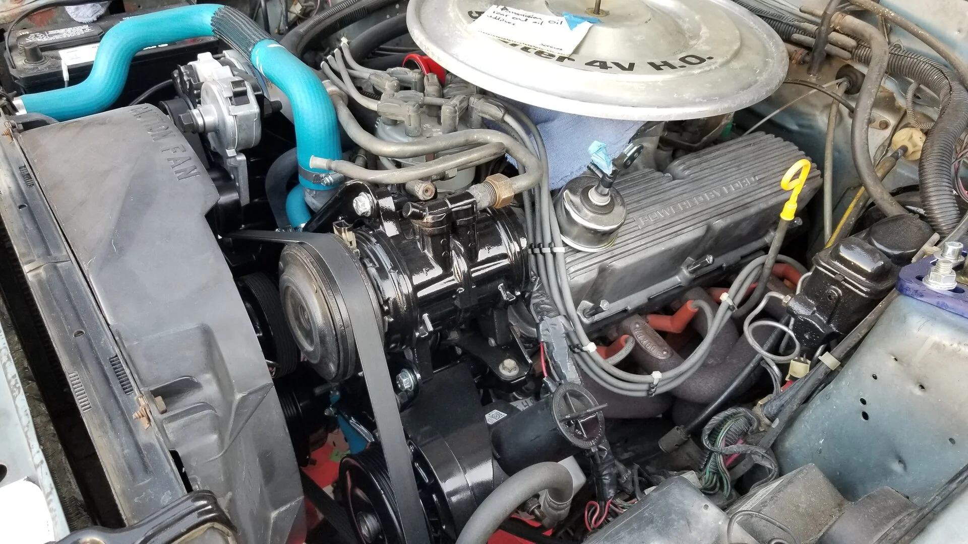

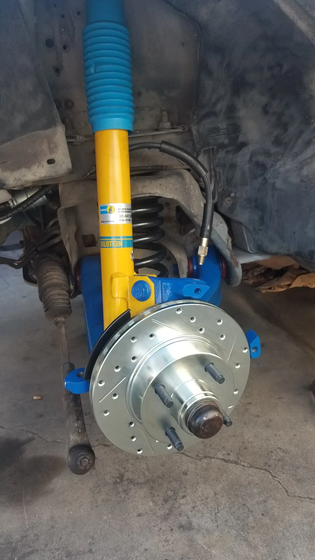

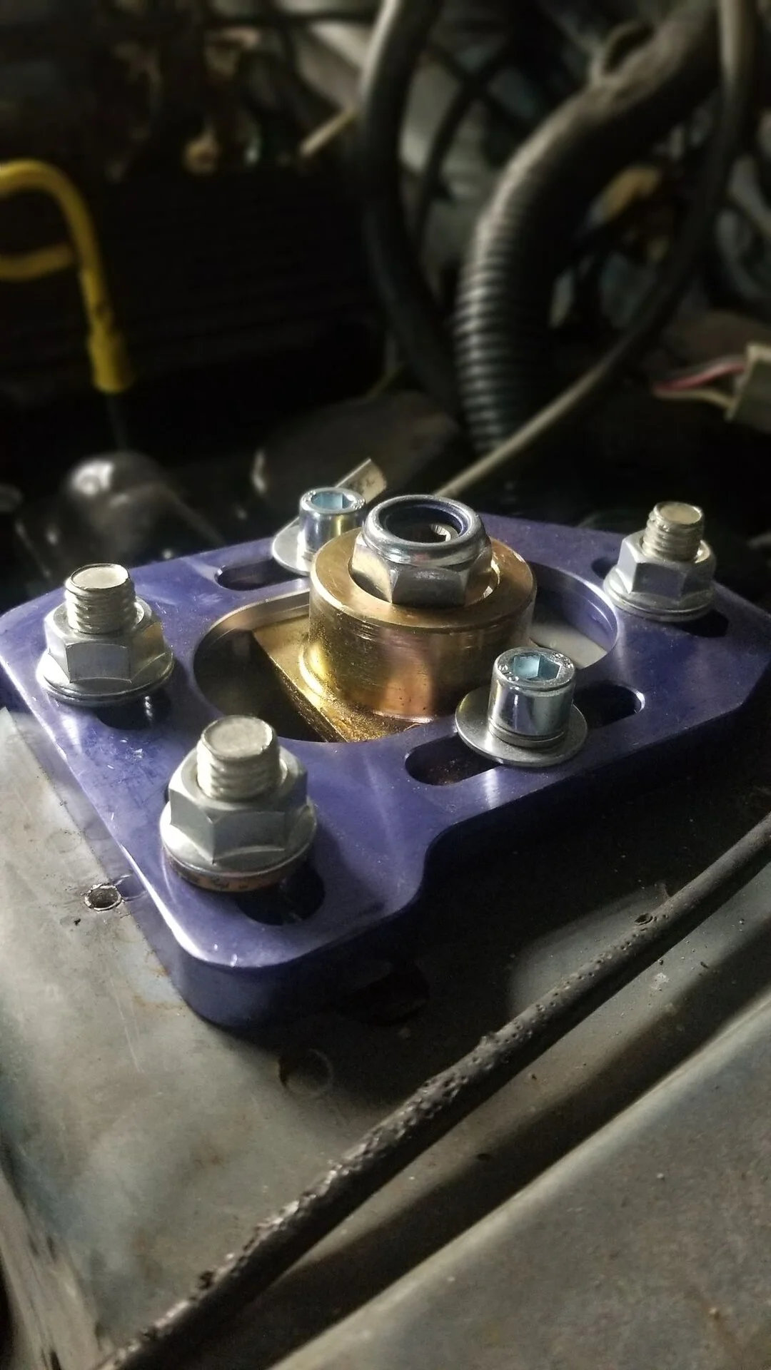

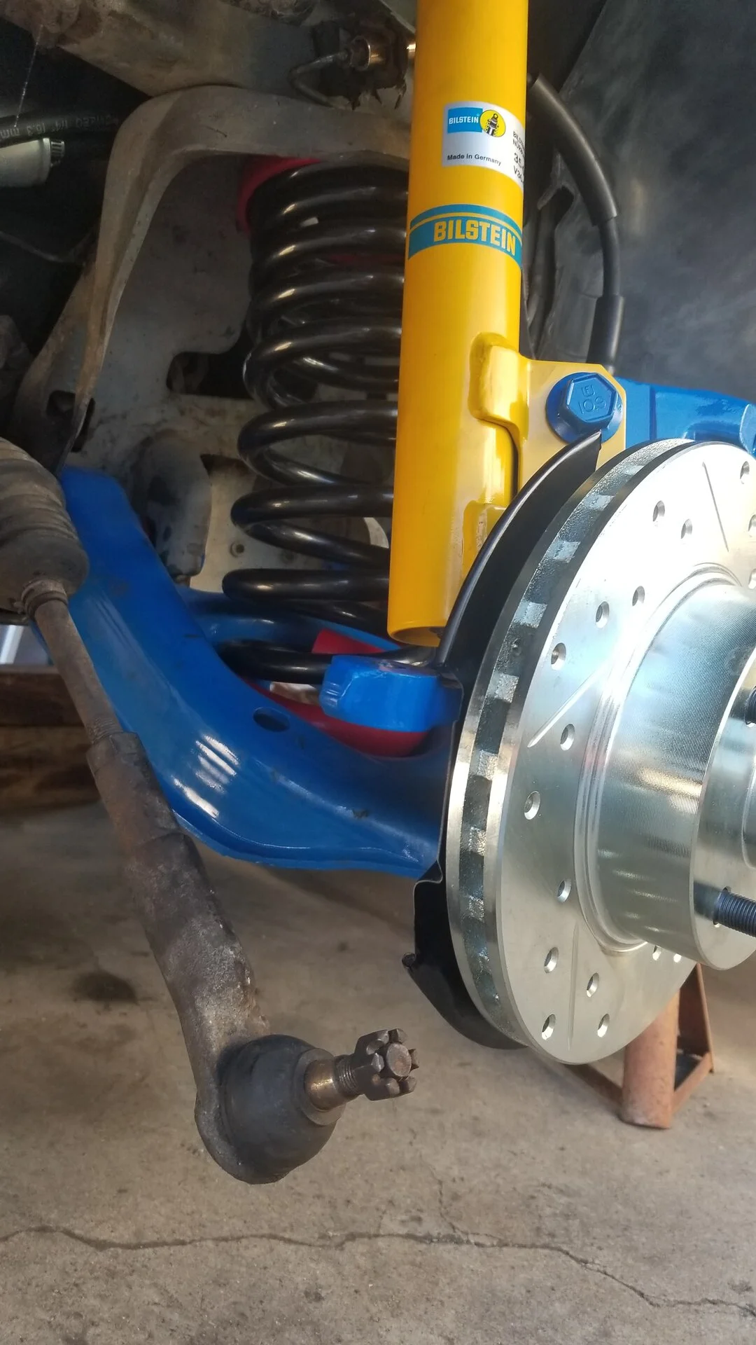

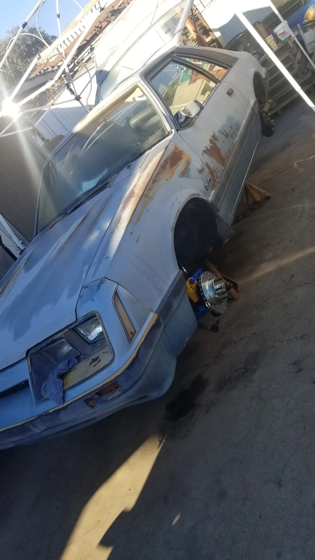

Alright guys, finally after so long I can say the car is almost back on the road! Got the 87 struts mounted to the 85 spindles and on the car, new calipers, rotors, brake lines, and the springs in. Ended up manual milling the spindles down to the correct size to fit the 87 struts, and had to bore one of the mounting holes. The holes for the bolts on the struts are two different sizes, one standard and one metric which has me wondering why they do that. Anyways I have been trying to locate the center rear-end brake line that splits the main brake line to the lines coming from the slave cylinders and after around 3 visits to my local parts store and a couple of hours each visit we managed to find one that fits.
There is a ticking coming from one of the valve covers, it does not sound like an exhaust leak either, I am assuming it's a stuck/sticky lifter. Going to pull it off today and go in for a closer look. After I sort that, she should be ready for the streets. :stir::lol::bs:
Here are some pictures to hold you guys over until it's back on the ground.
