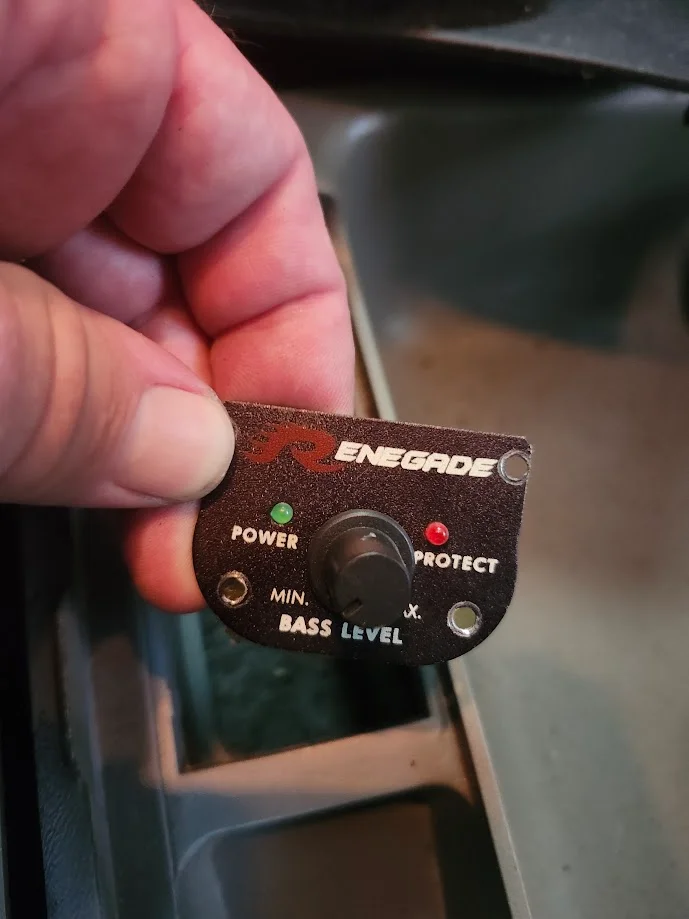

I wondered why the ashtray wouldn't open, and found this bass control knob and a USB input cable blocking it.
Apparently, there was an amp and/or sub in the trunk that is now gone.

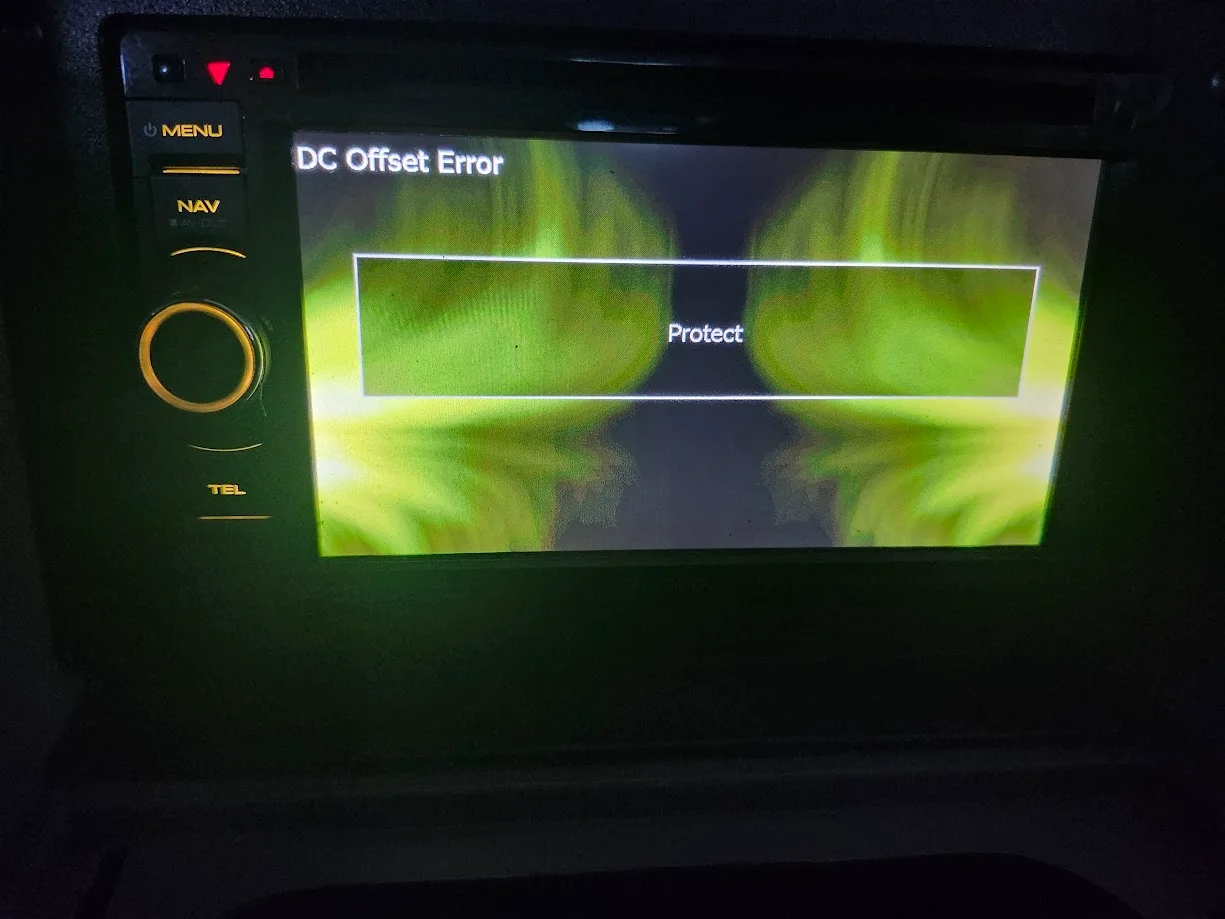

The head unit is ...well, WAS ... a nice Kenwood Bluetooth/Garmin GPS unit with a backup camera. That's probably what the USB port is for. Unfortunately, it's in protect mode with a "DC offset" error. Probably because all of the stuff in the trunk area is now gone.
At this point, I'm thinking I'll keep whatever speakers are in there and replace the head unit. I'll talk to the stereo shop about options. I really don't want a trunk full of amps and subs, though.

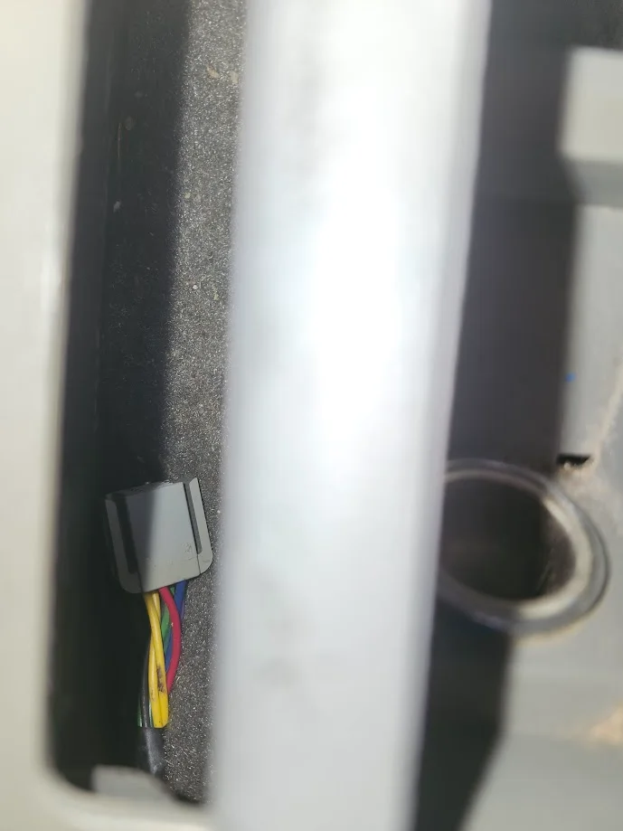

I also found this connector on the tunnel, under the ashtray/console. What is this for?
OK, it looks like this is the power window plug, which would explain why the mirrors don't work!
I never trust a P.O. It could have just been an oversight, or the switch could be bad. I have to remove the console to remove the switch. Is there a way to test the switch?
If you are talking about the PMS on the console, there are tabs on the sides, thin flat blade screwdriver, push under the lip towards the middle of the switch, there are two tabs opposite each other, don't pry up, push in, it will kinda pop out one side at a time,

I just pulled the console. I wanted to see what was going on under there with the stereo wires and get a little better access to the shifter boot anyway.
I plugged the switch in and it's giving me the common symptoms of a bad switch: only goes up and out.
I pulled the instructions for testing the plug from the forum and will do that before ordering a new switch. I'll try cleaning and retesting mine, too.

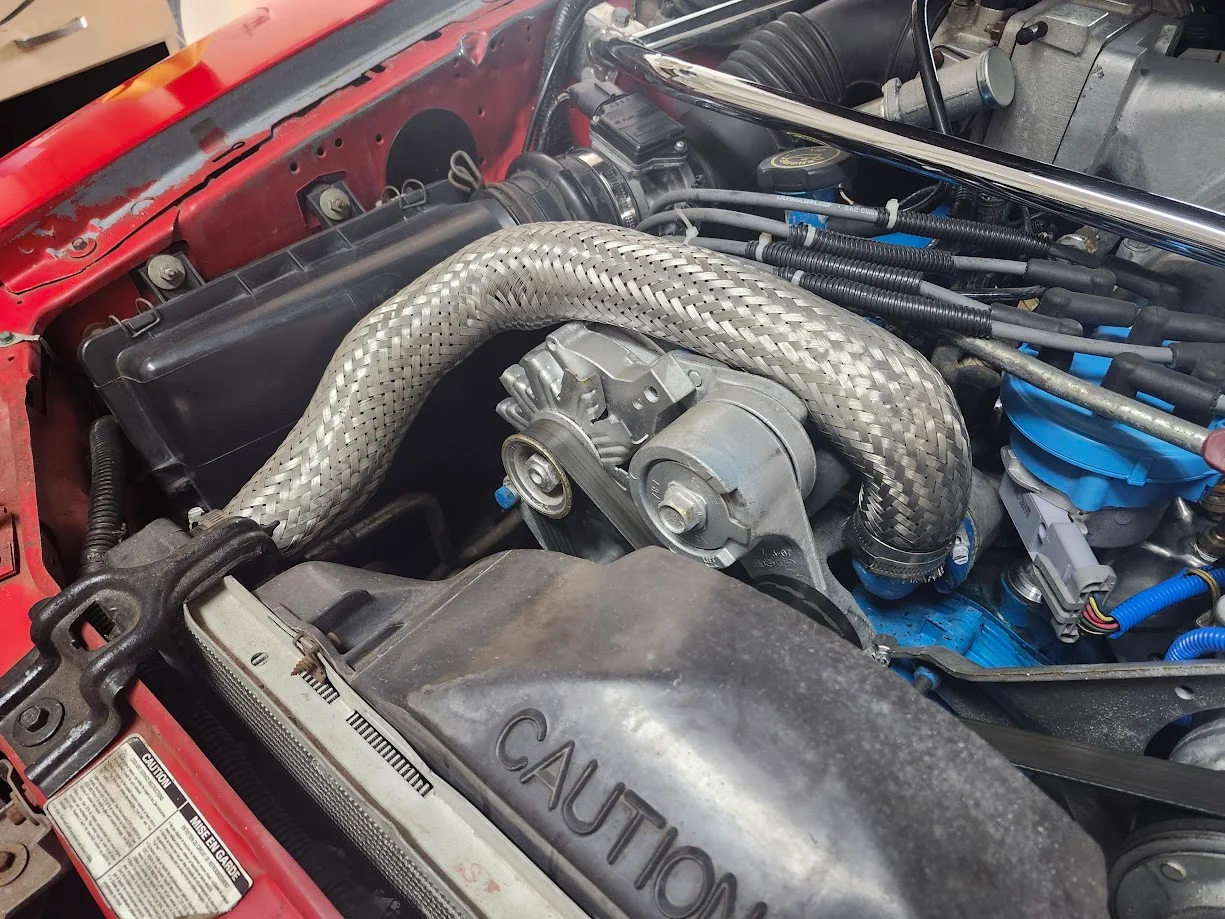

Dumb newbie question: On a cold engine, how much coolant is in the upper radiator hose?
I'm not the biggest fan of the braided hose covering and would like to remove it. Am I gonna make a horrible mess if I unhook the hose?
Basically yes that will make a big mess and antifreeze is toxic to humans and animals, humans (should) be smart enough not to taste it but animals seem to like it at least for a minute, I would drain the fluid from the radiator till the level in the radiator is below the hose level like about a gallon or so.
It's still gonna make a mess. Just smaller. By a lot.

Well, I'm going to be changing all the fluids anyway (oil, brake fluid, etc.). The coolant looks new-ish. I was gonna have the shop test it and leave it alone if it was OK. Maybe I'll just have it changed and remove the covers at that time.
