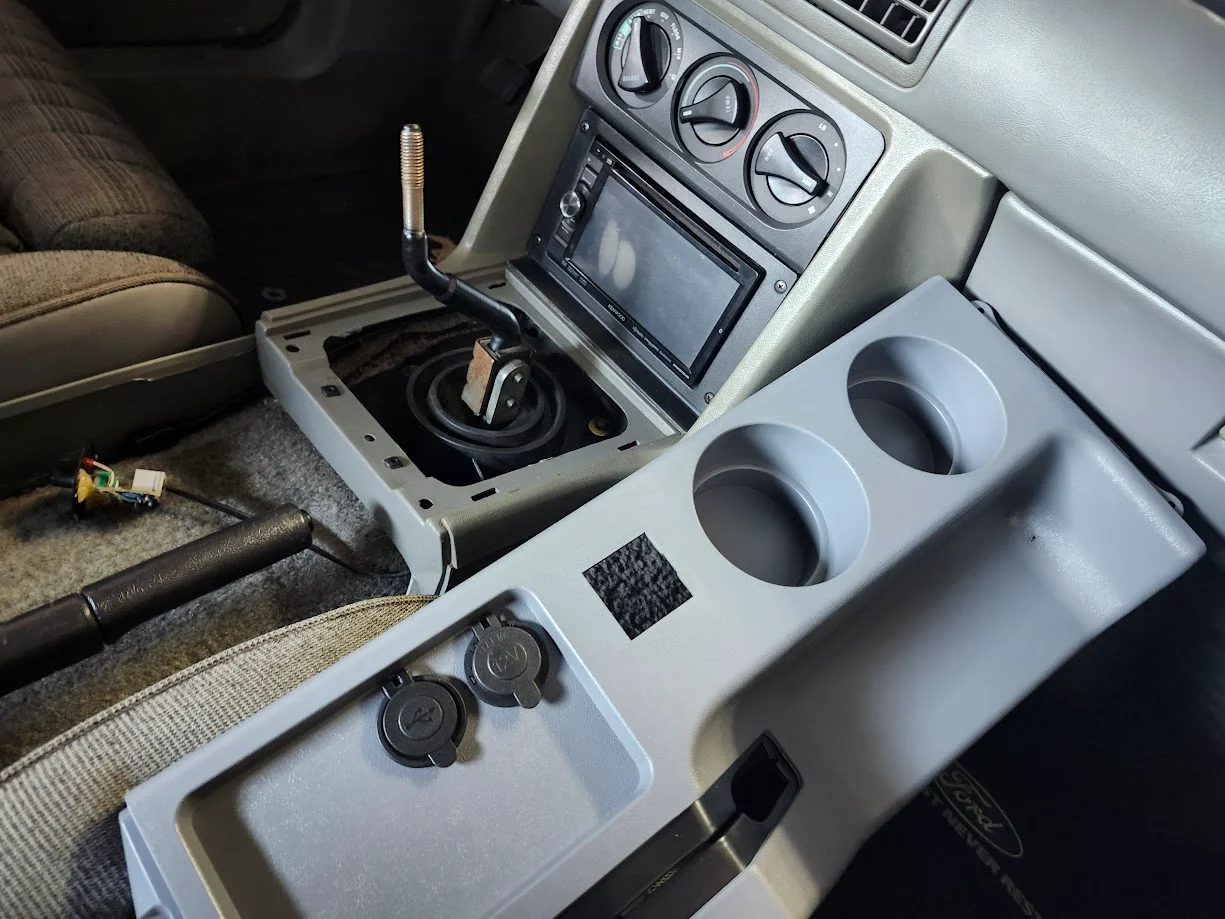

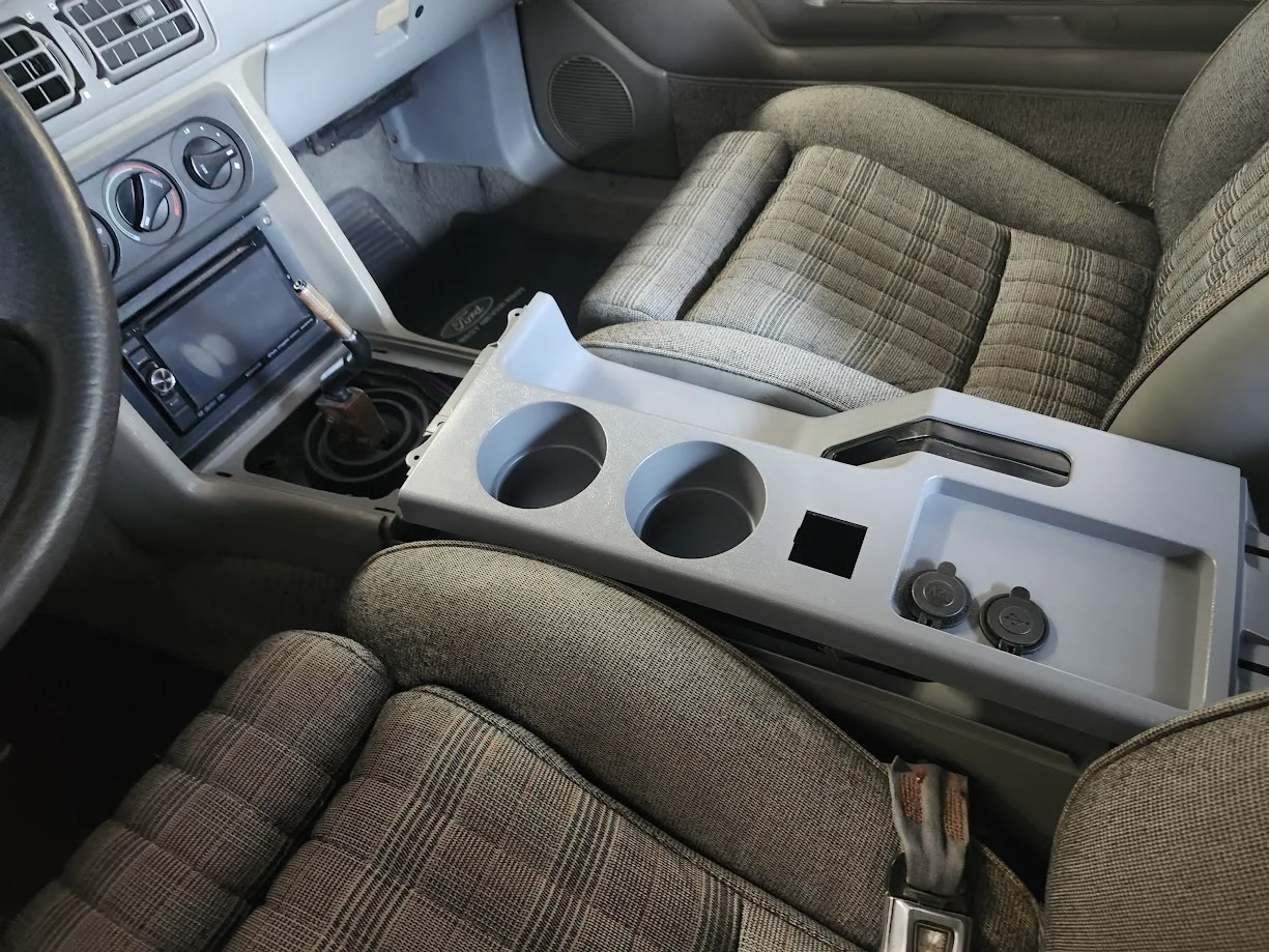

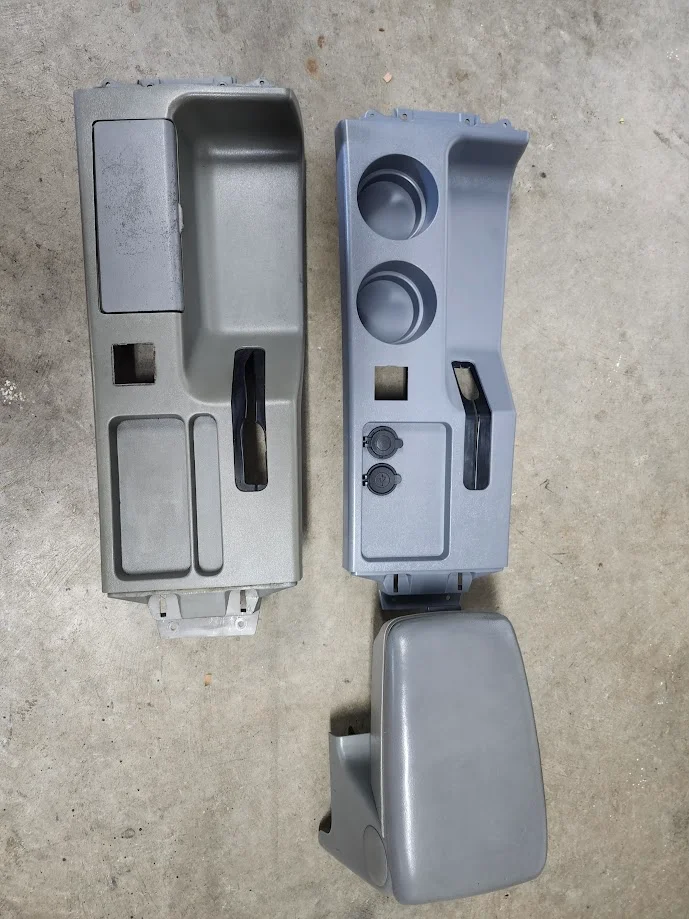

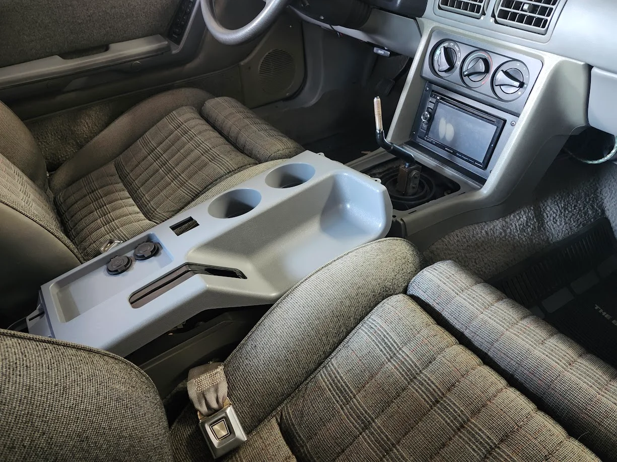

Live with it, or paint it?
I ordered the cup holder console and the gray is lighter. Should I order the Smoke Gray interior paint and color match it? Or, just live with it?

I’m in the same situation. Just living with it for now. I’ll eventually paint the entire interior. Haven’t tried to ‘match’ the center console because I just doubt it’ll match perfectly so might as well do the entire interior at once.

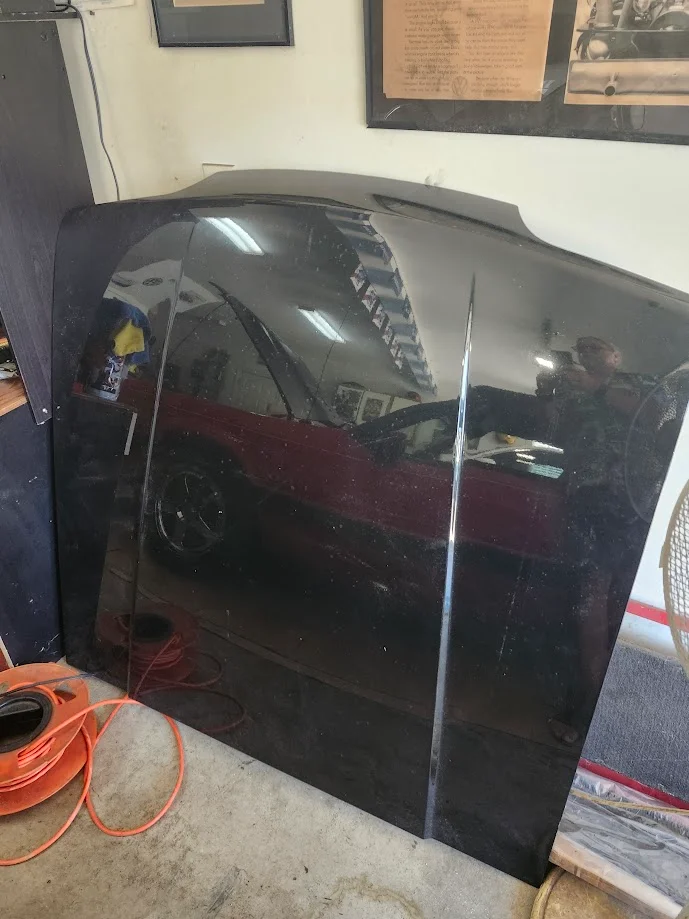

Picked up a SUPER nice stock hood today.

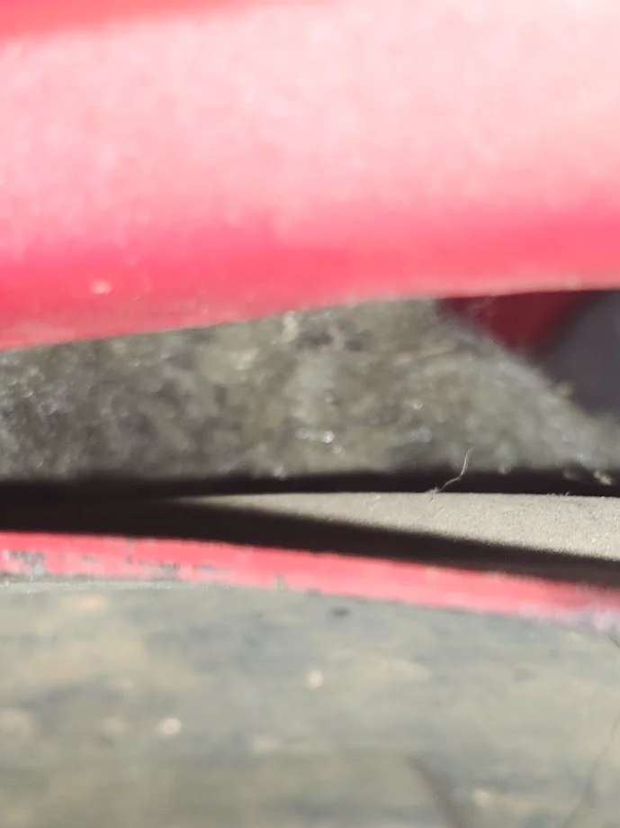

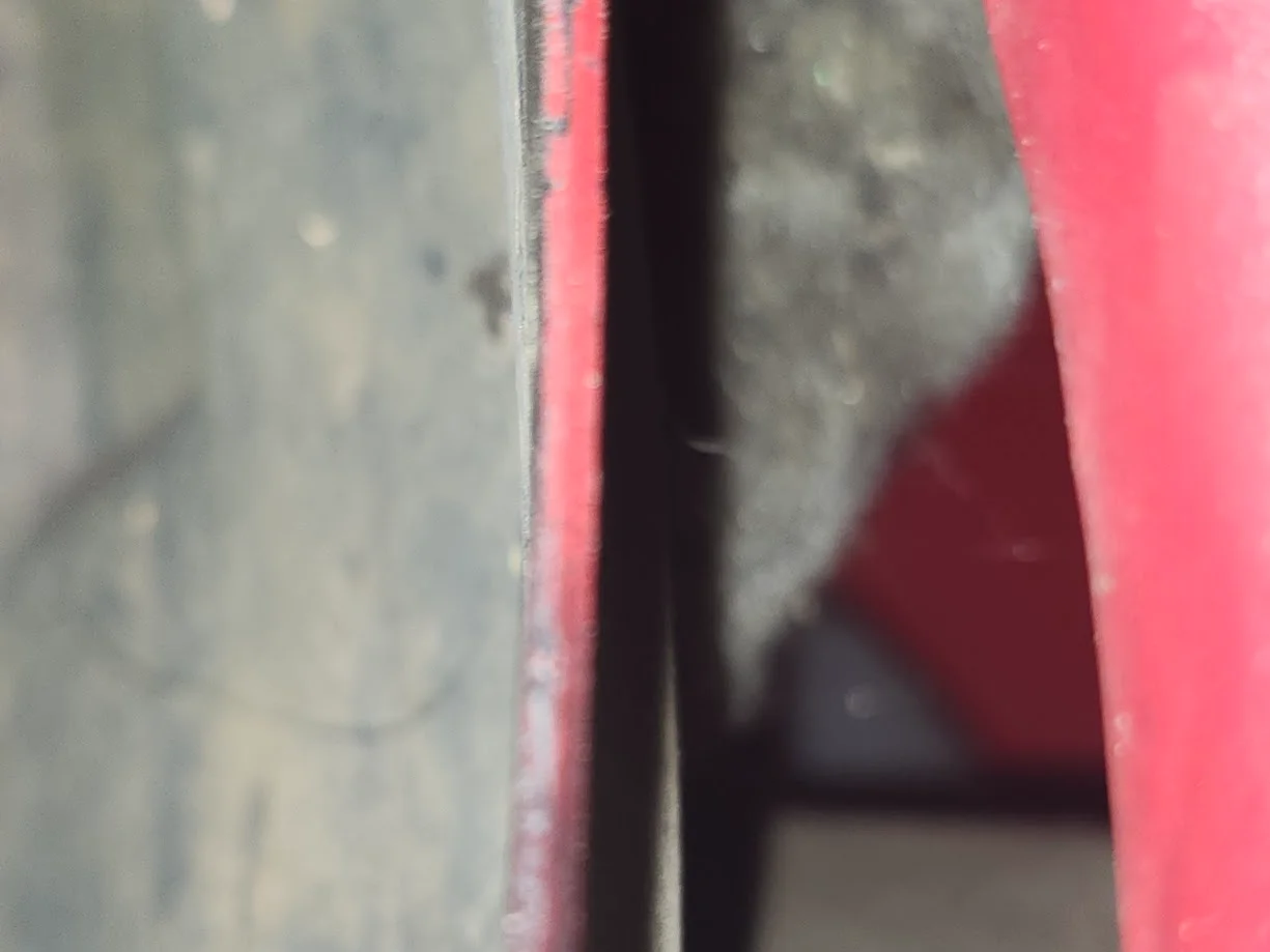

Scott_S said:
The car is far from perfect, with a few dings here and there. And it definitely needs a wash/buff/waxing. I'll probably rock it like this for a while and then get all the dings fixed and the replacement hood painted.
The underside is in great shape. All sills, jack points, floor pans, etc., are like new and not undercoated.
I noticed something in the passenger wheel well, behind the plastic liner. Is there supposed to be some sort of insulation in there, or have mice made a nest?
Horrible pics, I know, but there's a gray-ish material in there, almost like you'd see under a carpet. Sort of wool-like.
That is supposed to be for sound deadening. I had my new ‘86 GT “rustproofed” within a week of purchase, and they removed all of that stuff. In the long run, probably a good idea, as that stuff holds water.

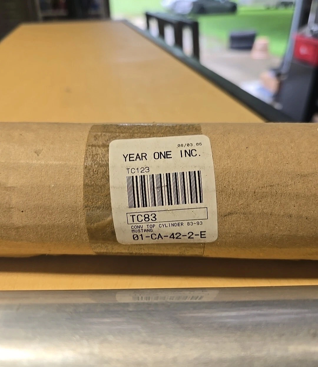

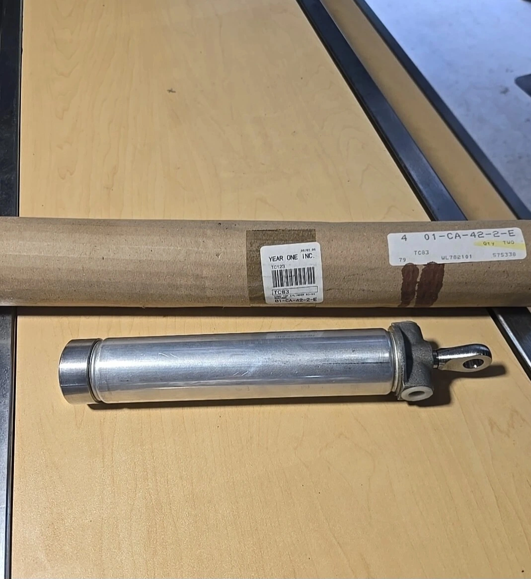

Thoughts on these lift cylinders?
They're NOS, sold by Year One.
I think i read somewhere to look for solid aluminum bodies. Is that crimped on end cap a bad thing?
I can get a pair for what one LMR cylinder costs.

I went with the LMR pistons; a known quality.

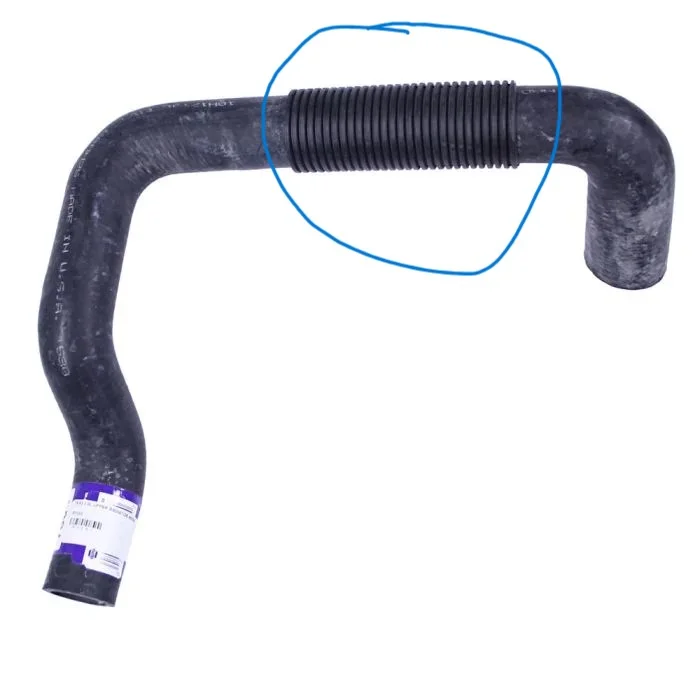

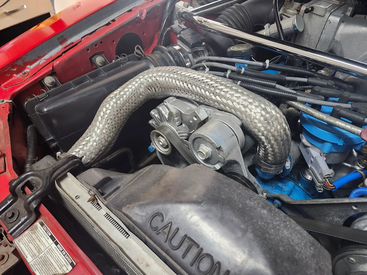

I plan on removing this braided hose cover when I do all the fluids (just not my thing, and this one fits kinda loose).
I'm 99.99% sure the hose underneath does NOT have the ribbed protective covering over the alternator area. How important is that protector? Can it be installed over the hose, or do you have to remove the end of the hose and slide it on?
Lastly, if I need it, where can I get one? I can't find it sold separately. I'm not even sure of the proper name for it.

It has a split down the middle so, you can just put it on over the hose.

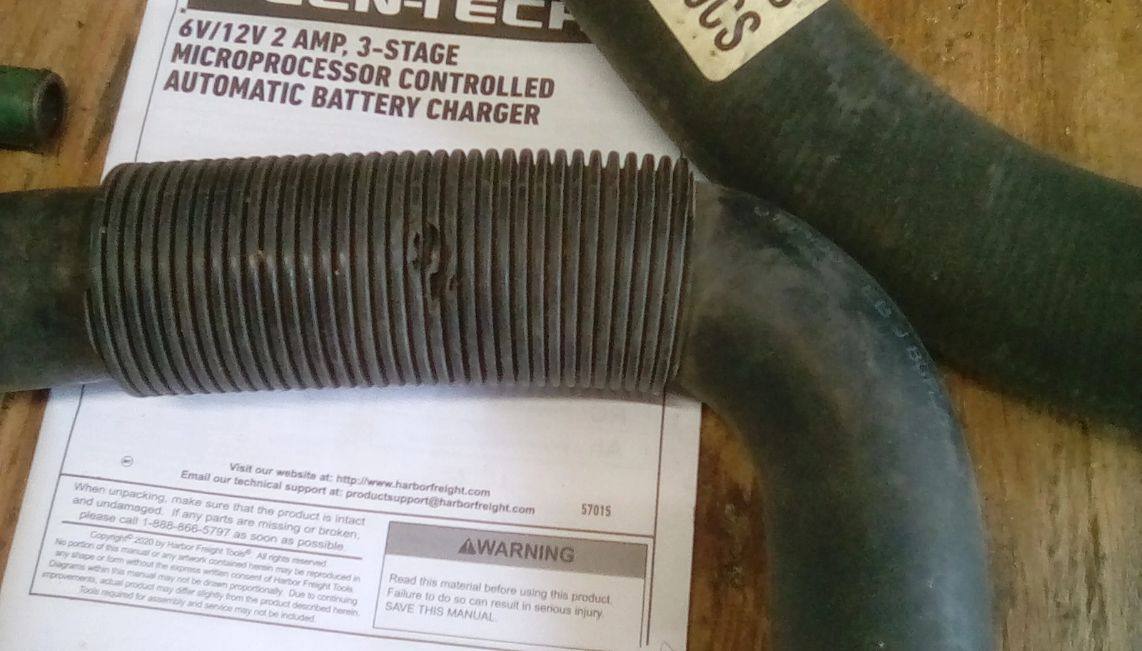

Ok, I found an original factory upper hose with that plastic sleeve, no slot to remove or install, didn't try to remove yet bt got a pic of what happens after a long time on the road,
Prolly could slide it off one end but I ain't do'n that..
The hose is 40mm or right at 1.5" and 4 .5" long but you can make it longer.
